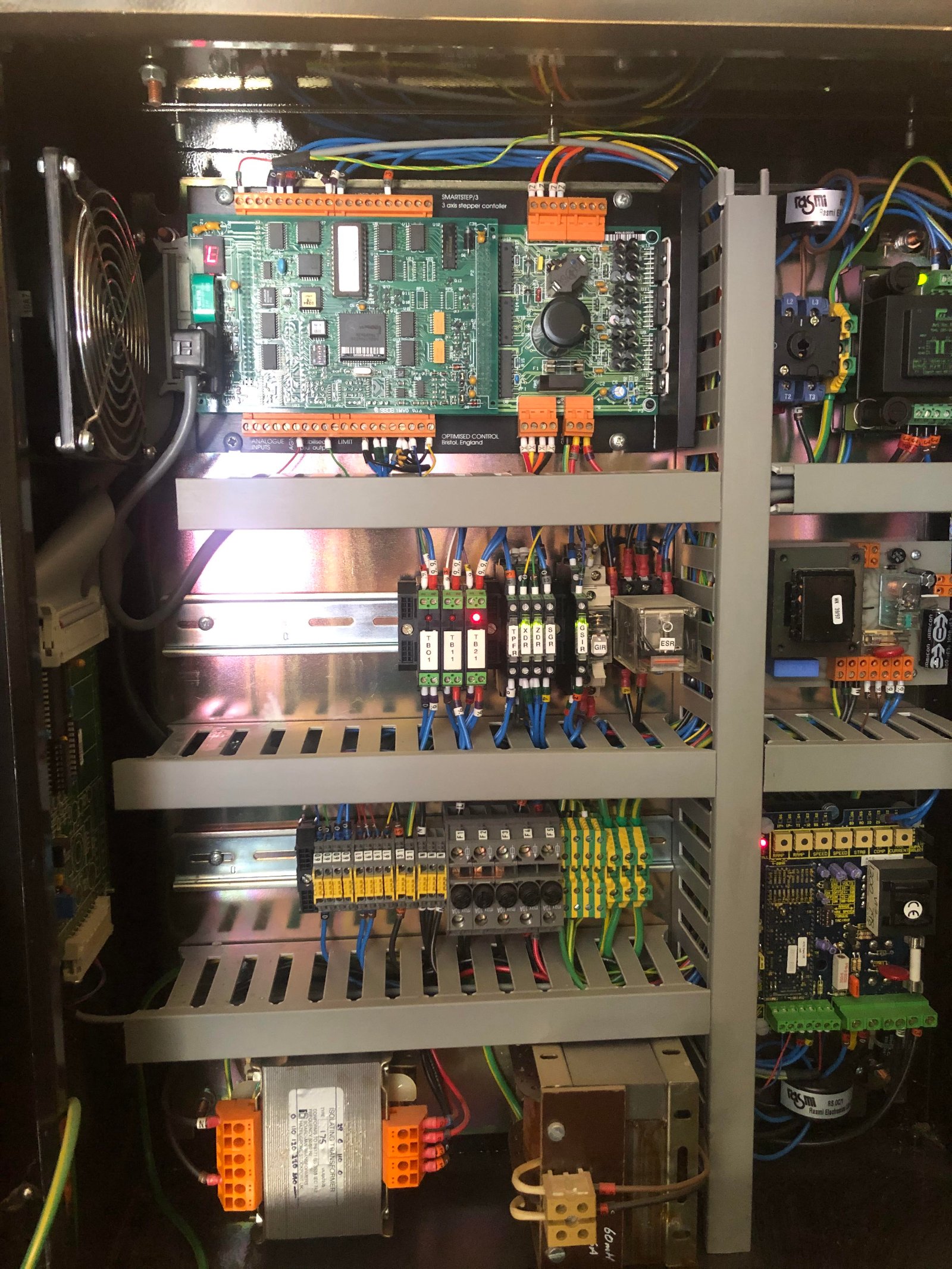

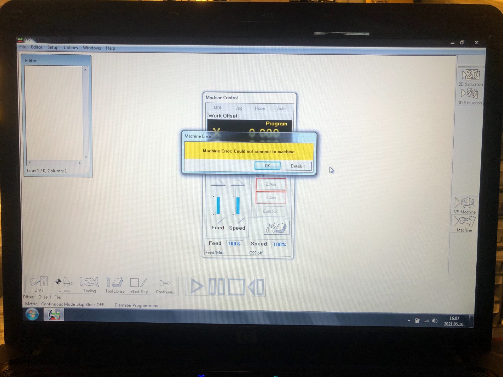

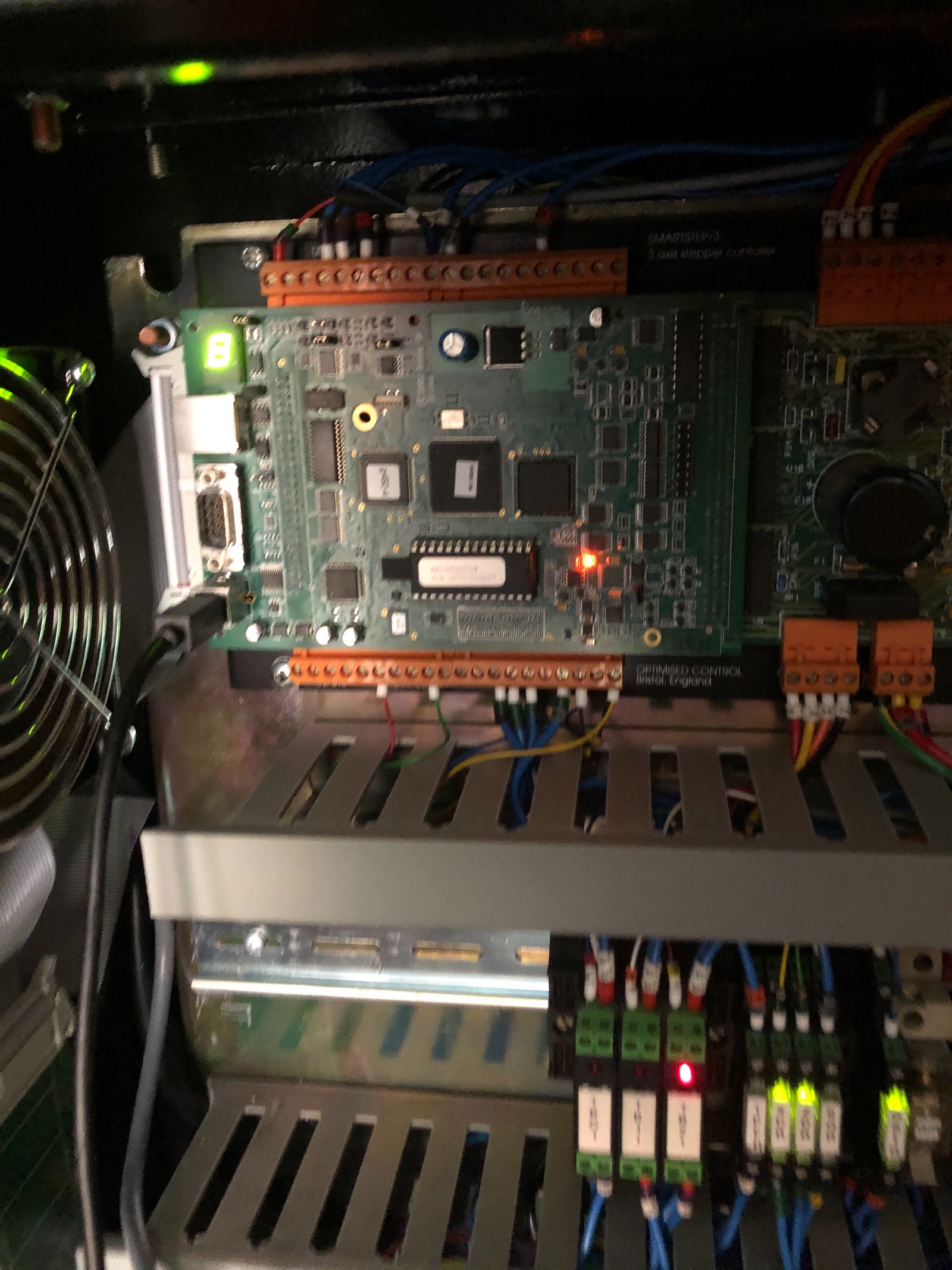

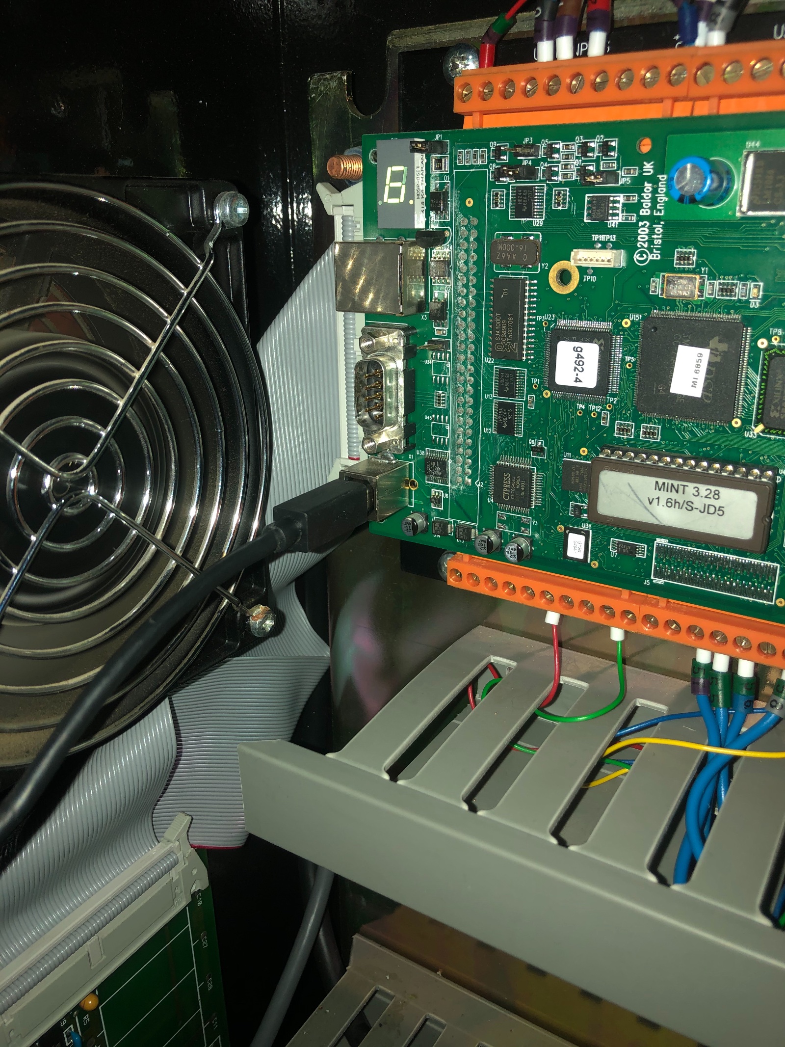

hi! my novaturn lathe not working . somebody help me please . many thanks
-windows7 operation system
-rs 232 cable ( working fine with another denford machine )
-VR 1.53 turning with licence key installed.

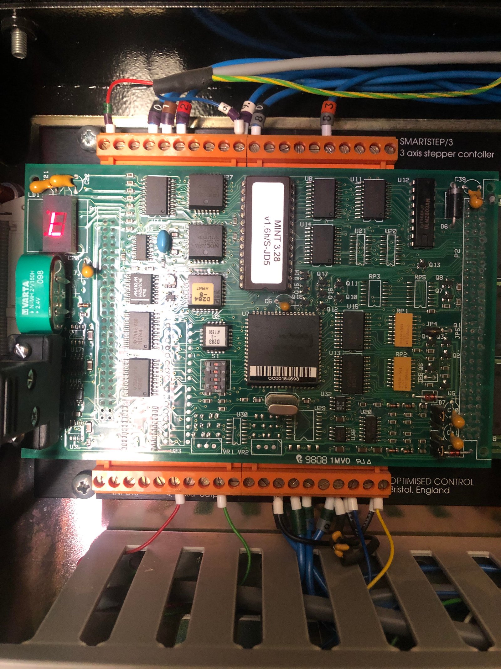

i don,t know nothing about the Eprom chip ,but i think maybe this will be the problem,
i try upoad some pictures .
how can i upload any pictures here ?i see many emojies but the picture upload not found it.

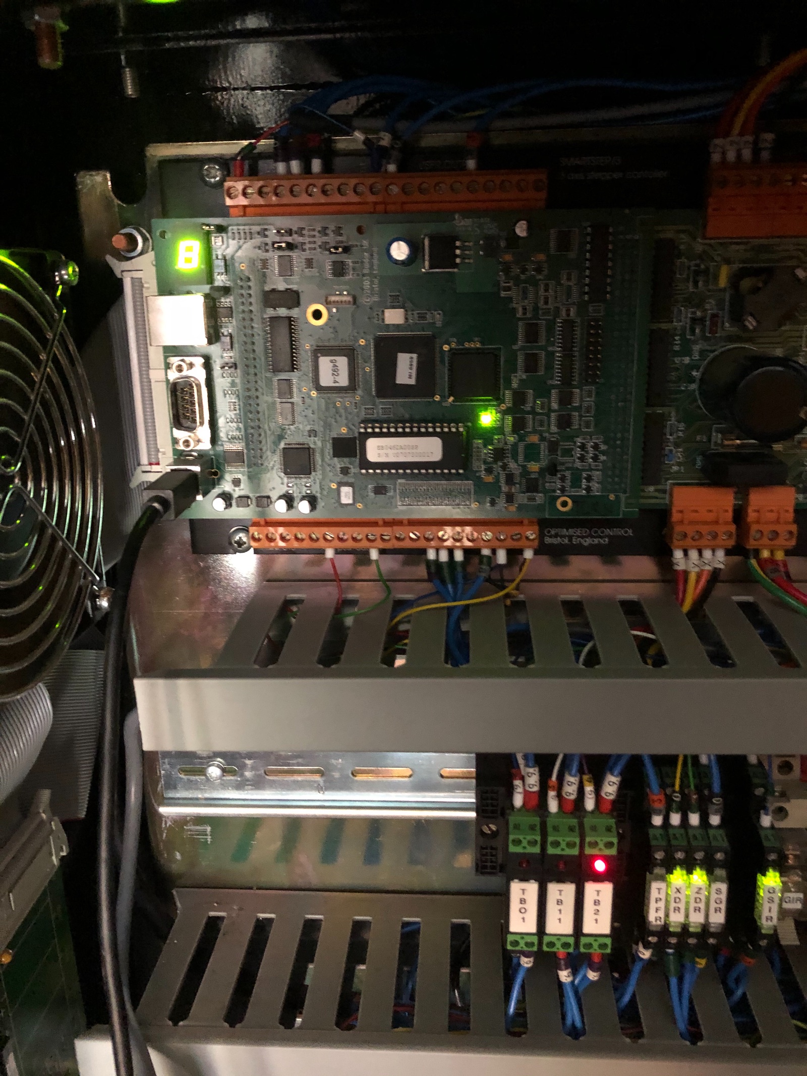

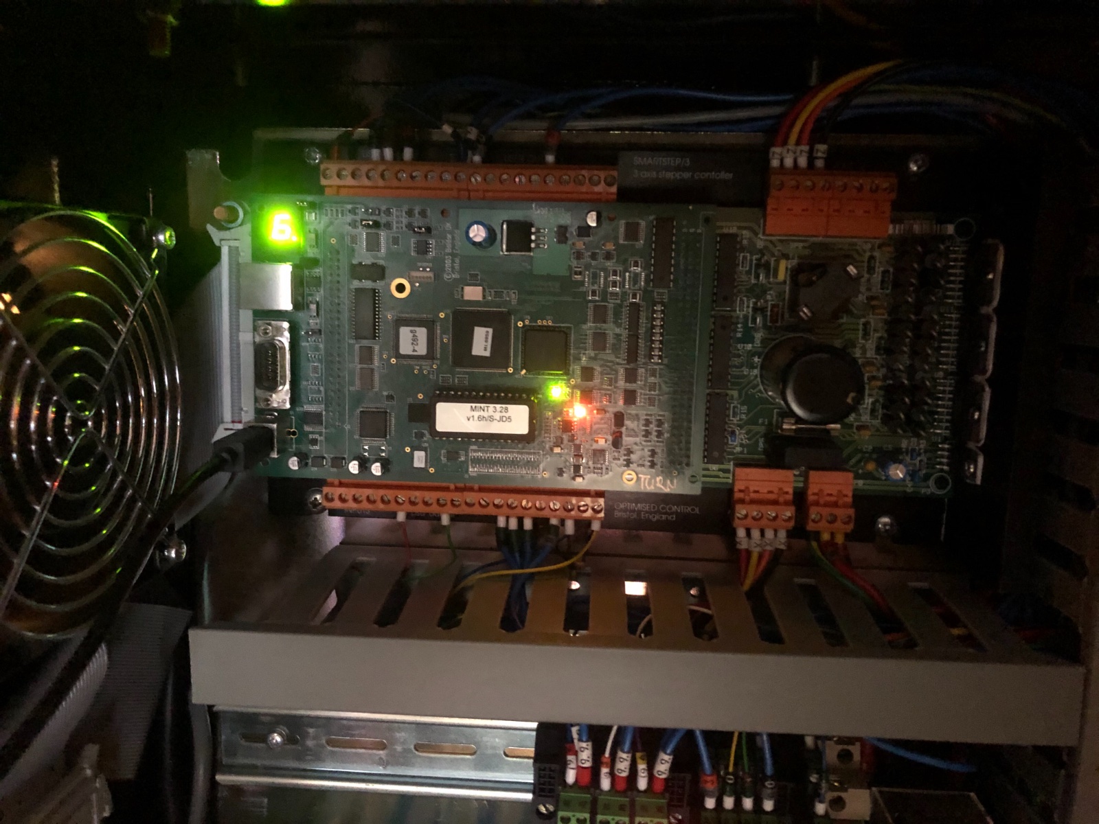

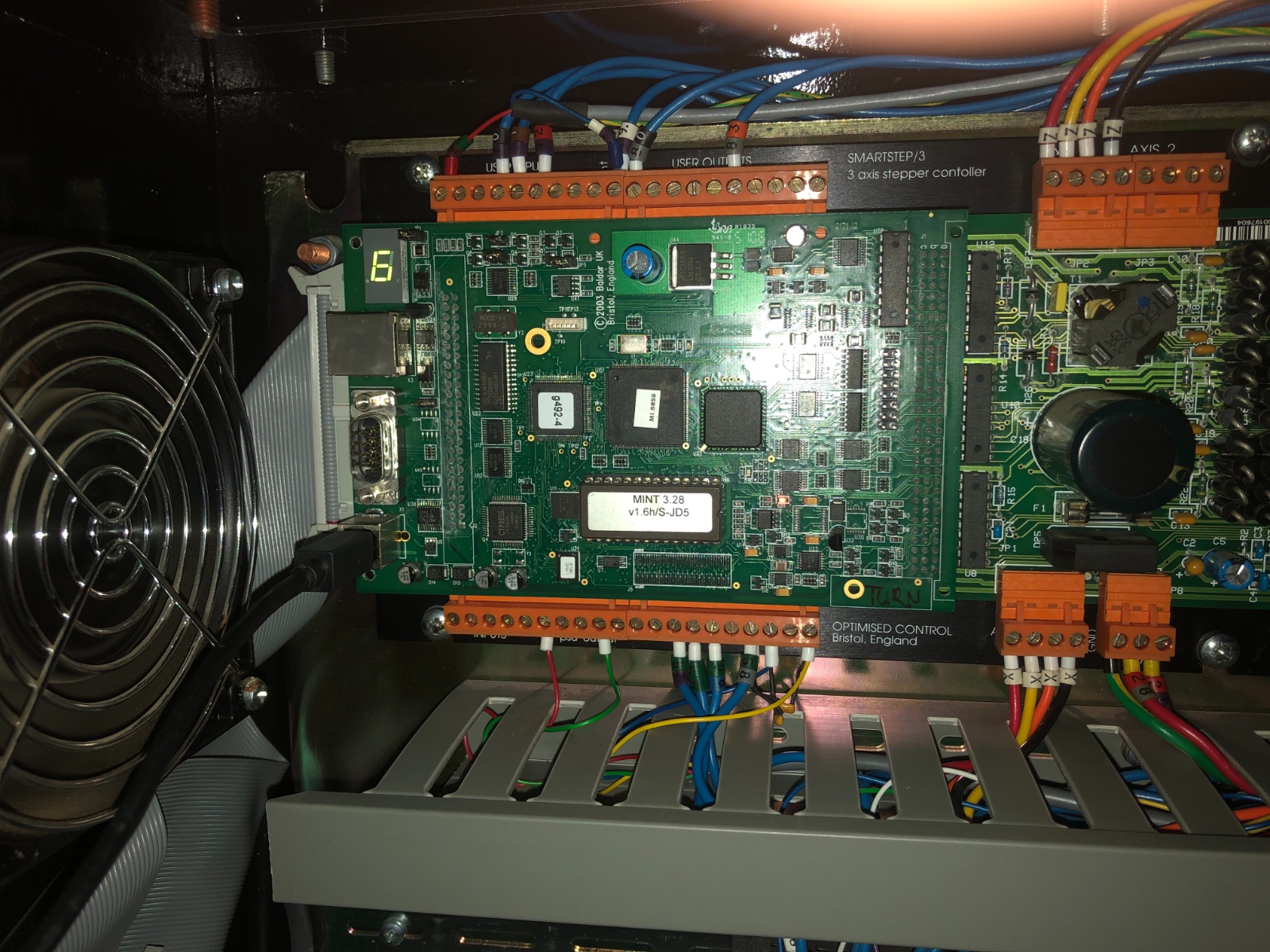

-on my Eprom chip - MINT 3.28 marked
v1 6h/S-JD5

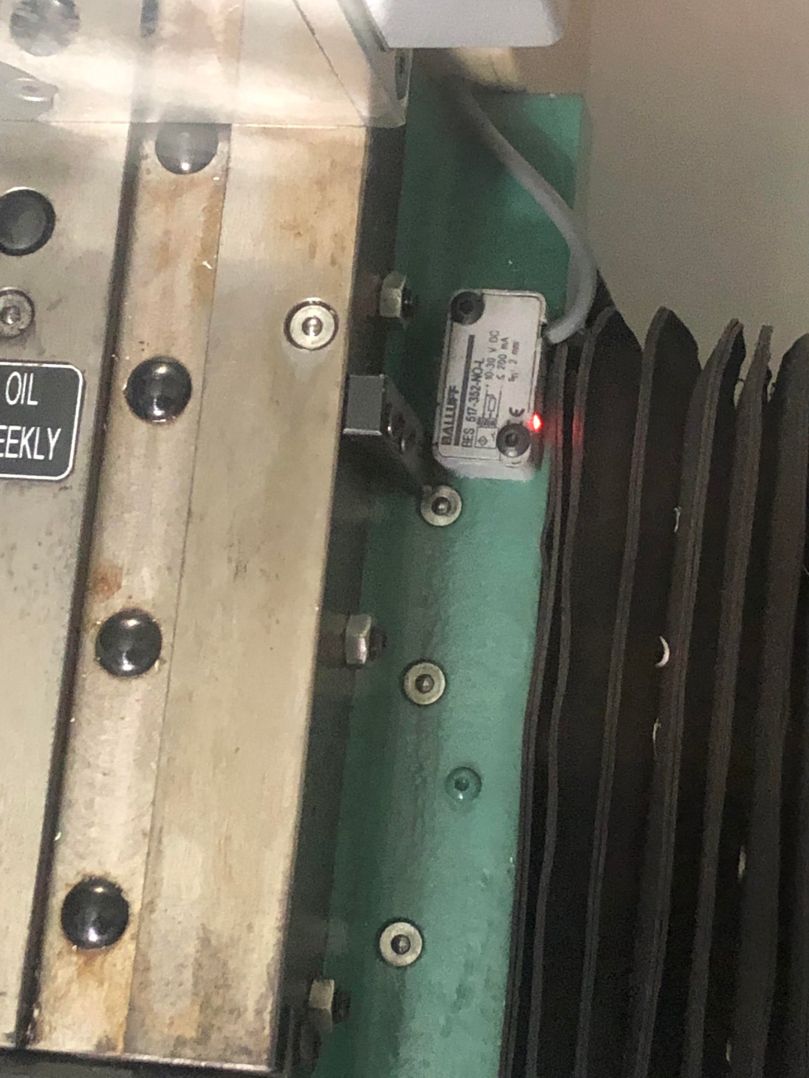

-the seven segment show red capital L with flashing dot

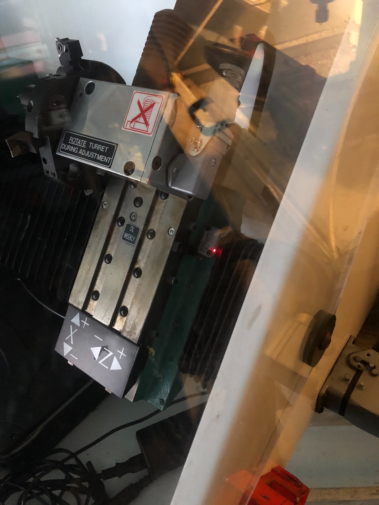

- the X axis slide sensor red ( i don,t know that is normall or not? ) thanks again.
v1 6h/S-JD5

As no one else has responded yet I thought I would ask if this is a system you have had running in the past and has now stopped working or if you're trying to get it working for the first time. This thread viewtopic.php?f=54&t=3167 mentions 'L' likely being a issue with loading the mint file so maybe a comms issue. To attach images use the facilities at the bottom of the posting page.

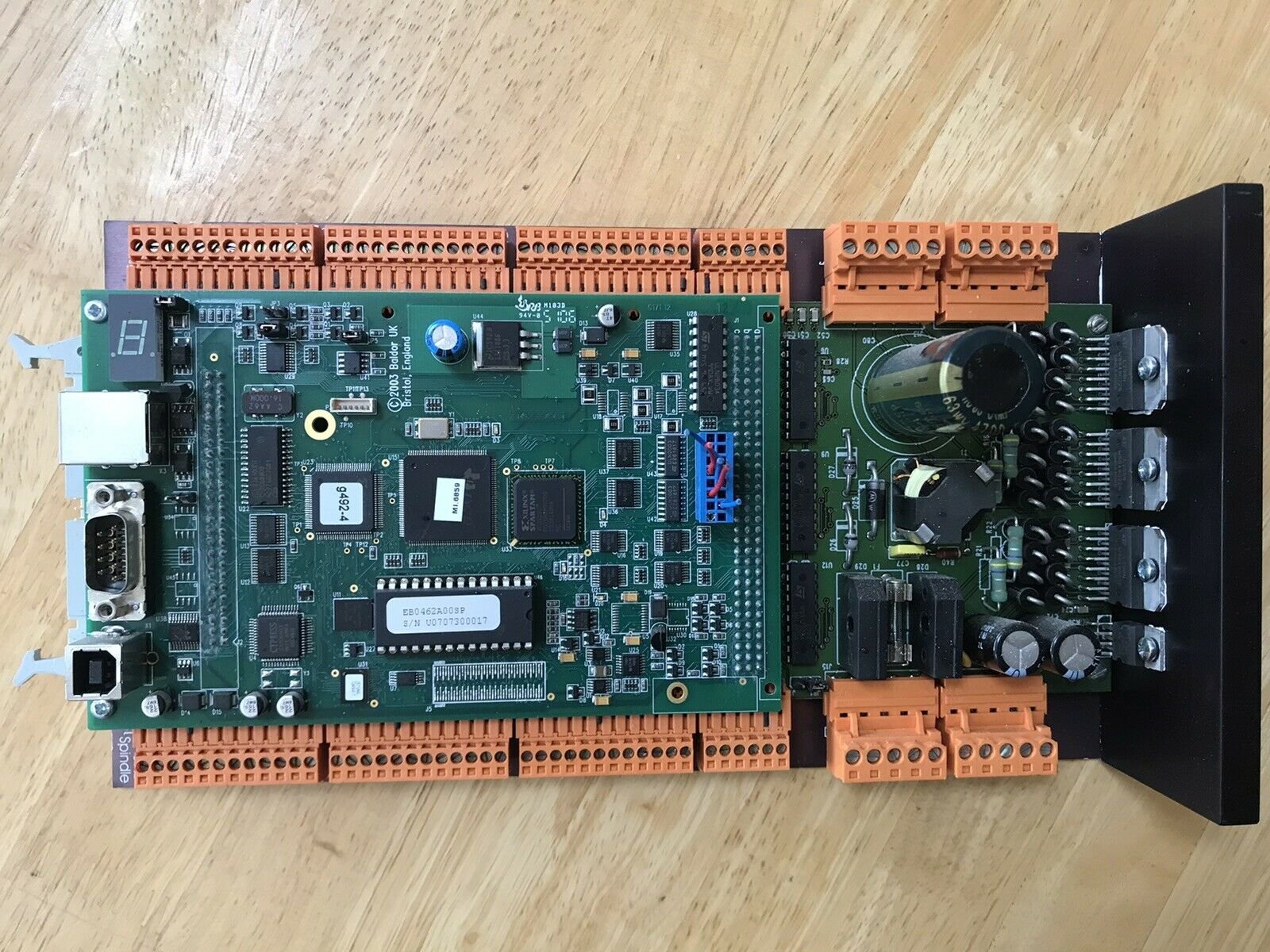

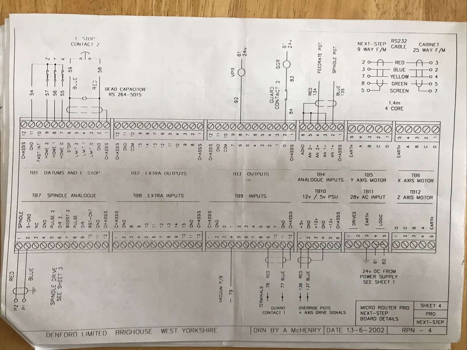

i try first time .but now start change the control board from smartstep to nextmove st ,
the nextmove st controll board come from microruter .
the last picture show the wiring diagram .
- i was try change the eprom chip to v2,1 but nothing .
- i try select another machine parameters "novaturn NS " nothing

Worth checking first for any deposits around the battery on the Nextmove board as they are prone to leak electrolyte after many years which may effect the comms. If there are deposits they need to be removed with distilled or deionised water and dried. In many of the Denford installations the battery isn't required, I can't say about yours but the answer may be elsewhere on the BB. Make sure you're discharged and ideally use appropriate handling of likely static sensitive devices.
I would try with the EPROM it came with. Some good information here for the Nextmove ST https://www.abbmotion.com/support/suppor ... _01-10.pdf about communication with the board and fault finding and the earlier board https://www.baldor.com/Shared/manuals/1251-396.pdf , at least the RS232 connections are the same although it indicates the default comms parameters differs with the Nextmove using a higher baud rate.

I found one wiring diagram nova turn den step to next step.
but me need smart step to next step wiring diagram .
your next step 80 pages documents very help full and thank you very much.

In order to run VR CNC Turning you will need a VR Eprom version 2.0 or 2.1.

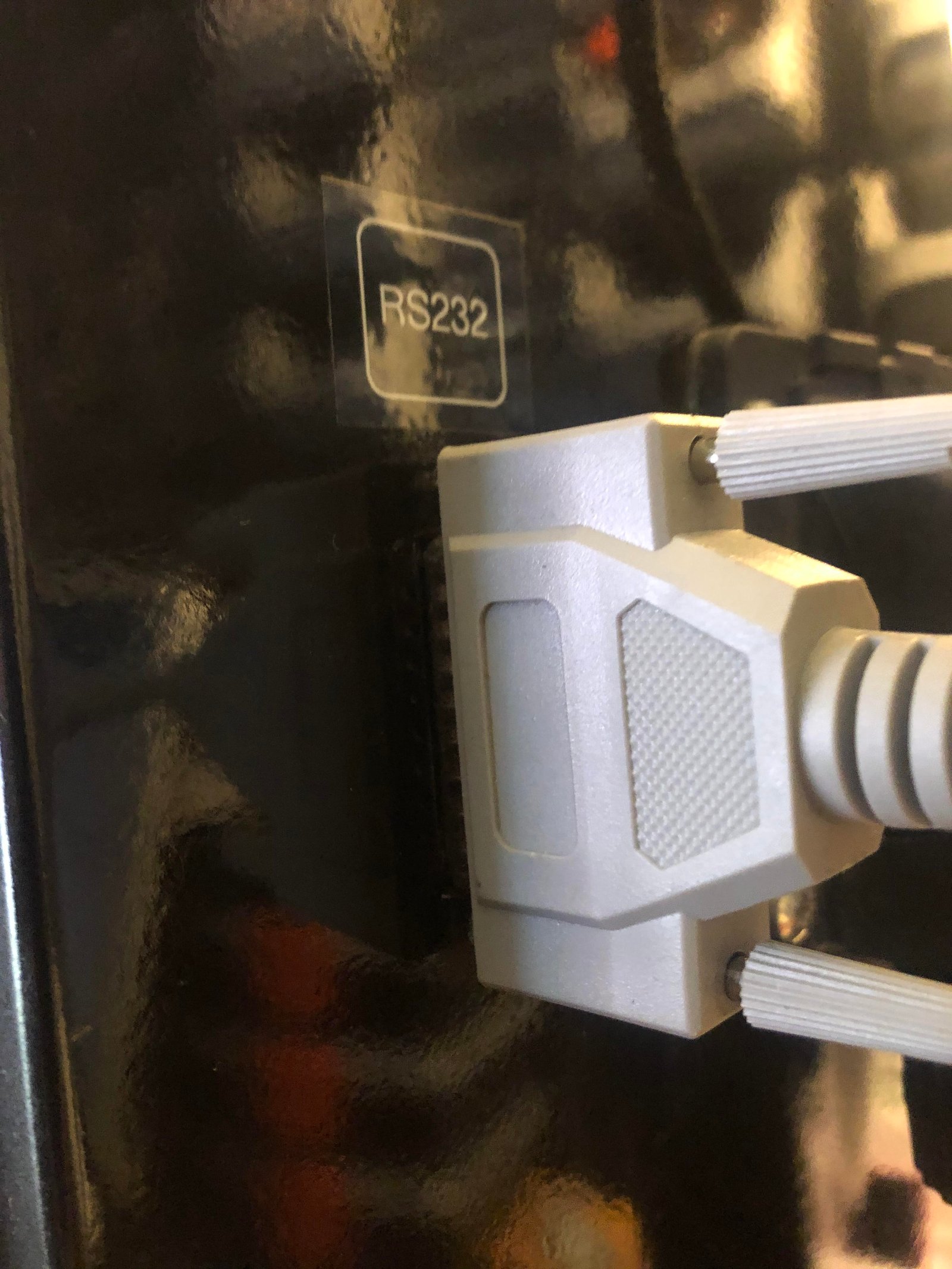

Also I don`t think the RS232 lead you have shown in one of the pictures is correct.

You have a DOS EPROM fitted so cannot Run VR Turning.
Eprom is V1.6h/s
viewtopic.php?f=54&t=5982&p=24656&hilit=eprom#p24656
Eprom is V1.6h/s

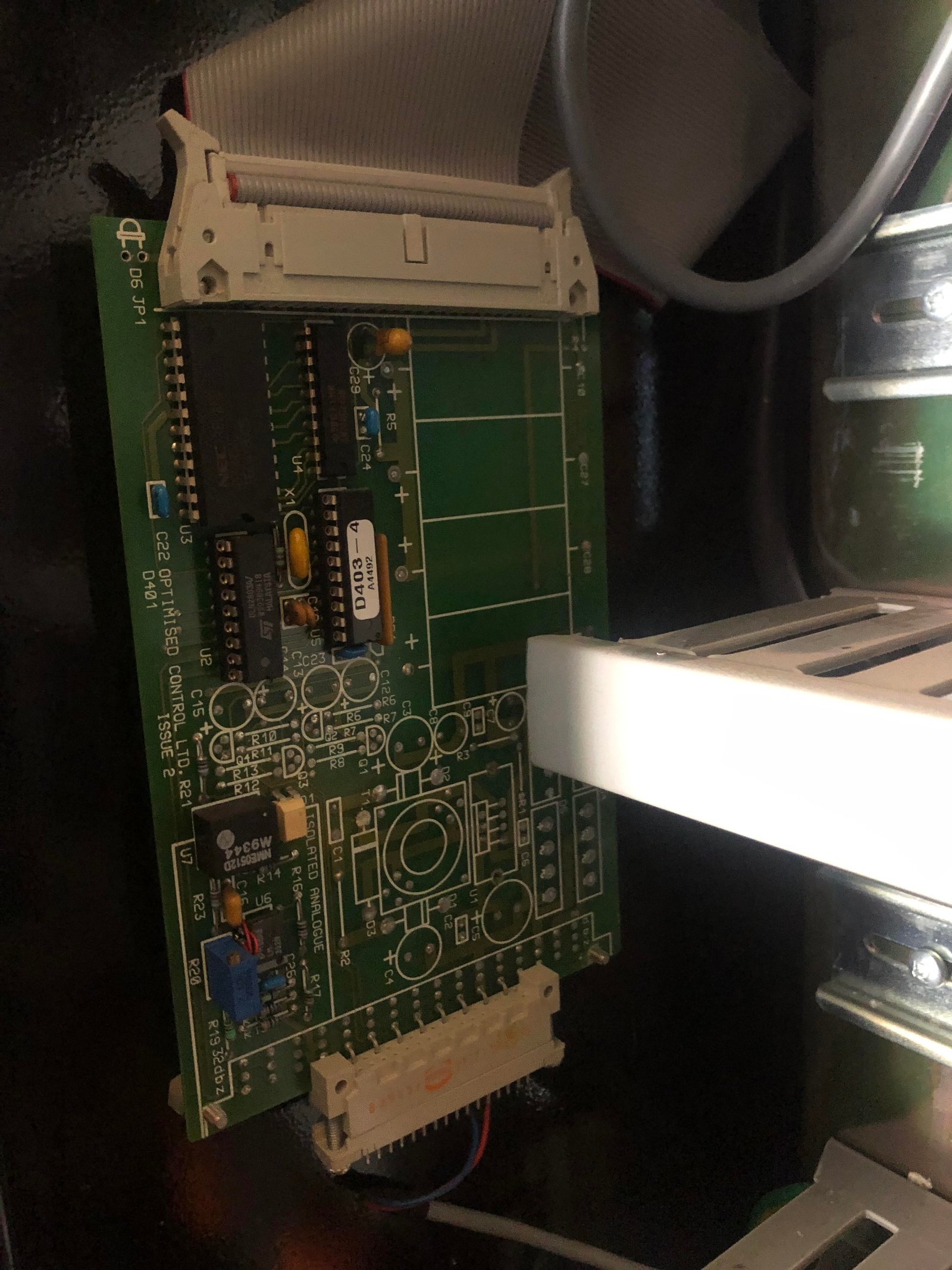

I try change the E prom chip but nothing .

It is only the SmartStep/DenStep top board that needs the VR EPROM
If you put the original EPROM in the NextStep board are you able to detect the control using Denford Easy Upgrader?
Have you installed the Baldor USB Driver?
Have you selected Novaturn NS?

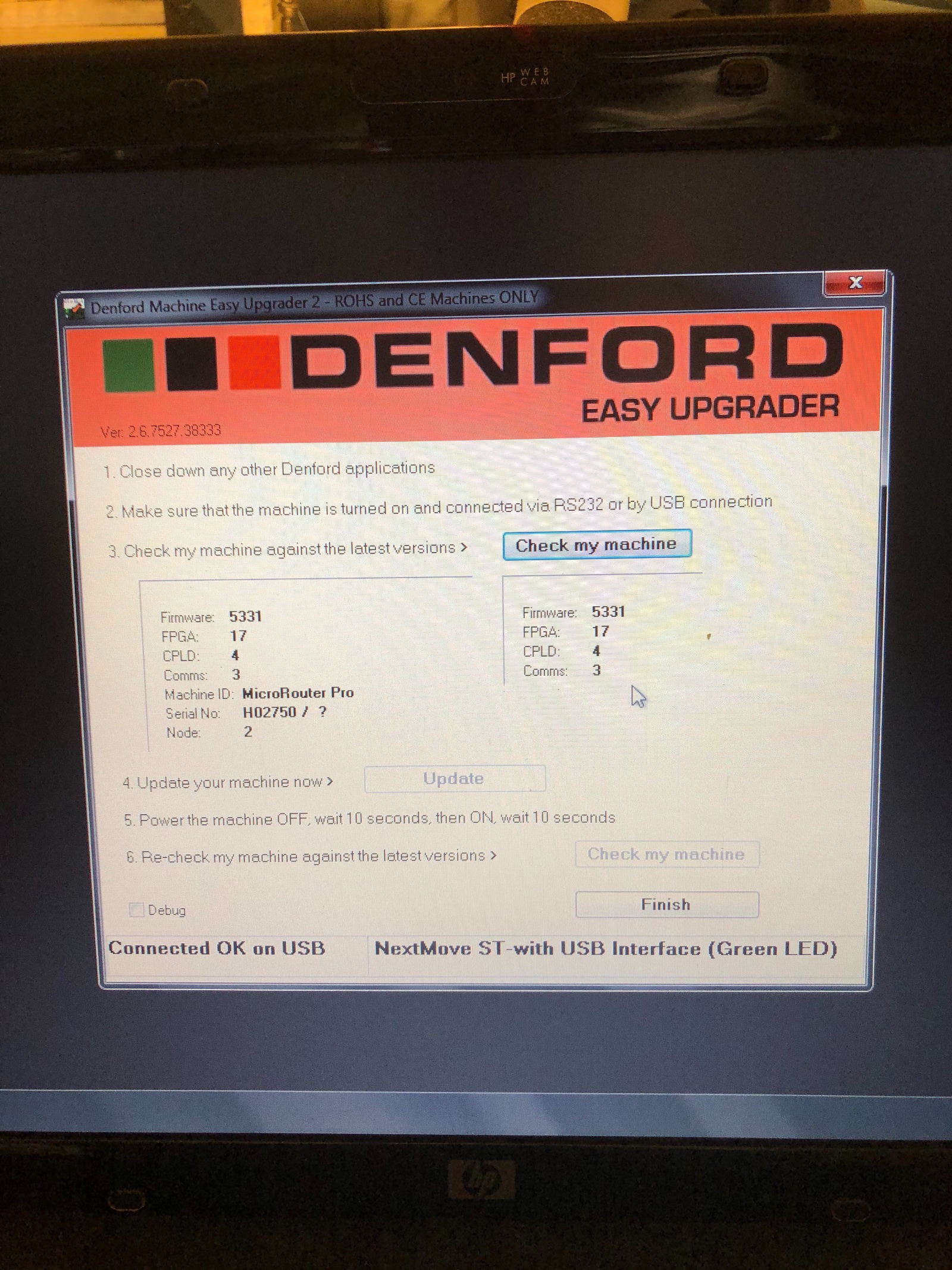

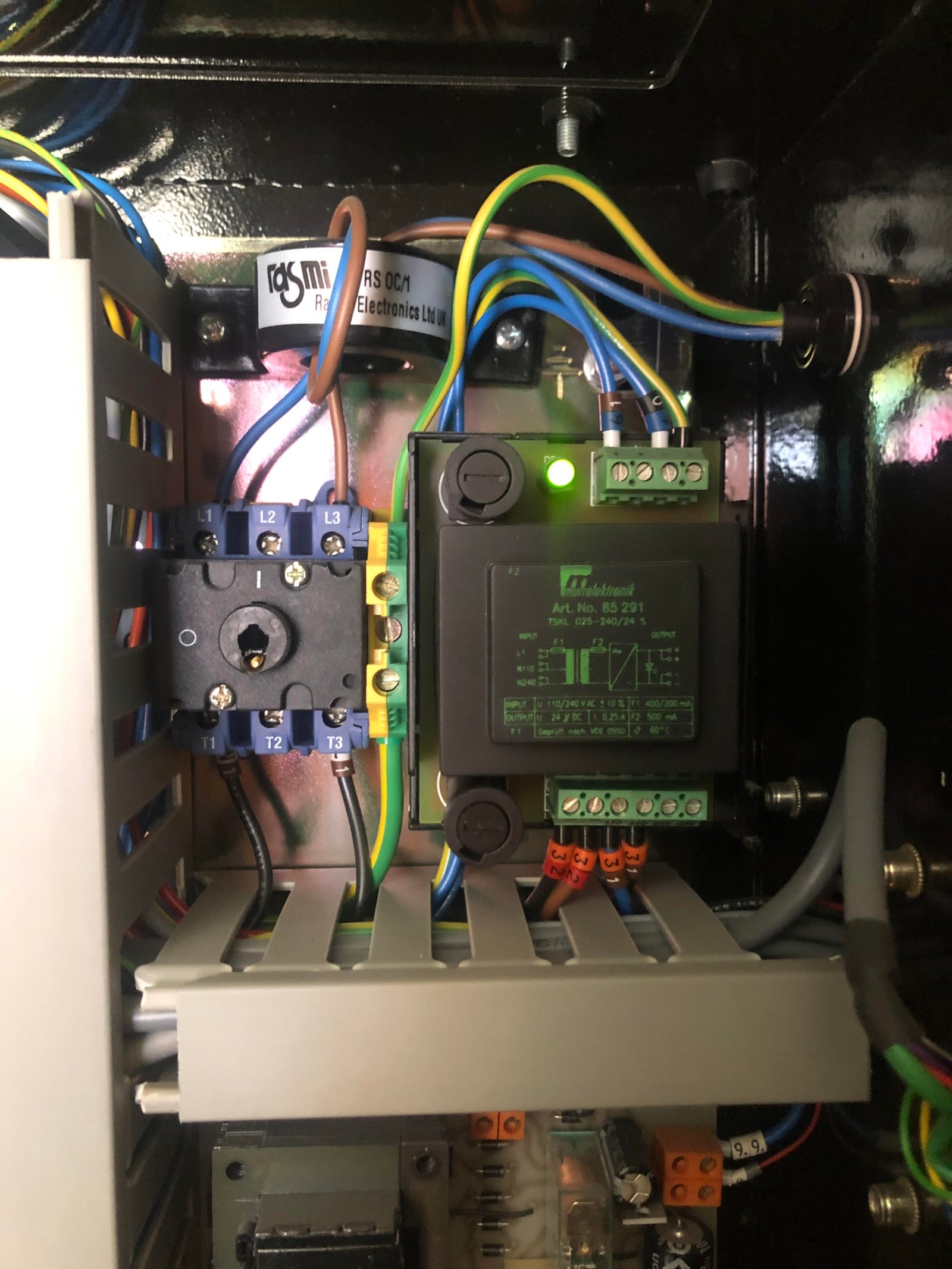

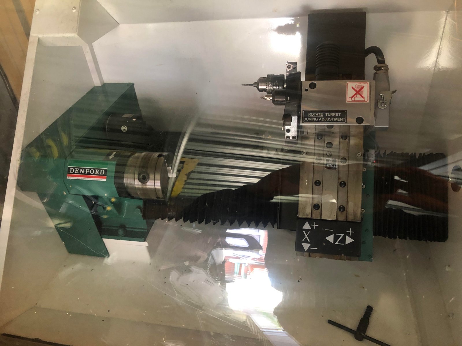

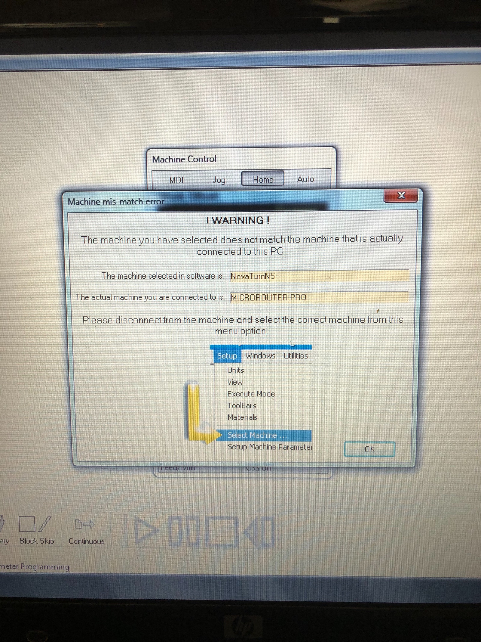

Hi! I try step be step . Working !!! I upload some pixtures because simething not perfect . All axis go to home and spindle spinning . Today try the tutor . Ease see the pictures . Many big thanks .
- 0C08797A-65B0-4961-B129-4DEC3CDC151B.jpeg (1.02 MiB) Viewed 30855 times
- 3AF43D41-0657-4B34-A4EE-D703011D6E6A.jpeg (1.01 MiB) Viewed 30855 times
- AB097E90-6683-4D58-802F-3223FB4E88E7.jpeg (1.14 MiB) Viewed 30855 times
- 9977EDD5-9E5A-4E6C-B3BE-EB85B0396D07.jpeg (1.52 MiB) Viewed 30855 times
Re: help please
If you right mouse click on the orange banner in EasyUpgrader when you are connected then go to Advanced, (password is "dave") you can change the machine type. You may need to set it to Unknown.

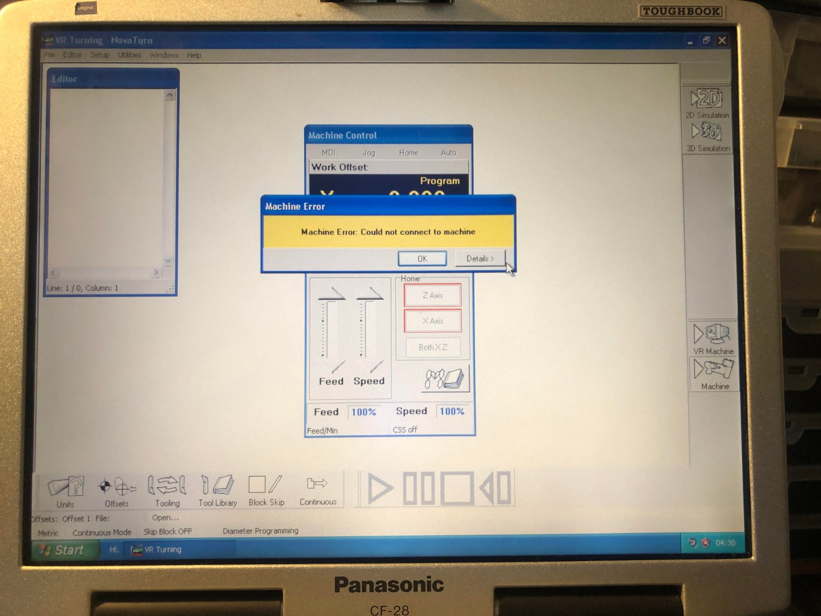

hi ! I try my novaturn today and not connect to vr turn . just two messages pop up 1- Emergency stop safety checking has failed , contact denford if problem persist. 2- electronic safety check have failed .system must be restarted. what can I do . thanks for all help .
