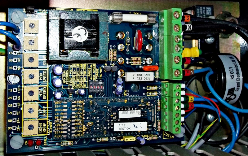

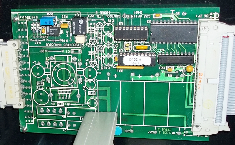

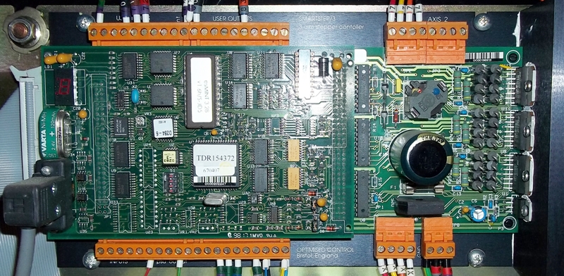

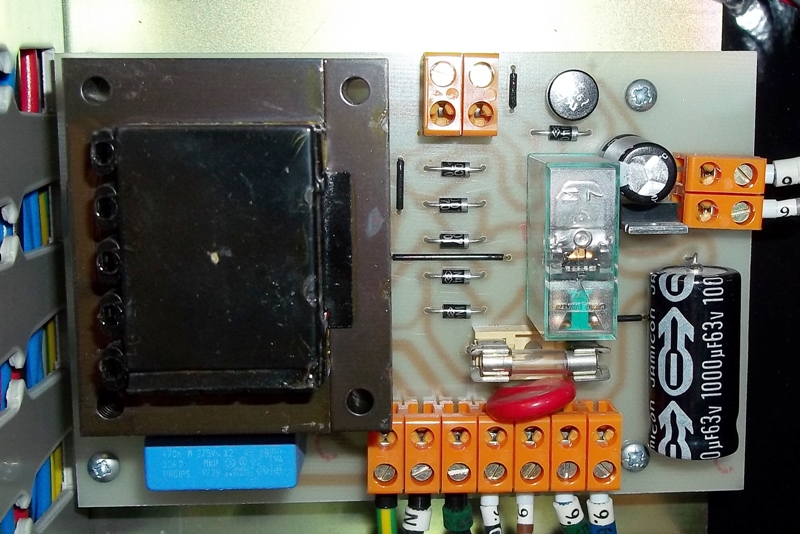

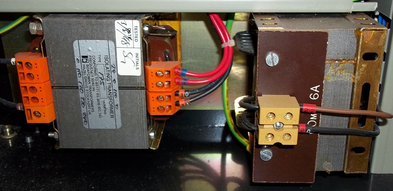

I thought I might as well send pictures of all the boards so you can see what the control board looks like. Thanks.
- 102_0993.JPG (424.32 KiB) Viewed 23141 times
- 102_0992.JPG (405.06 KiB) Viewed 23141 times
- 102_0991.JPG (288.49 KiB) Viewed 23141 times
- 102_0990.JPG (371.09 KiB) Viewed 23141 times
- 102_0989.JPG (497.03 KiB) Viewed 23141 times

The photos are:
Isolated spindle analog drive card.
Smartstep Base Board
Logic transformer and spindle Choke
Turret Drive Card
Spindle Drive Card.
The control card is an early version and the upgrade you would require is UGR0009. This would replace the whole control card, power supply, E-Stop relay and Transformer.
You cannot just replace the top card on the control card.
UGR00009 Smartstep to USB and VR CNC Milling5 Upgrade- Return to works £1908
