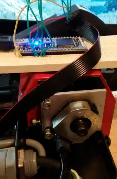

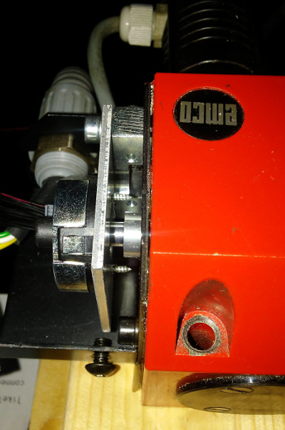

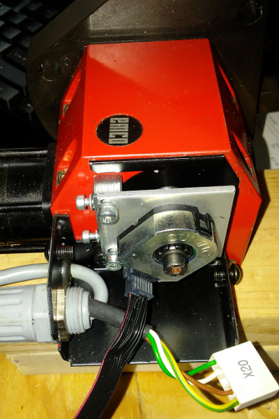

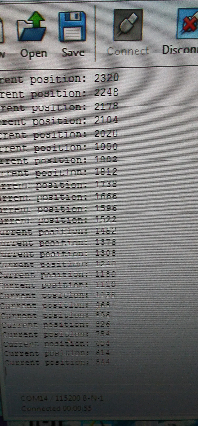

I started my conversion of a EMCO Tool Turret a few weeks ago.
STATUS:
EMCO Compact 55 Tool Changer modified with a AMT203 ABS Encoder with SPI interface.
ARM LPC1768.
The encoder interface is now working.
Denford NovaTurn AC Servo Lathe used to make new encoder adapter.
The set-up uses the existing tool changer board. I am in the process of designing new board to replace the EMCO, that will have its own motor driver.
Next step is PathPilot interface to MESA 7i77.
Iron-Man

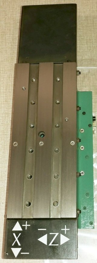

A question to DENFORD
I have noticed that later models of the NovaTurn have a bed which allows different tools to be placed, as in this image:
My question is, can the flat bed of my older model lathe be interchanged with the one in the picture?
Thank you,
Iron-Man
Thank you,
Iron-Man
- NovaTurn milled bed low res.jpg (49.42 KiB) Viewed 20050 times

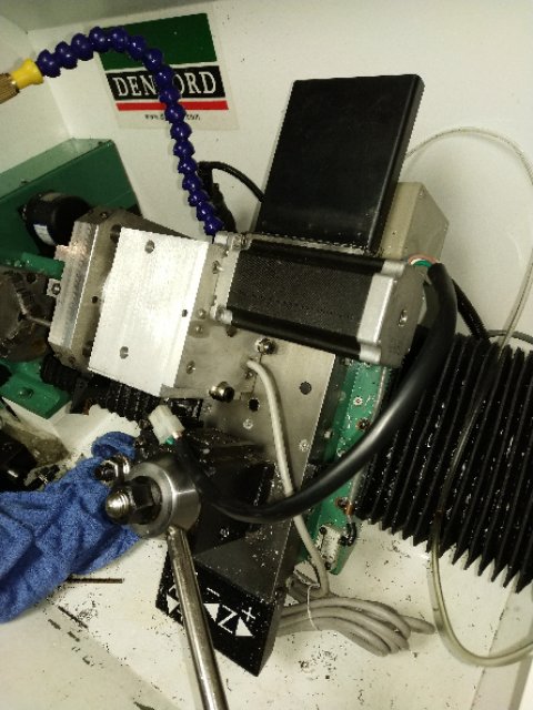

I have been working on a Decaussin back Turret for the NovaTurn. It is not attached.
- Decaussin Turret.jpg (70.24 KiB) Viewed 16260 times
