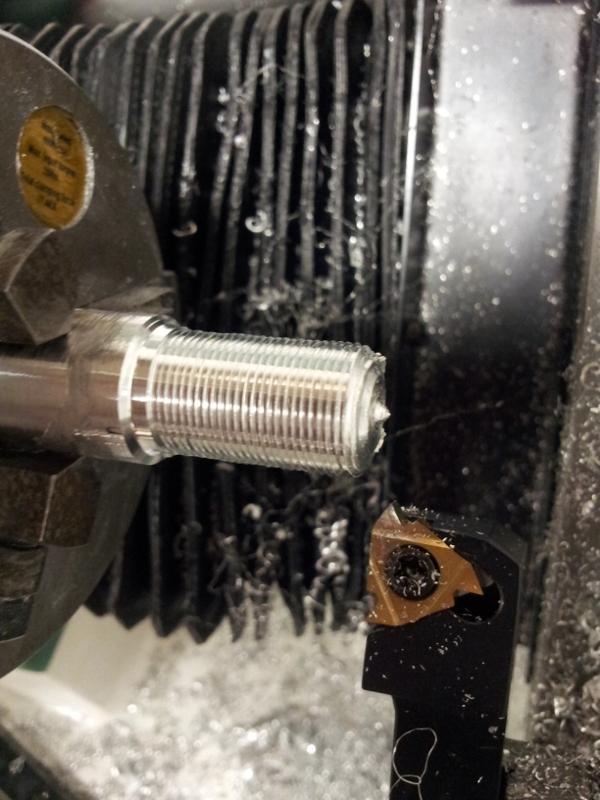

28 TPI Threads Test.jpg (323.66 KiB) Viewed 58139 times
Surface Finish.jpg (720.73 KiB) Viewed 58139 times

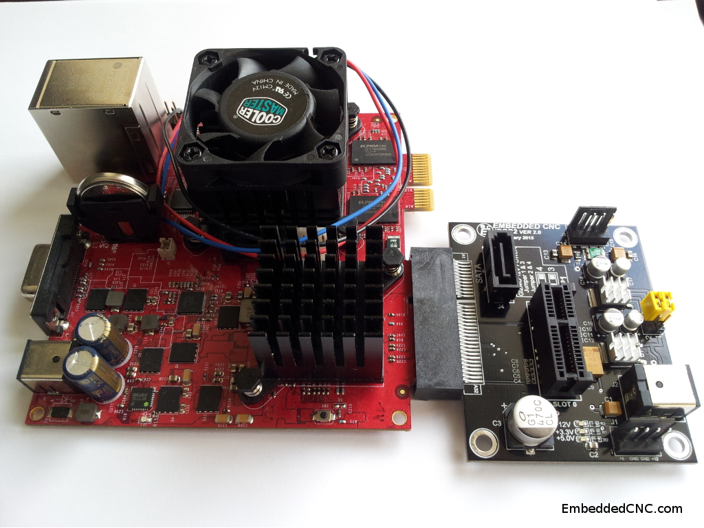

Re: NovaTurn Servo retrofit AMD Gizmosphere iBOB2 PCIe x1
iBOB2 + GizmoSphere 1<br /><br />I am running PathPilot on this system.

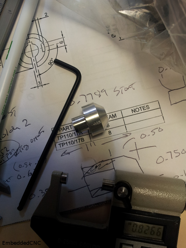

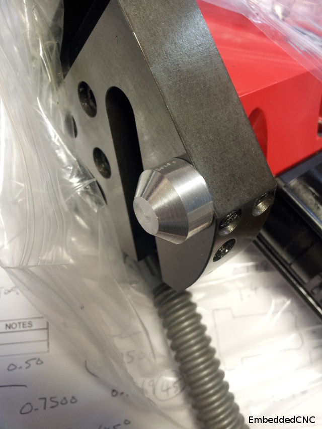

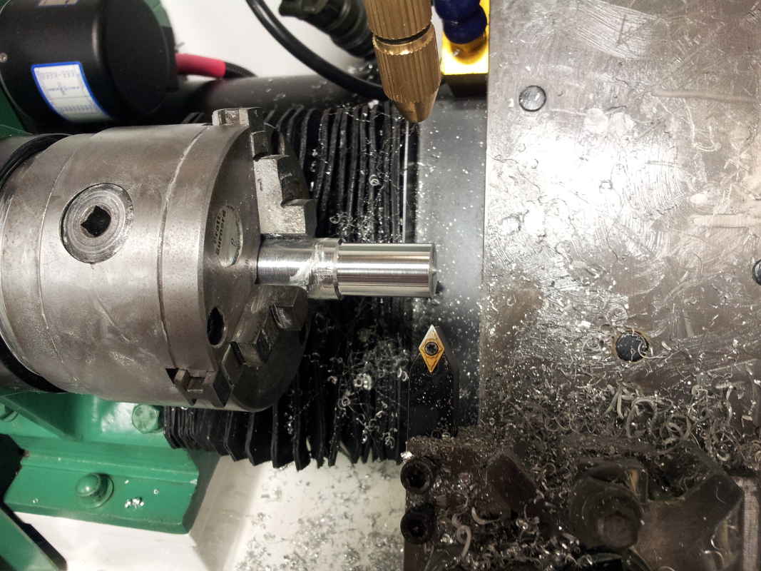

Sample test part. Will post more video later.
Iron-Man
tool holder in turret 2016-03-20 11.58.29.jpg (353.84 KiB) Viewed 58038 times
tool holder 2016-03-20 11.58.04.jpg (364.74 KiB) Viewed 58038 times
part1 2016-03-20.jpg (495.81 KiB) Viewed 58038 times

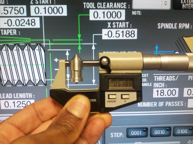

Example test part 0.5188.
Hope this helps,
Iron-Man
1qtr npt test part 2016-03-30.jpg (394.14 KiB) Viewed 58002 times

Denford NovaTurn refit with AC servos.
1/4 20 thread test with sample parts.
Three (3) phase power is not needed. I am using dual power from 220v and 115v standard.
https://www.youtube.com/watch?v=FM0EkKy ... e=youtu.be
Iron-Man

Mitip the Yaskawa 100W servos I used were almost a perfect fit. I only needed to make new motor plates. If you want to use Mach 3 then you will need servo drives that use step-direction. I am using a complete closed loop system. My servo drives take +-10V analog with encoder feed back to Linuxcnc / Pathpilot. Mach 3 will not work with analog servo drives without additional hardware. Mach 3 runs under Windows (not real-time). If you want true precision, you need a real-time operating system plus a closed loop servo system. Any kit would not be plug and play because analog servos require tuning, ie. PID loops. As far as size. The AMD board is approx 4" x 4". The iBOB2 approx 2" x 3".
