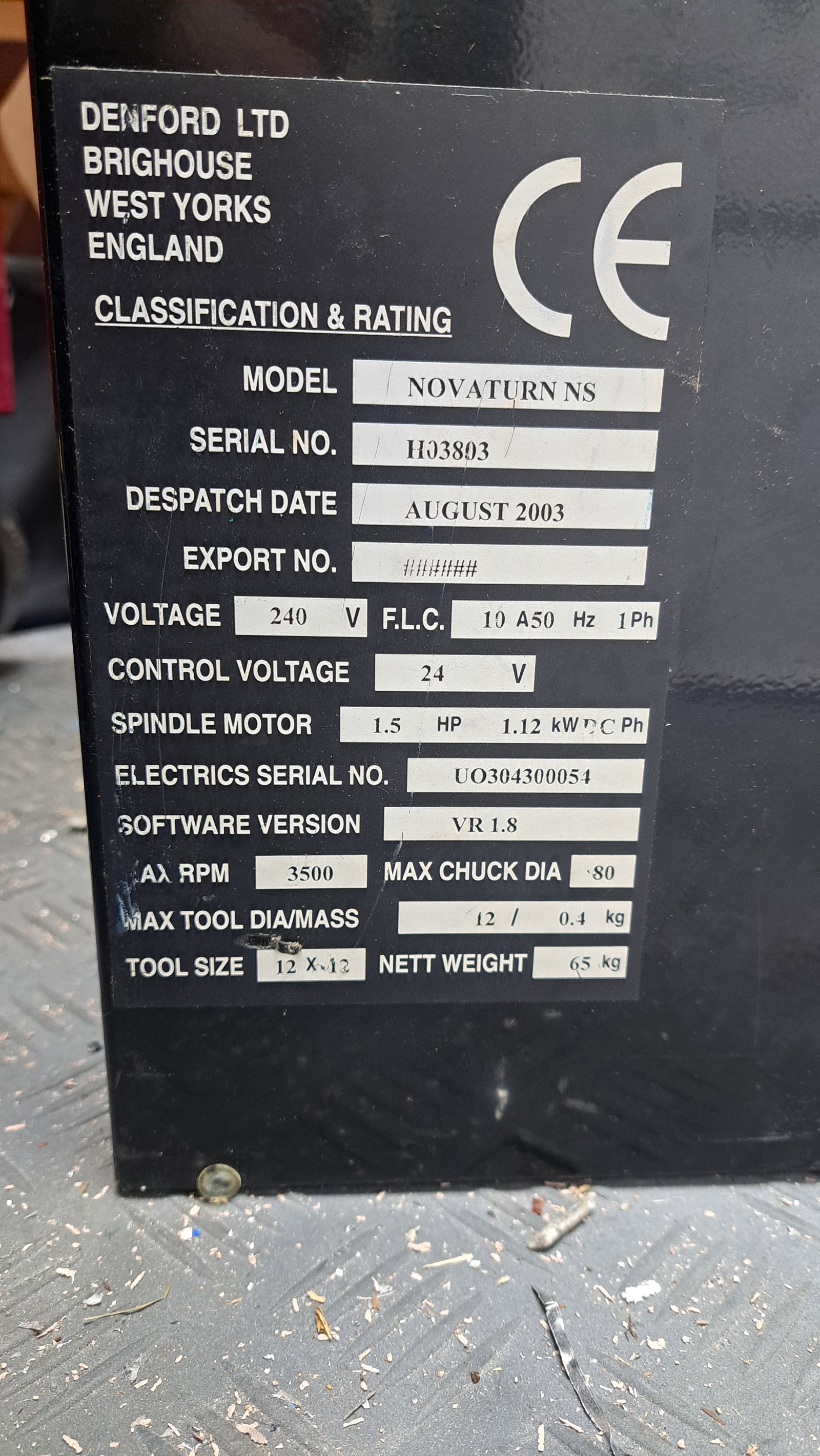

It sounds like you have an issue homing which may be as simple as a axis drive fuse.
Can you post a picture of serial plate & the electrical cabinet.

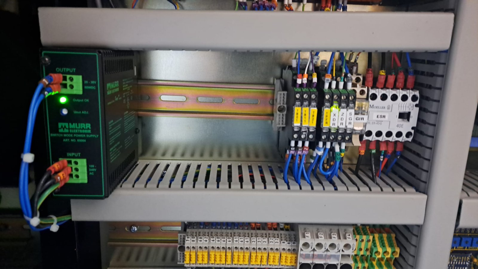

Can you post a picture of the electrical panel. There should be more than 3 fuses.
Deck36
Posts: 20
Joined: Sat 06 Mar , 2021 22:25 pm
Re: Novaturn NS

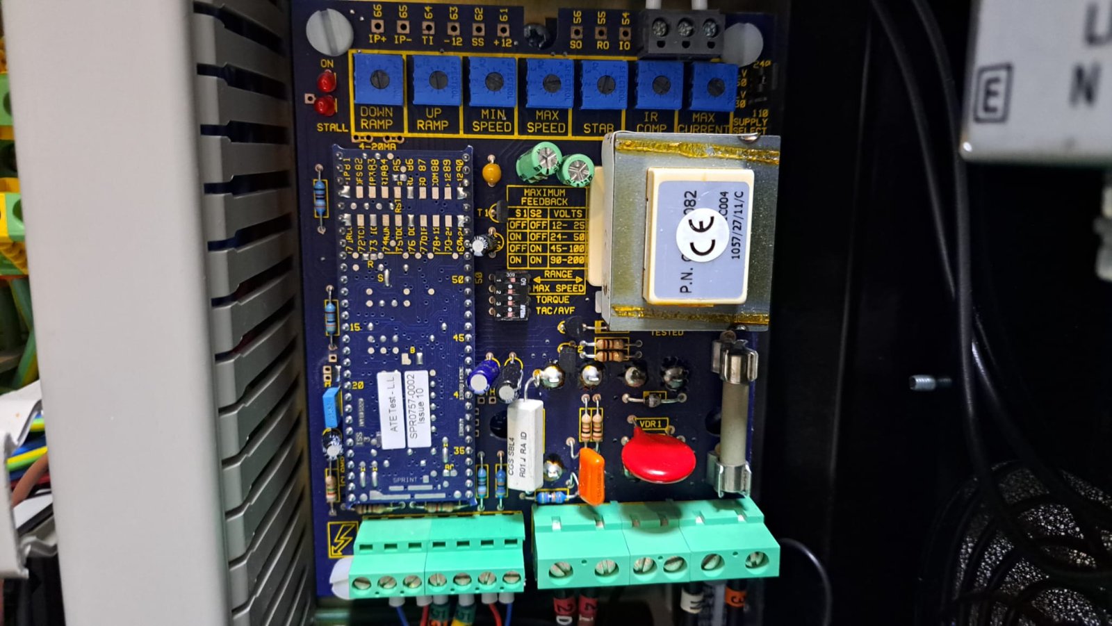

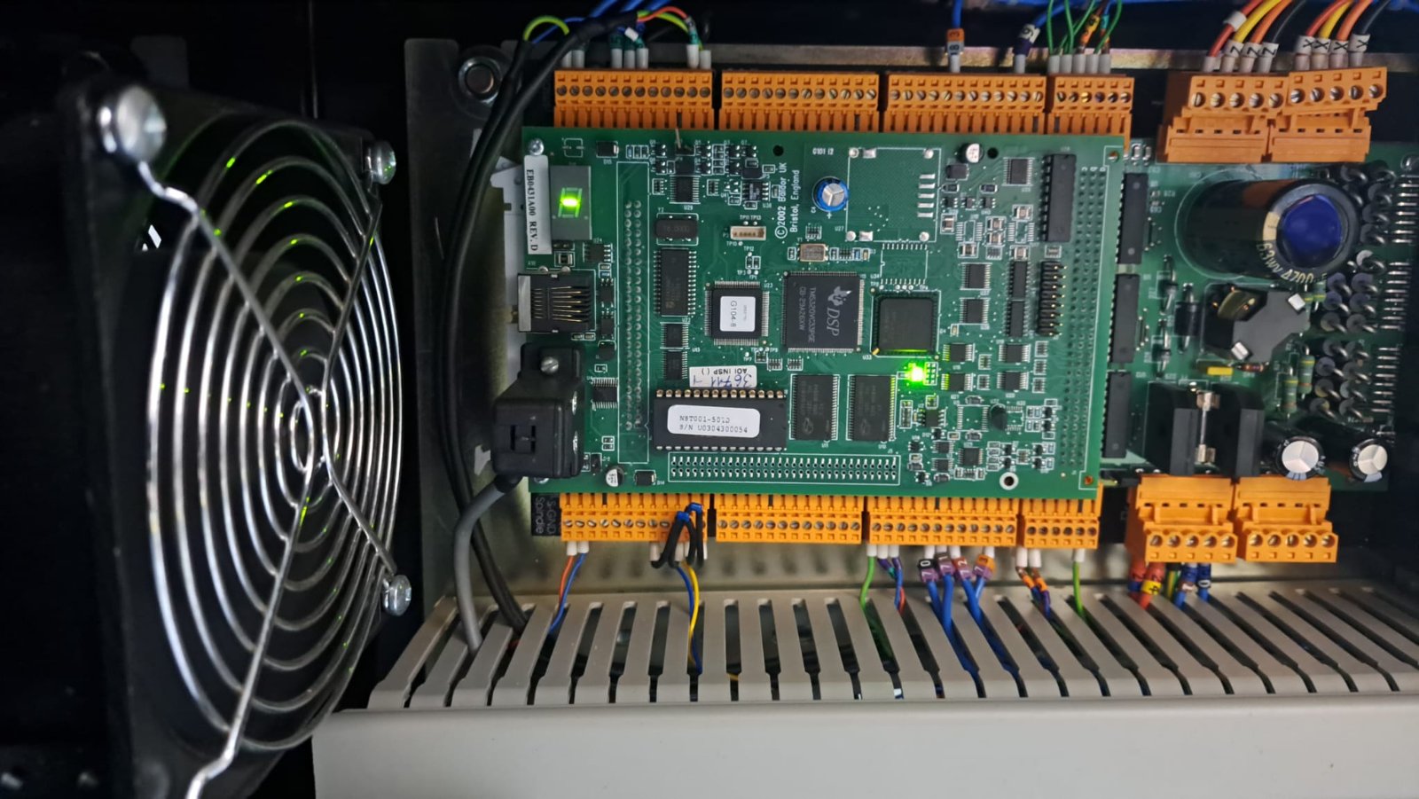

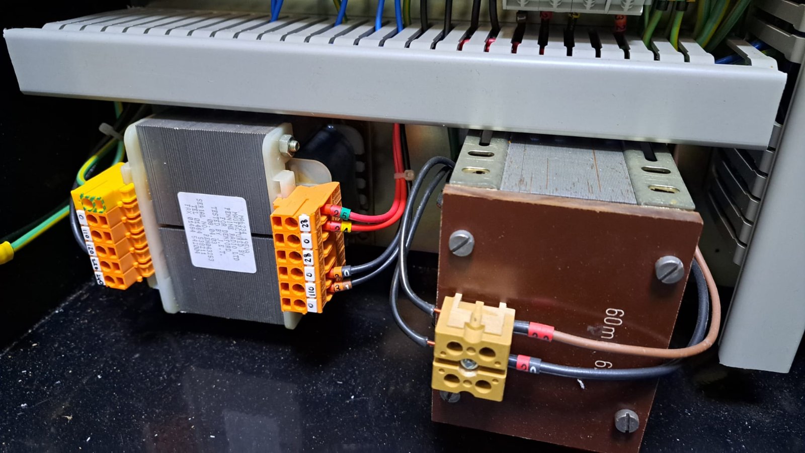

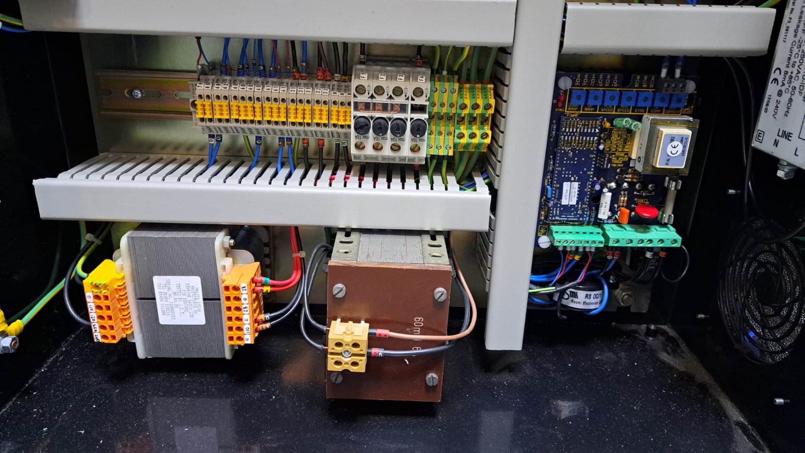

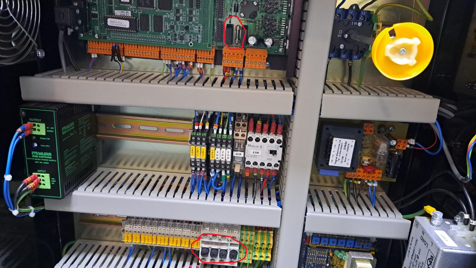

Post by Deck36 » Mon 28 Apr , 2025 15:43 pm
More than 3 fuses iis great news. Hopefully the ones I didn't find are blown.

Deck36
Posts: 20
Re: Novaturn NS
Post by Deck36 » Fri 23 May , 2025 8:57 am
Is there a Novaturn NS electronics circuit drawing or schematic with fuse locations on it?

Post by Deck36 » Thu 12 Jun , 2025 11:05 am
All fuses found and checked. All still good though, so not the problem. :(

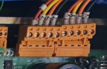

Post by Martin » Fri 13 Jun , 2025 8:13 am
Just had a look back.
It looks like the Motor connections are loose. Can you check.
