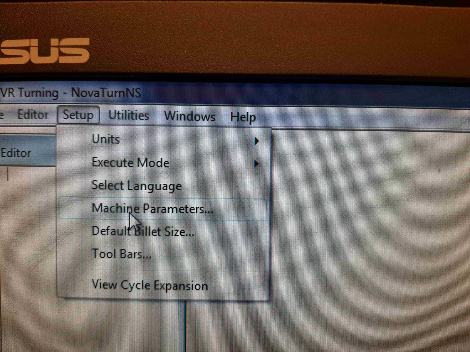

Please can anybody help me to connect VR Turning to my Novaturn NS.
I recently acquired a lovely Novaturn NS. I did have this working from my pc using vr Turning to test it out. It worked! although it wasn't straight forward to connect . (Possibly because I was using a serial to USB adapter? However I did have it working with this.)
Using this adaptor I found it a bit unreliable. (Can't be sure this adaptor was to blame!!?? ) It would run a test program but suddenly stop halfway through the program. When I changed to a serial cable 25/9 pin it was reliable in tests.
Now I have set it up in its permanent position in my workshop and try to connect it using vr Turning via the 9/25 pin cable, it will not connect.

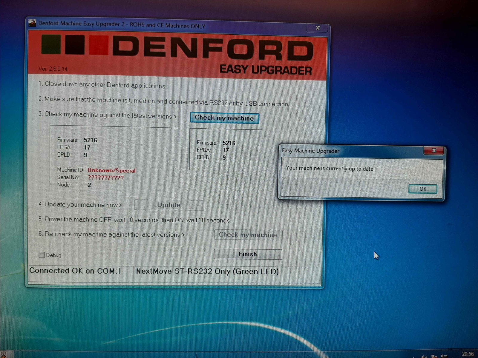

Easy upgrader 2 connects and says the machine is up to date.
However VR will not connect. The cursor just sits there spinning and I have to crash the program.

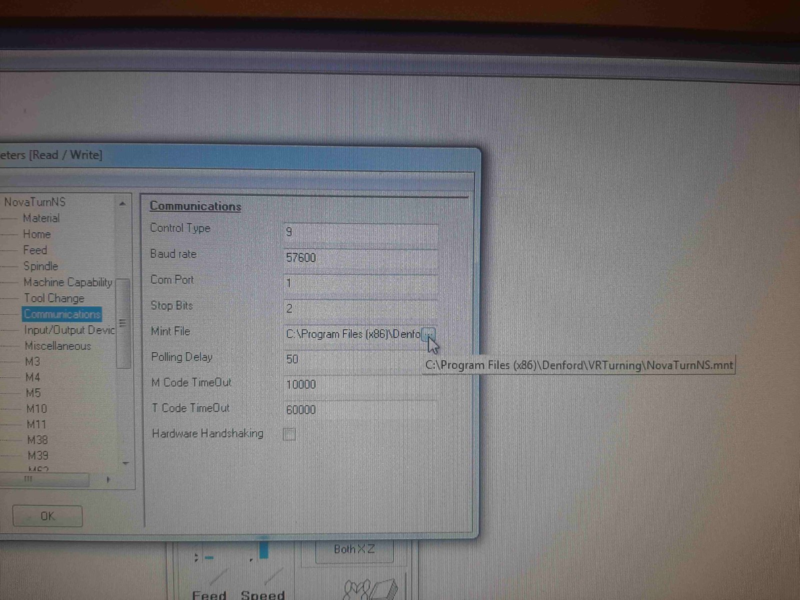

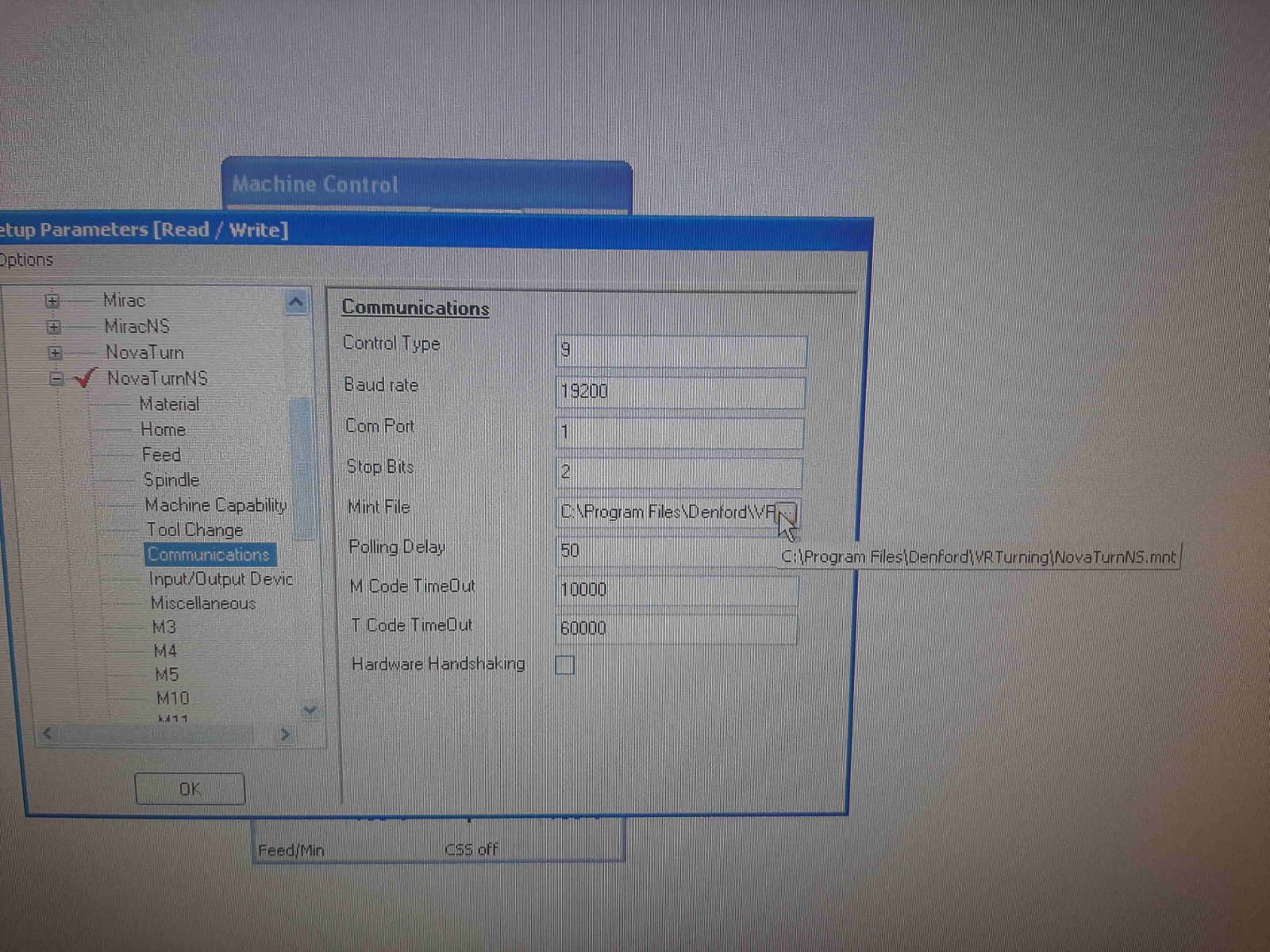

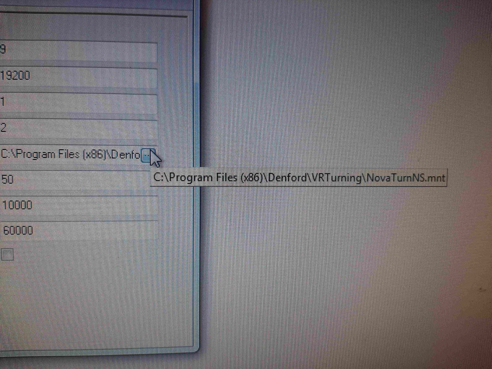

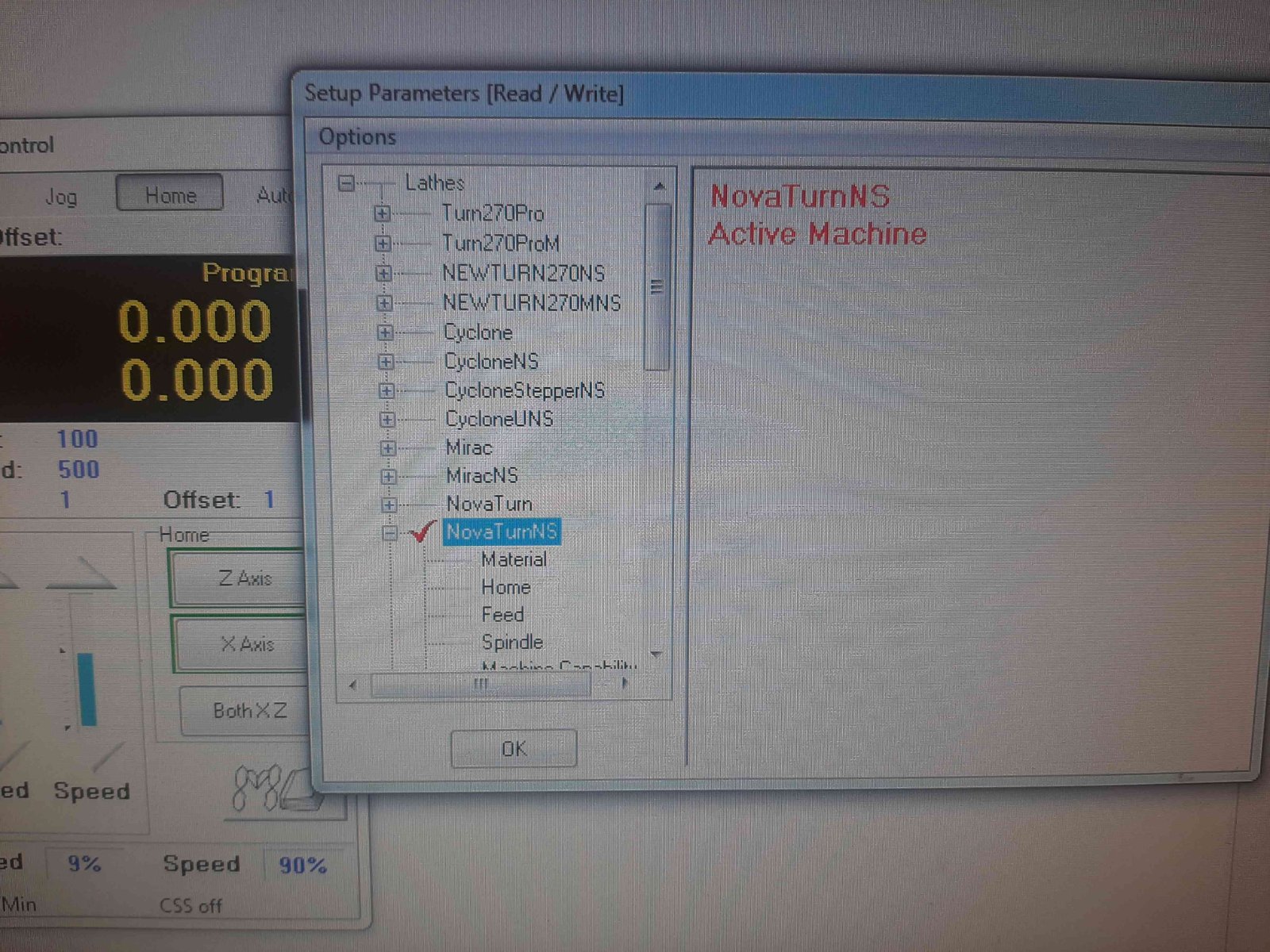

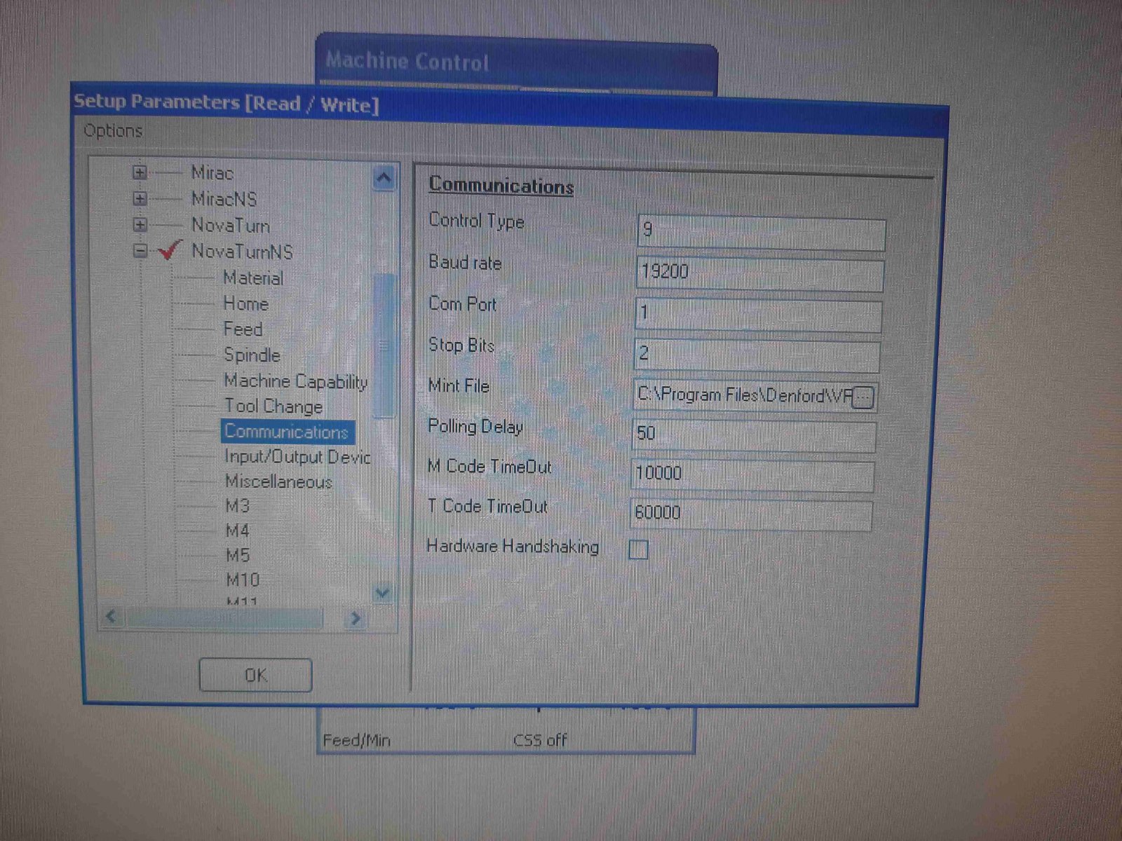

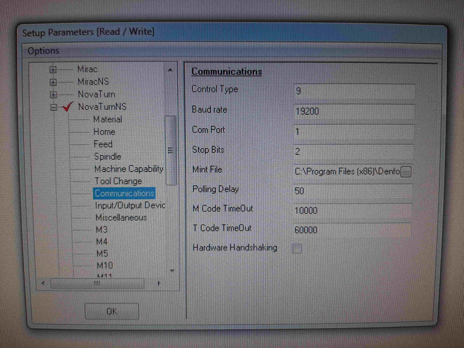

Here are some photos that show settings etc. Can anybody suggest what I might be doing wrong?

HI,
The only thing I can see software size that is different from default is the Baud rate, which should be set to 57600. maybe this will help.

Post by Dodds » Thu 03 Aug , 2023 12:39 pm
Hi Mitch, thank you for replying to my post. I changed it to 19200 from 57600!
I thought that the figure had to be 19200? I read that on the forum in another post. Is there a different baud rate depending on the machine or cable used?? I am not a computer man so don't really understand this type of stuff!
When I get home tonight I will try 57600 and let you know.
Thanks again for your help.
David.

Post by Dodds » Thu 03 Aug , 2023 22:47 pm

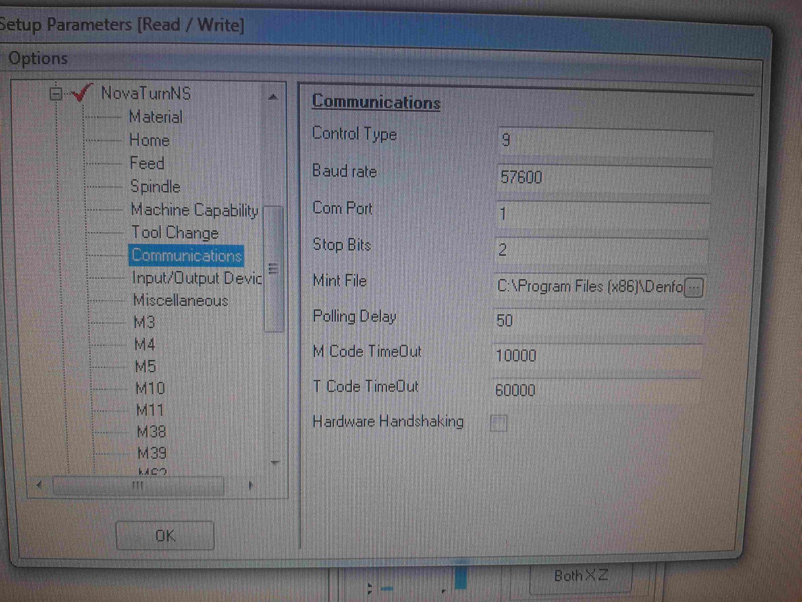

Hi Mitch, I changed the baud rate to 57600 and it still would not connect. I restarted the pc and still no luck.
However I decided to reinstall vr Turning and using 57600 it now connects!! So great news. Many thanks for taking the time to suggest the different baud rate.
For anyone else reading this who are in the same position as I was. Here are the settings that work for my Novaturn NS (green display) with rs232 cable 25/9 pin connection.
OK!
I do have a second novaturn ns with USB connection orange display and these are the settings that work for this.
David.

Hi David,
Really the machine should have connected with the lower Baud rate (its just a connection speed as such), it was the only difference I could see in the setup. but from what you found it must have been an issue in the installation.
Your other machine with the USB connection will not use the set Baud rate as the driver will manage the connection speed.

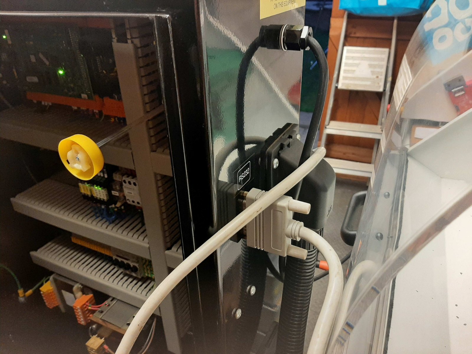

Hi Steve thank you for your comments. I was aware that the 25/9 pin cable is wired different to standard. My brother has helped me on this. He has made me 2 cables. Wired the correct way. I also have one of the black lindy cables you mention. However I have a fourth, off the shelf cable and that works as well. So must be a fluke?

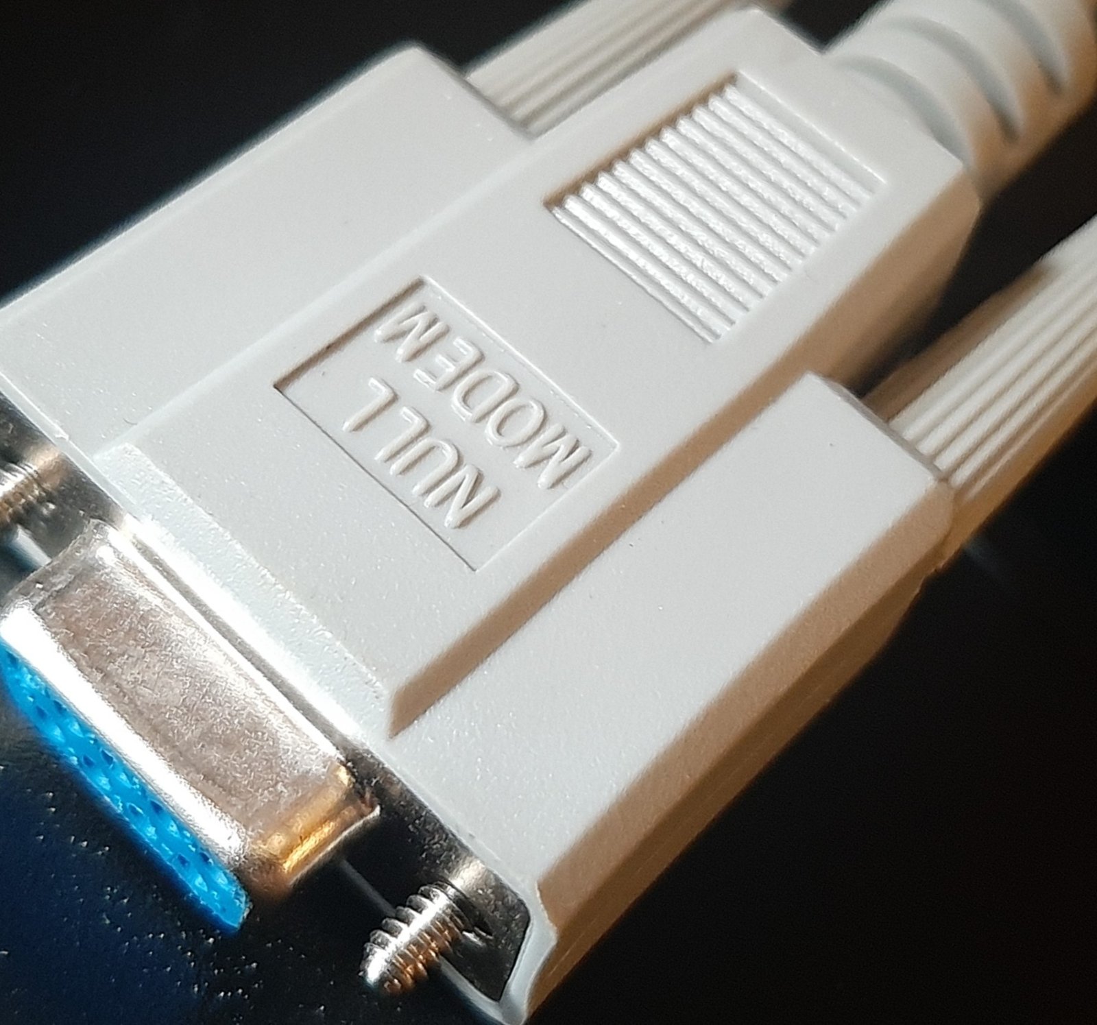

Post by Dodds » Fri 04 Aug , 2023 19:36 pm
Regarding the "off the shelf" cable that works. You tech guys might know if this Null modem might mean anything?

Some of the earlier internal RS 232 cables were 2 wires.
It would be best to make up a direct pin to pin lead to connect directly to the control card.

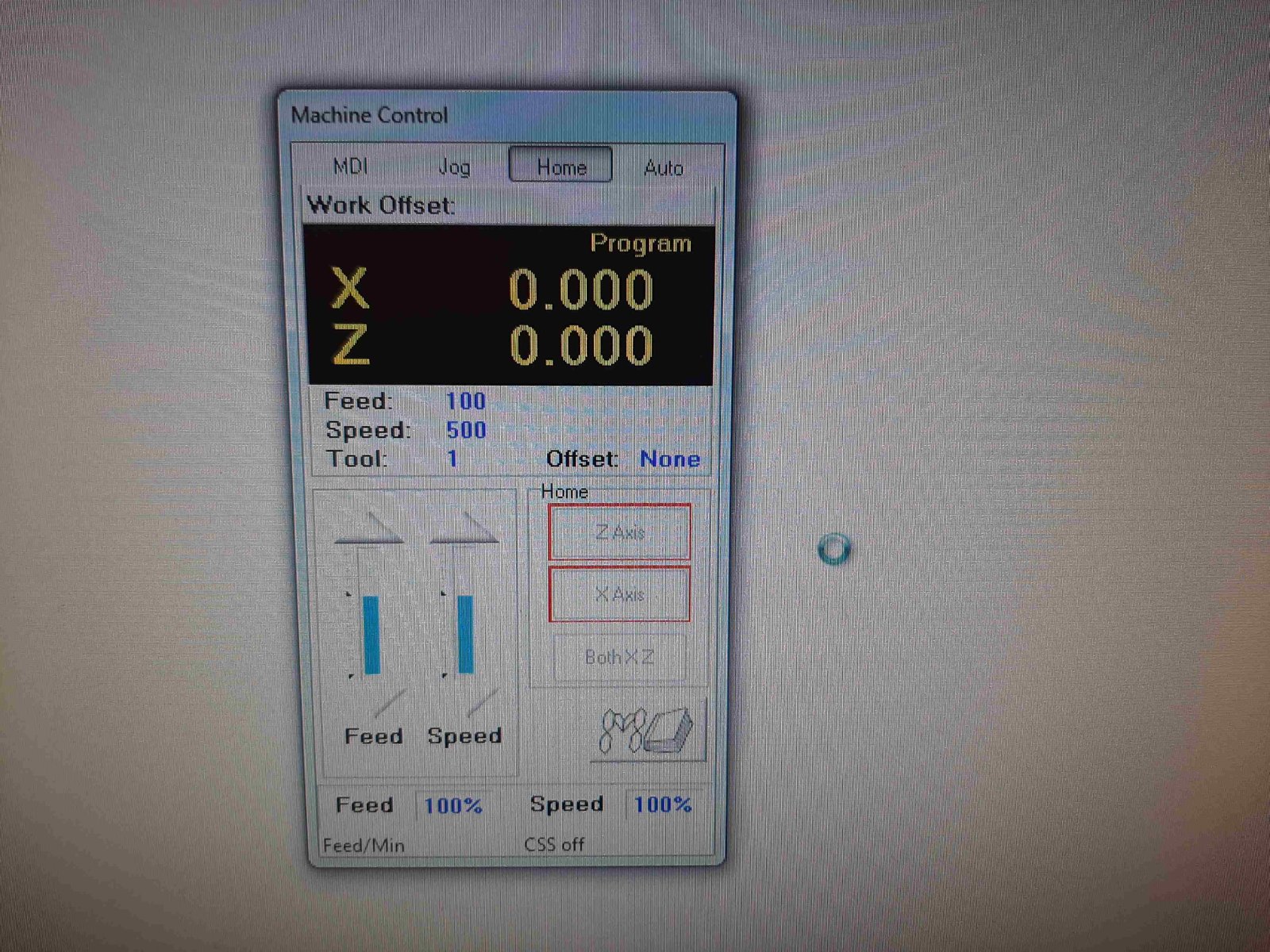

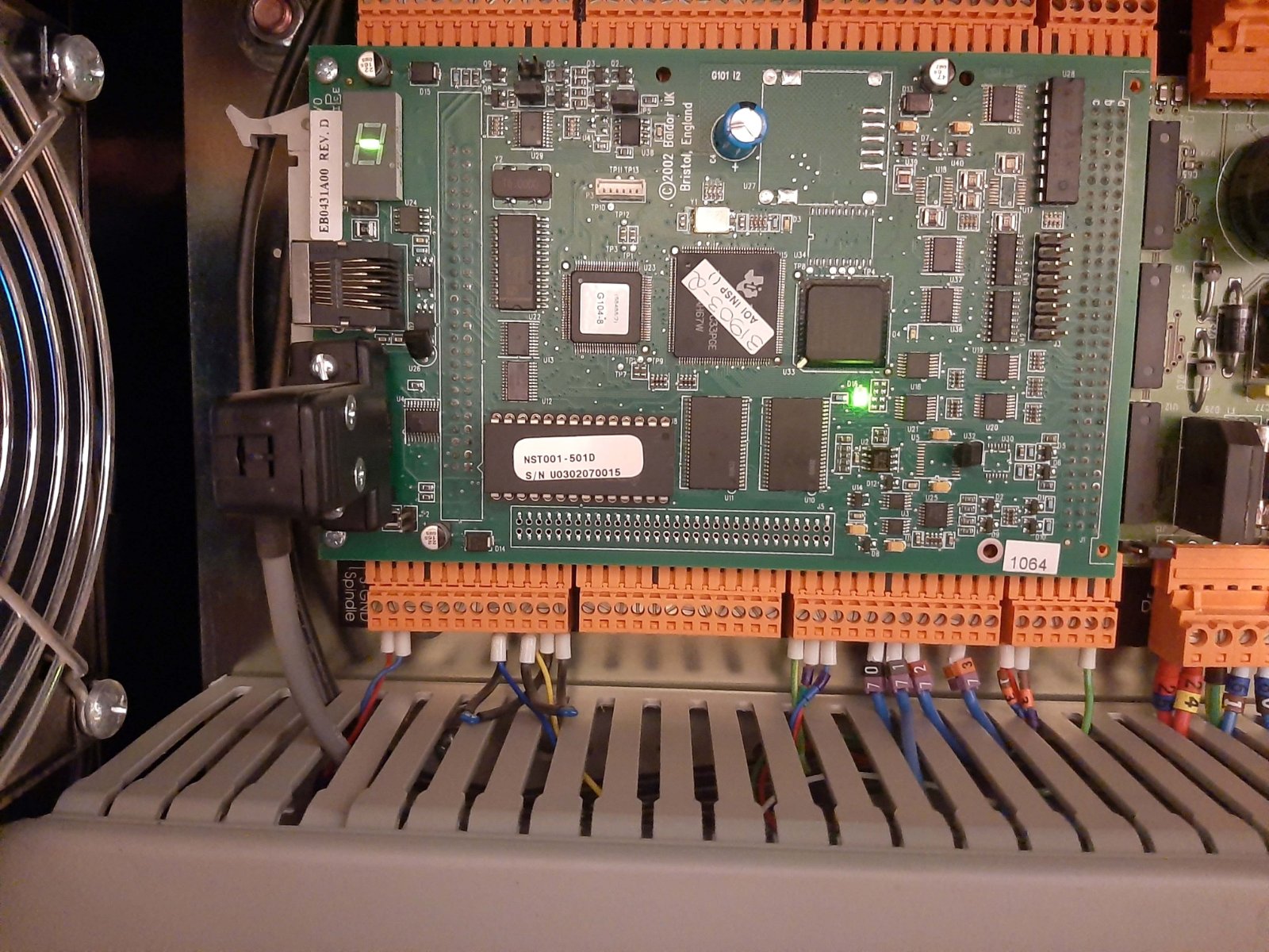

Post by Deck36 » Wed 19 Mar , 2025 21:27 pm

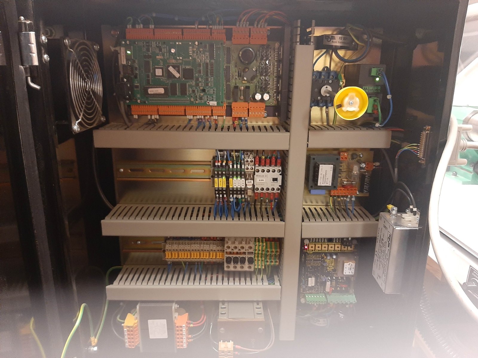

So I made up a new cable following this connection guide
https://www.denfordata.com/bb/viewtopic.php?t=231
It didn't go as well as I'd hoped.
Controller on and 7 segment display shows an E flashing
Hit the "Machine" button and get an "8" on the display
Hit the "Home" button on the machine control dialogue and get a solid "h"
The x/z DRO's thenstart to climb to ridiculous figures (3500mm)
And that's about it. Software locks up.
Help would be very much appreciated
Posts: 1924
Re: HELP CONNECTING VR TURNING TO NOVATURN NS
Post by Martin » Mon 24 Mar , 2025 9:10 am
It sounds like you don`t have any voltage to the axis drives.
If you try to connect does it detect "guard open & e-stop" ?
If it does check the fuses. There is one one the control card on the bottom right.

Deck36
Posts: 24
Joined: Sat 06 Mar , 2021 22:25 pm
Post by Deck36 » Mon 24 Mar , 2025 11:20 am
Found 3 fuses and checked them all. All are good unfortunately :(
