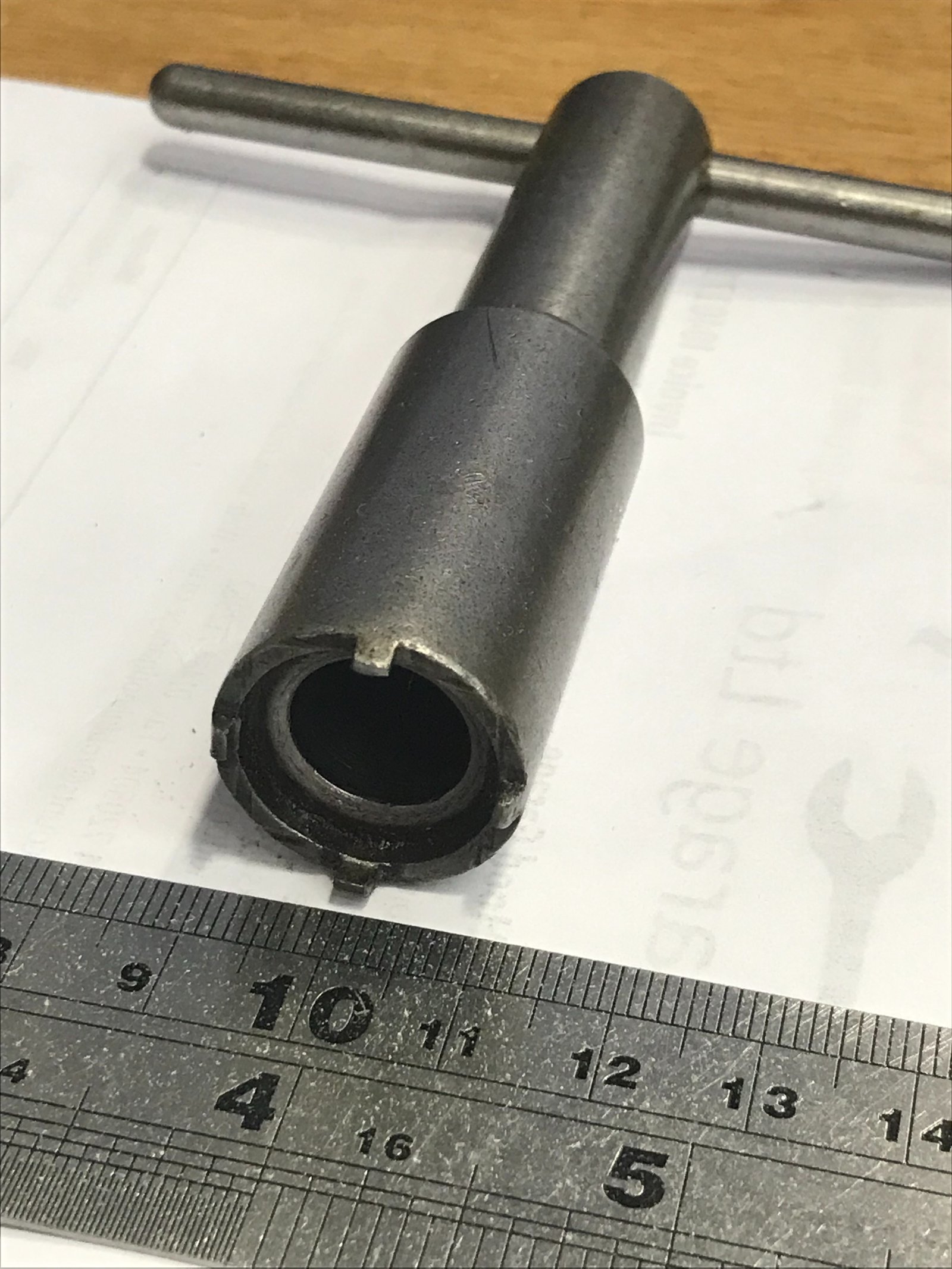

The Lock Nut is most likely a KM1
https://www.thebearingcompany.co.uk/pro ... lock-nuts/
The tool we used was made at Denfords a while ago.

It appears SKF makes a tool for this nut... for a mere $350! :lolol:
I think I'll keep my pennies and cobble up a tool of my own.
Chris
