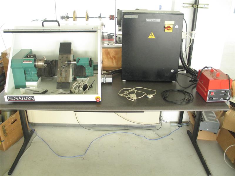

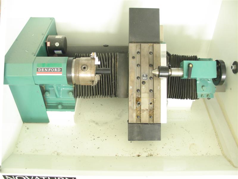

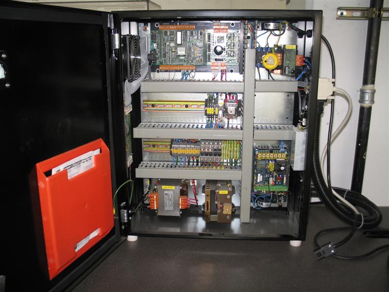

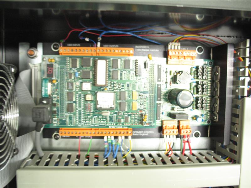

Here are a few overview Pictures

and just seems to hang there. I have already changed the .GO file to account for the fact that I am plugged into COM1 instead of COM2, and the LED indicator on the controller board is an L with a blinking ".", so the system seems to be operational, but I still cannot communicate with it.

Have you got the correct RS232 lead?
Looking at the first photo you posted it has a 25way pre moulded D type lead connected at the control box end & not the RS232 lead. I presume the lead in the photo is either a 25way to 25way or a 25 to 9 converter.

Post by ChrisB » Wed 30 Jun , 2010 14:35 pm
Yes, the setup is slightly different than the first photo. We are using the cable you see laying on the table, which has a 25pin end and a 9 pin end. The one hooked up in the first photo was the old owner's pass-through cable. I was assuming that the 25 to 9 pin cable was part of the original equipment for this machine and that it was the correct one to use. Am I mistaken?
Re: Can I run my Novaturn without a teach pendent
Post by Martin » Wed 30 Jun , 2010 19:08 pm
The lead on the table looks to be a straight 25 to 9 way cable.
The easiest way round it may be to just swap round the wires on pins 2 & 3 on the 25 way D type socket on the inside of the control boix. The RS232 lead shouls be a grey cable about 3M long.
