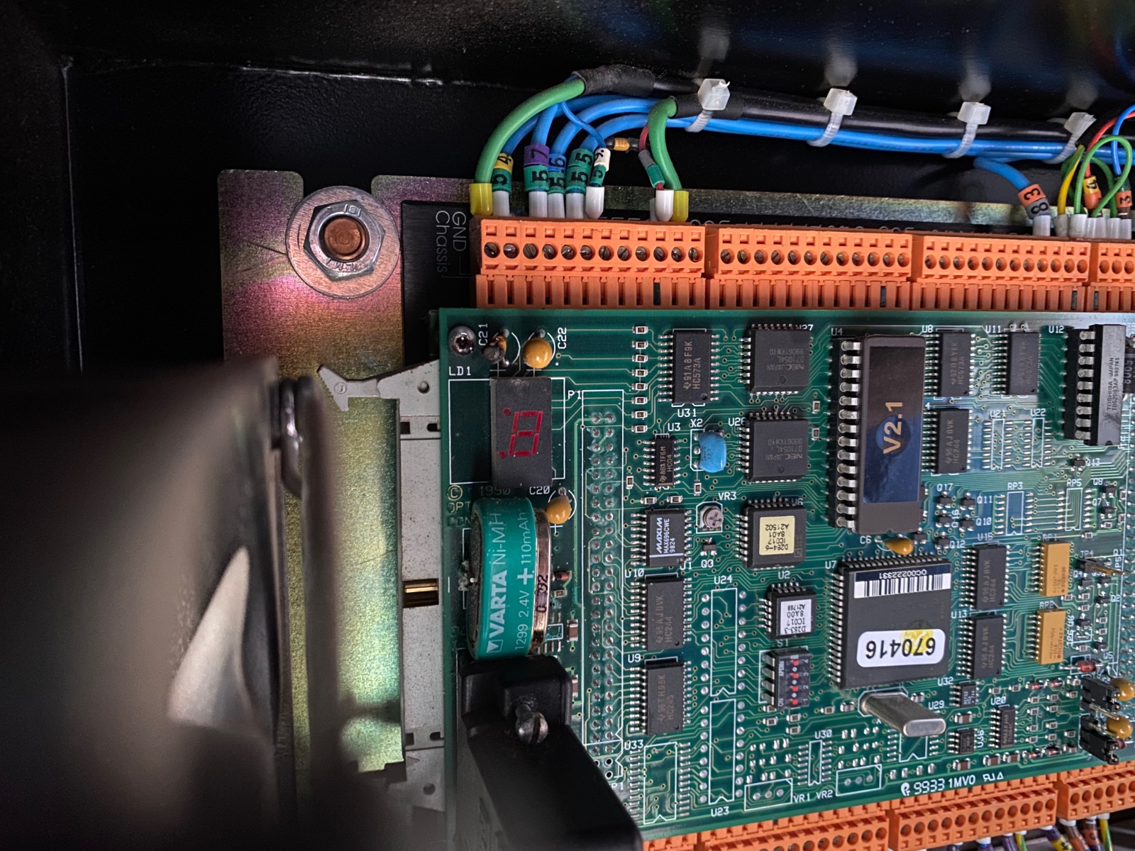

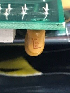

Hi all, I have had a novamill for about 3 weeks. Purchased from a friend who acquired and never used. I got it moving manually in jog, so I know it worked. Since I powered it down, never got it moving again! On the top board of the denstep. Capacitor 21 has completely burnt out. I need to know what capacitor to get. Does anyone have a picture of theirs with the required values? The battery has leaked which I’ll remove and Iv cleaned and checked the rs232. Will give it all a thorough test and clean when the boards are out. Hopefully can get it going without moving to full upgrade as bought as working and have all that I need with it. I had it working with the capacitor failing, which is really frustrating. Have been back through every com port configuration before posting. Any advice/help much appreciated.

Hope this helps

That’s great thank you.
