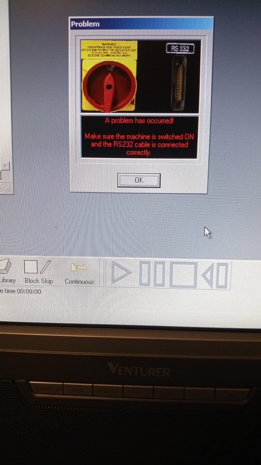

My mill stopped while setting up a job. Homed ok, spindle was on but it stopped moving whilst jogging. I pressed the emergency stop. Software wasn't responding so I had to Ctrl,Alt,Del out of it.
when i restarted the software it didn't connect to the machine. Something was different during the Mint information window. I get VN6 and vr coming up for a moment before it asks me to check the RS232 connection.
I deleted and reinstalled the software but the problem persists.
I took a picture and a short video but the video wont attach. Any help is much appreciated.

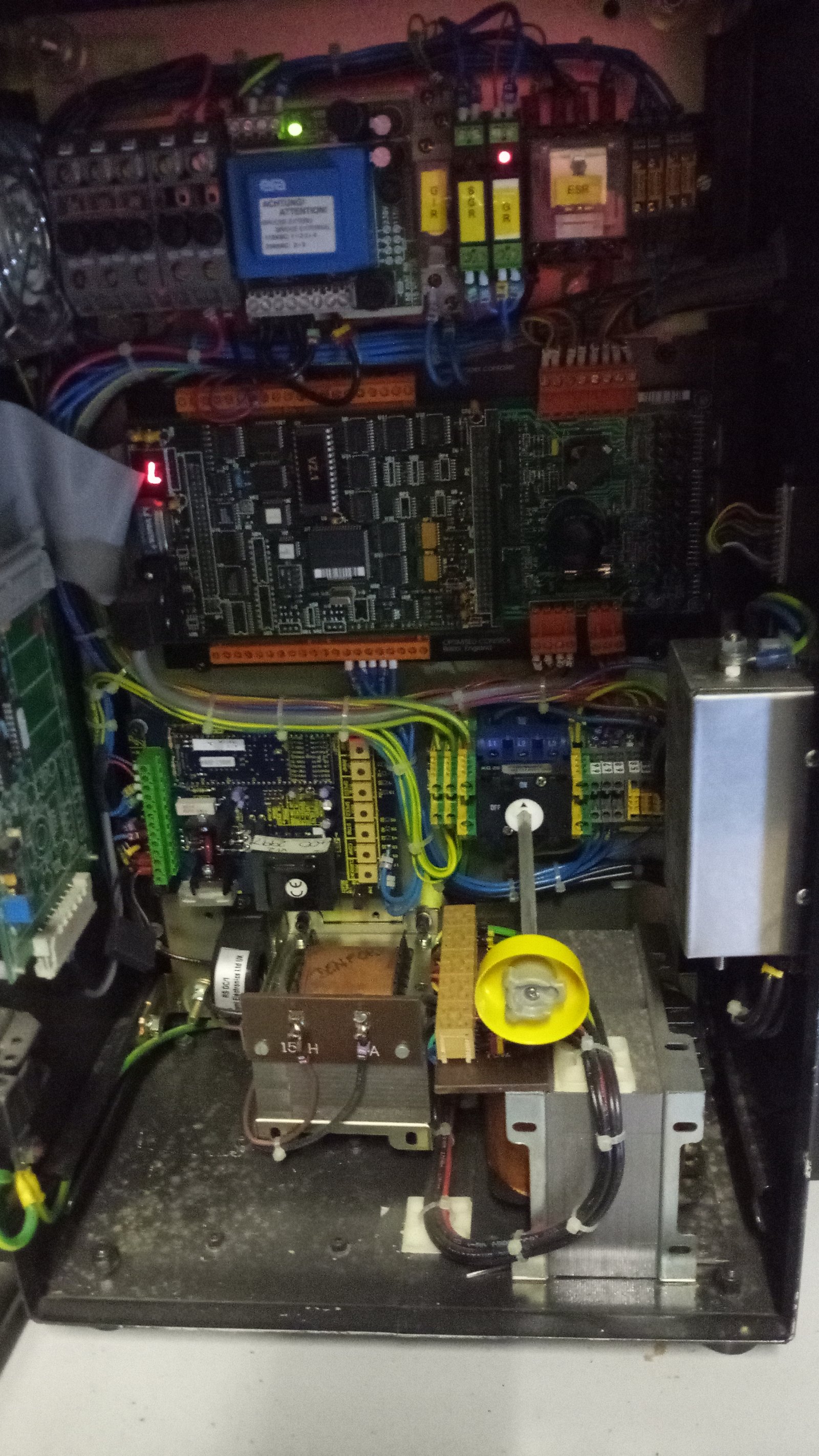

I took a picture. The 7 segment display is on. Is that board the Denstep?

There is a component labeled SGR which has a LED and that isn't illuminated. Should it be?

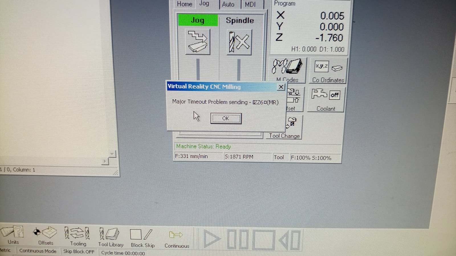

O also get this when the fault happens.

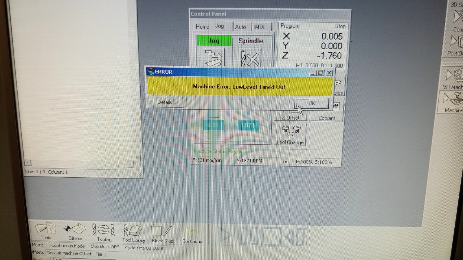

And then this when I click ok.

SGR is spindle go relay so lights when the spindle is running.

The 7 segment display does not go out when it fails. Could the little 2.4V battery cause problems. It had some sort of residue on it. Crystals of some sort. It may have leaked. Nothing went on the 9 pin plug below, I checked that and it clean as a whistle.

The battery isnt needed however it is possible a leak has caused some damage to the tracks of the board. Worth cleaning the board up (you could use some IPA) and inspecting for track damage

Hi the battery has no function on the board and could simply be removed with no ill effect.
The battery can leak acid and cause problems on the board so cleaning around the terminals may have helped.

Next to the 7 segment display or below it in the image higher up the thread showing an L on the display. It's a small NiMH cell.
