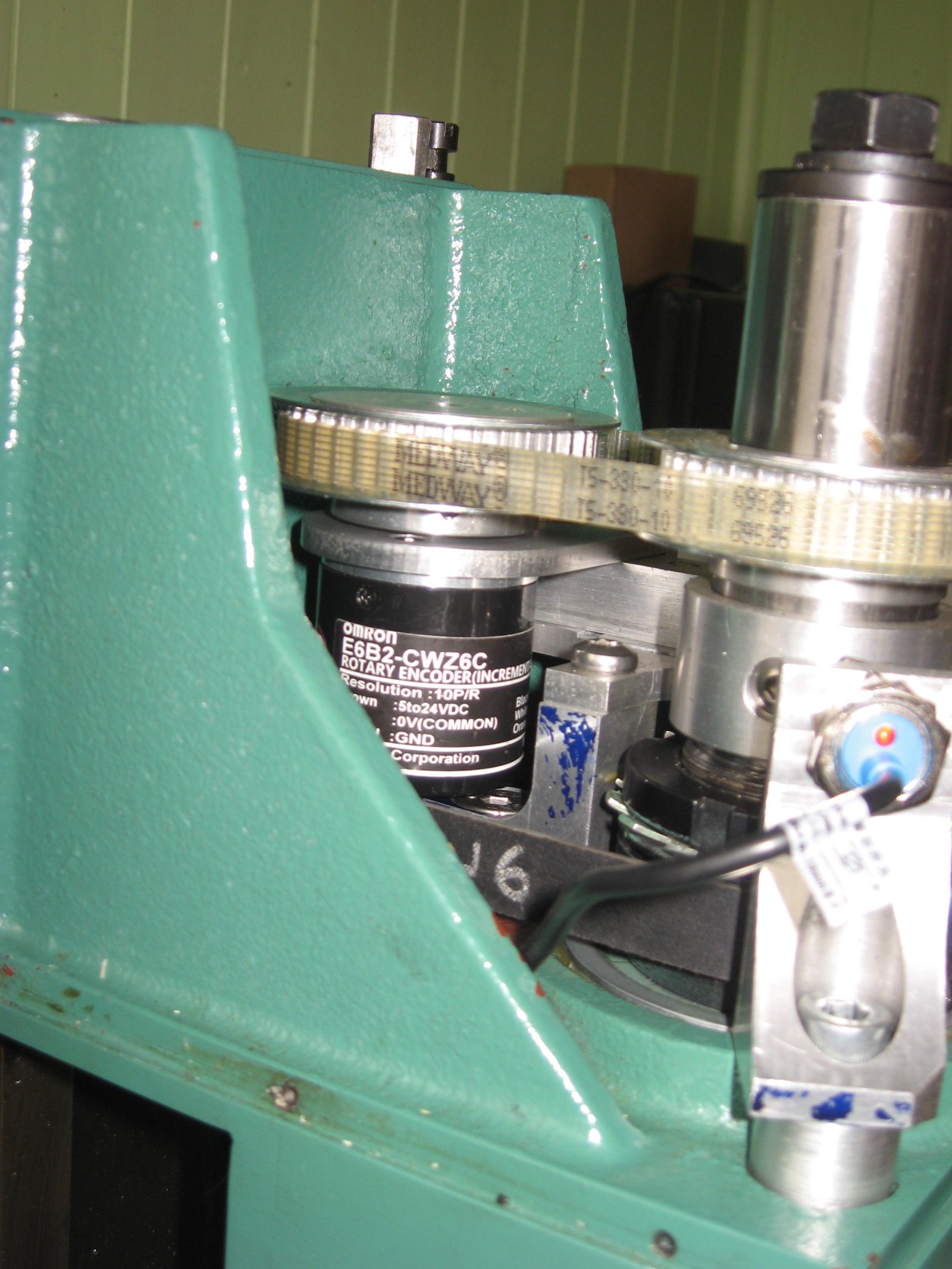

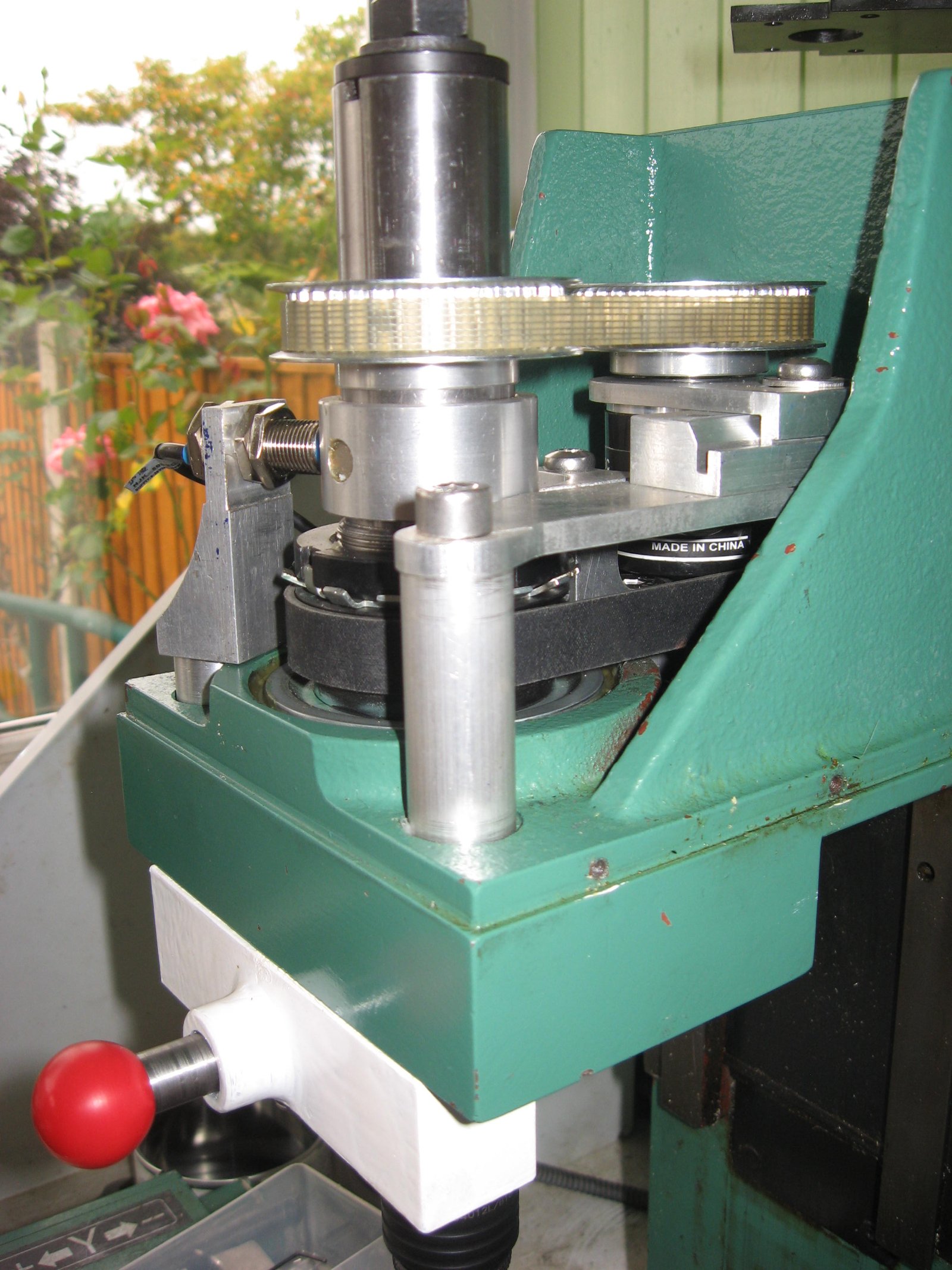

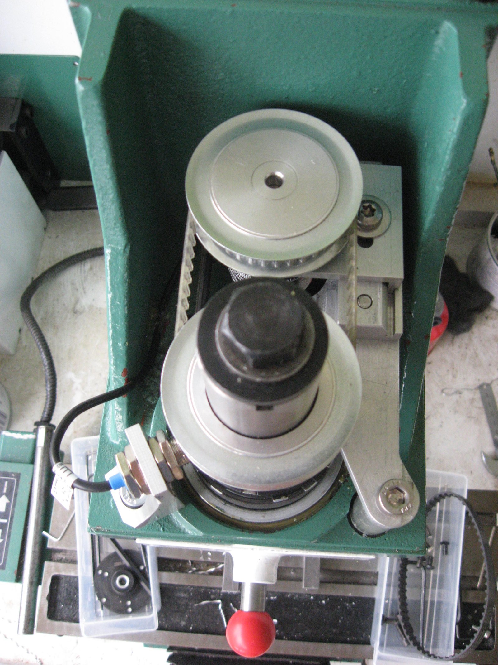

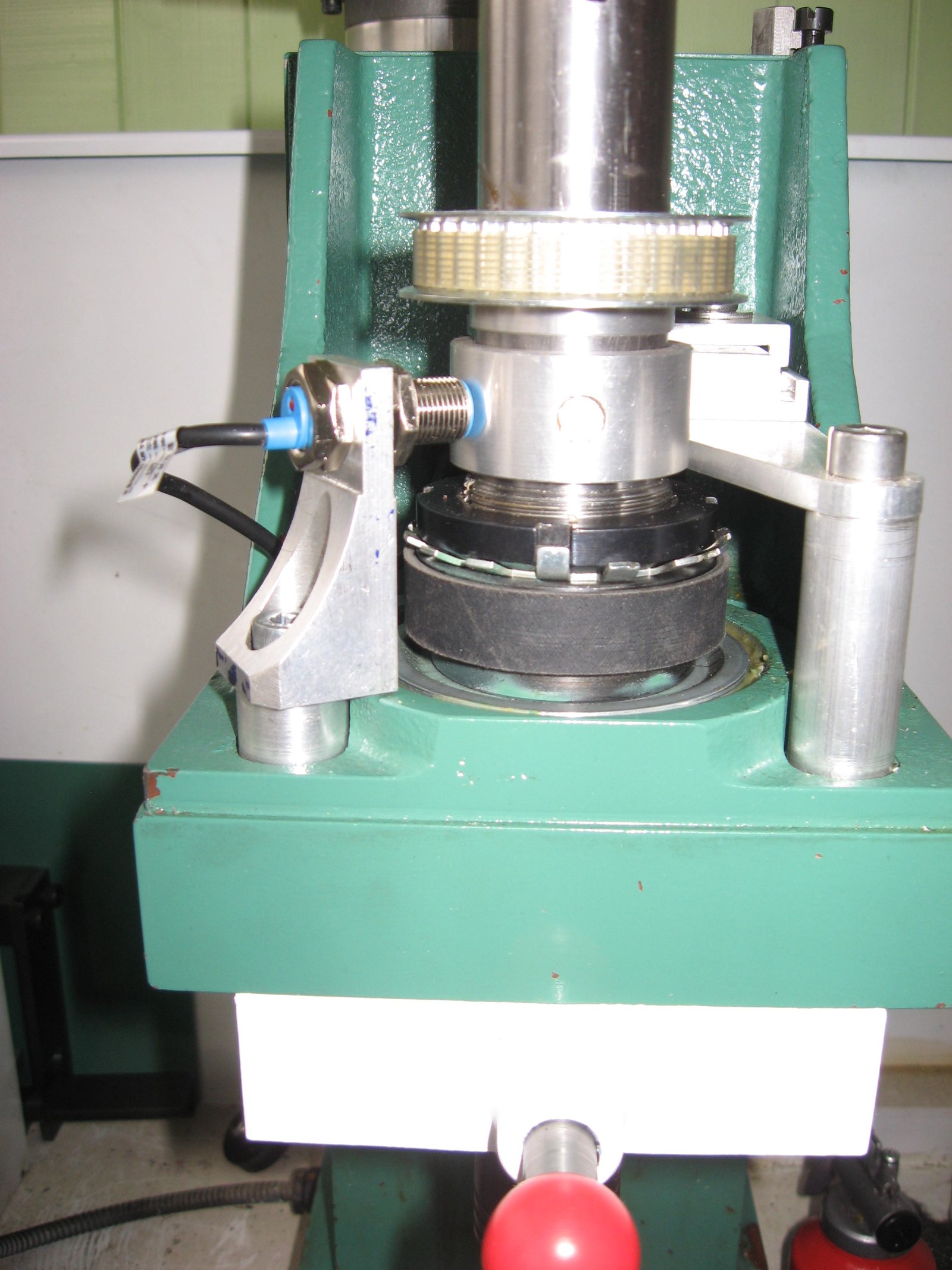

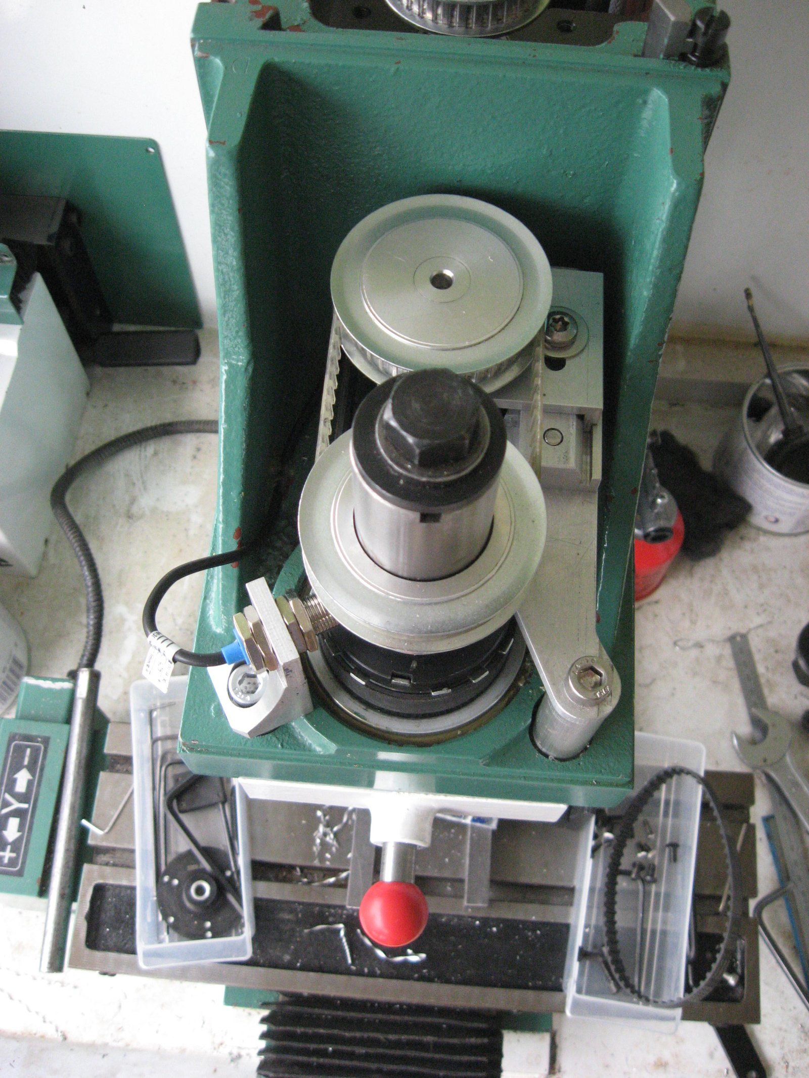

And...has anyone found a way of installing am encoder/index signal on the drive motor? seems a bit tight inside unless there are premade mounting points I can't identify yet.

4)I have installed an encoder, and index on mine, see pictures
