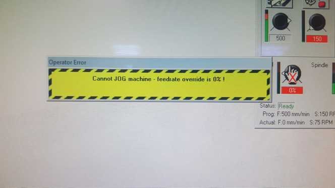

I connect and can home the novamill but as soon as I try jog this pops up. The pots are inactive so cant just turn them up. Can anybody shed any light on it, I must just be overlooking something dead simple?

Does your Novamill have the override pots fitted? They should be on the front next to the Emergency Stop Button.
If you don't have them you can turn the option off in the software.
Goe to Setup then Setup Machine Parameters(Password is denny) then under Novamill go to Machine Capability then untick both Feed & Speed override options. When you exit it will save the values.

No it doesn't have the physical pots on the machine. Will check the parameters. Thank you.
