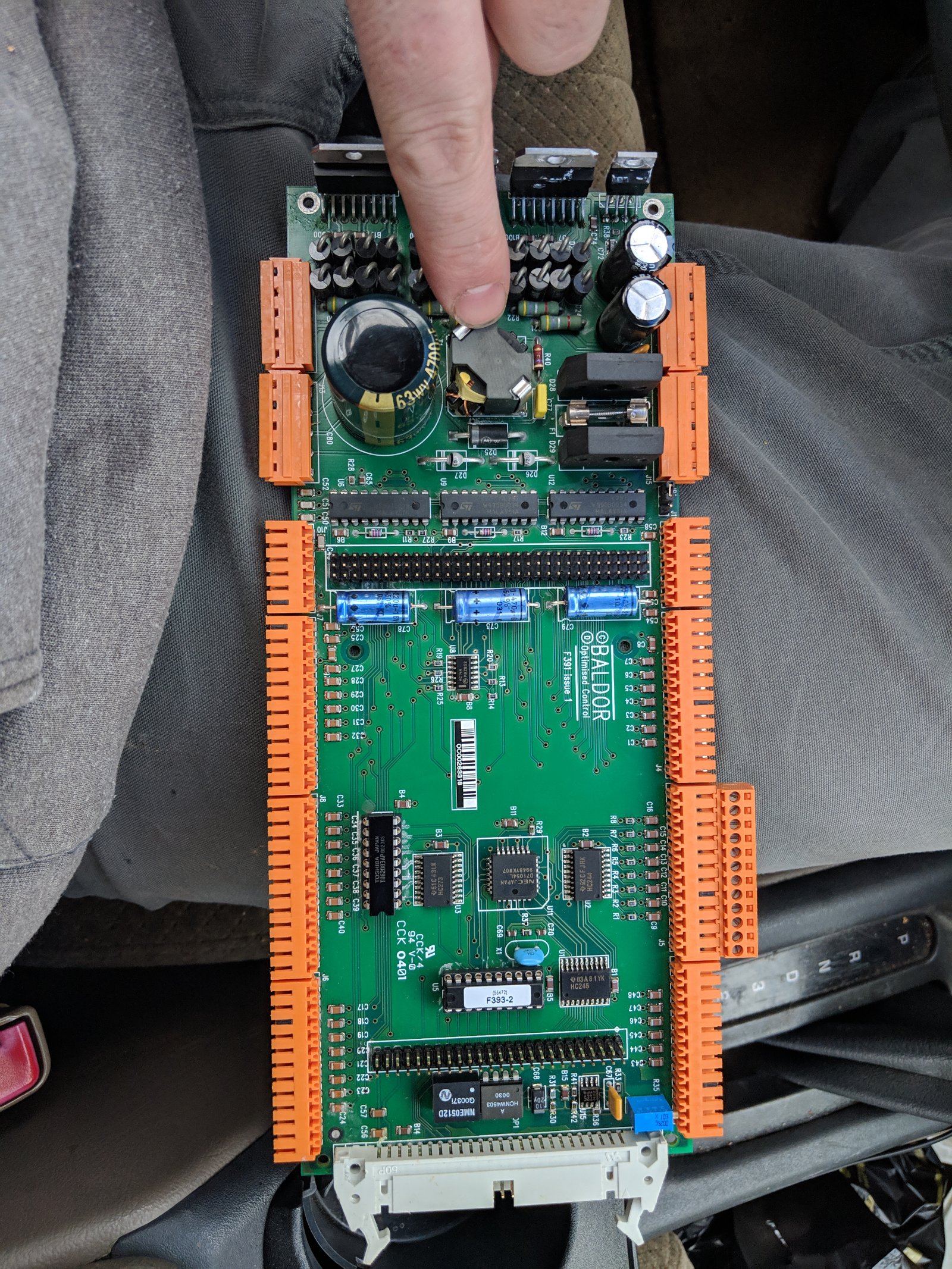

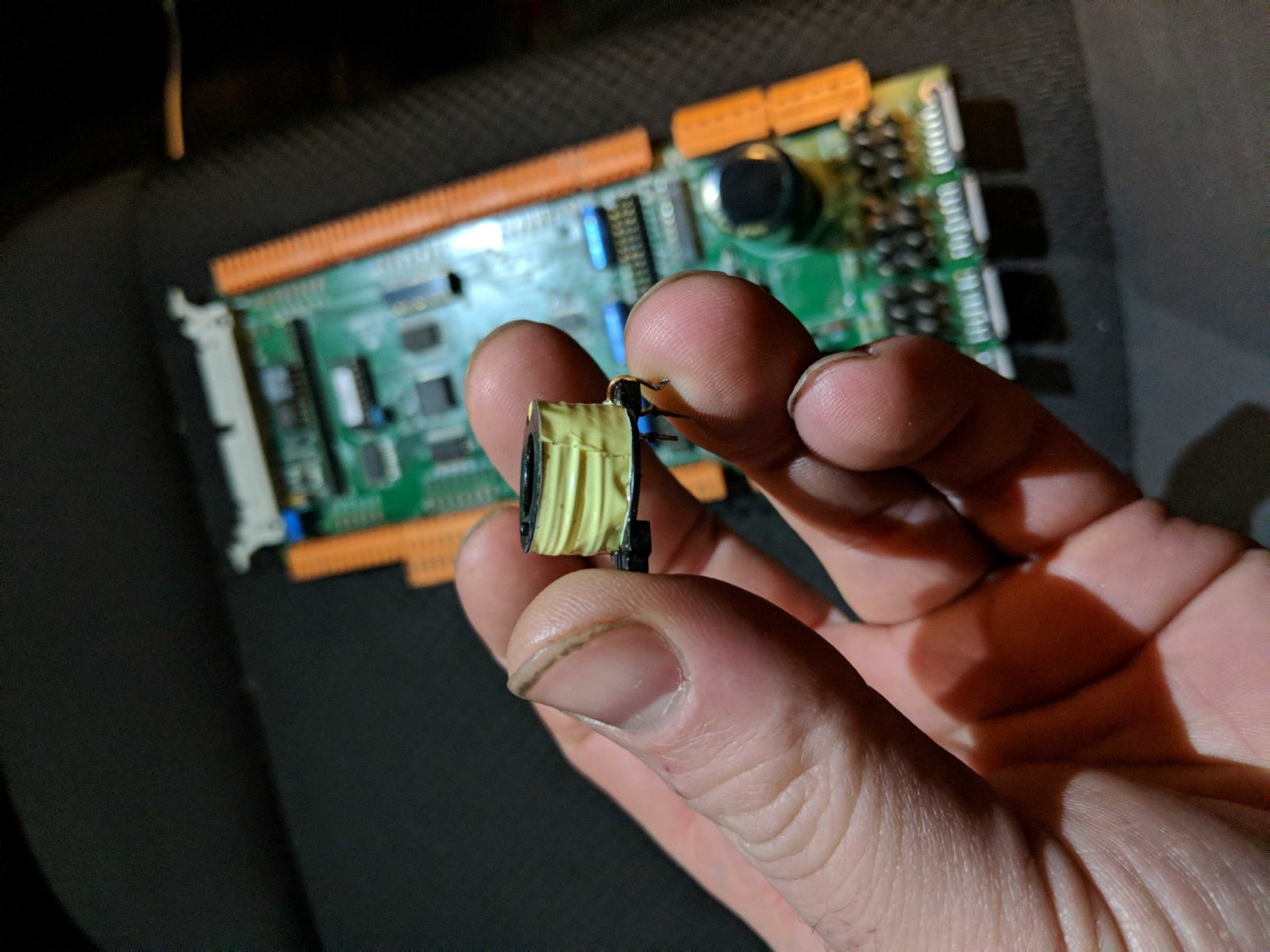

I have a novamill that I have decided to get going using Mach 3. I was able to get the x, y, z axis moving via a din connector on the 96 pin after pulling out the (denstep board) not sure if that's correct. Anyway I had a friend playing around jumping to different things trying to get the spindle going and now I don't have any motion. It looks like a small transformer on the Baldor f391 issue 1 board is bad. I can't seem to find that part. Any help or advice would be greatly appreciated. I'd like to
1. Replace the transformer
2. Replace the Baldor board
3. Go different route with a different motion controller
Not sure what would be best or easiest at this point

I found these two links. Hope it helps you to identify the part.
FERROXCUBE RM8/I-3C85-A250
https://www.enrgtech.co.uk/buy/product/ ... M6S-I-3C85
https://www.tme.eu/en/details/rm8_i-3c8 ... erroxcube/
Hope this helps,
