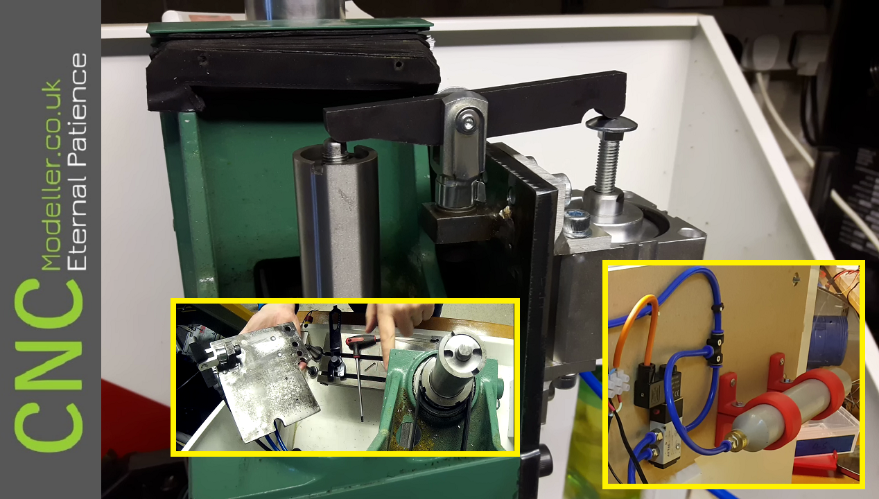

Hi James,
If you are interested in knowing how the power draw-bar works check out my draw-bar upgrade video. You could loosen of the nut at the top of the spring stack and that would release your tool, however beware of loosing the collett balls! If you were really stuck you could replace it with a fixed draw-bar but that'd be tantamount to insanity in my opinion.
https://youtu.be/7pTLxpIFGF4
Personaly I'd just bite the bullet and stump up the money for a silent compressor, I got mine on ebay for less than £100. You don't need much airflow so a small one will do.
You could downgrade to an easy-change, but that'd cost more than your compressor to buy and you'd loose a load of tool clearance.
I've also been working on a reverse engineered carousel so have a good idea of the tool change logic.
If you don't disable the tool-changer in the configuration settings, I suspect that the air pressure sensor wont let you run the machine through a tool change without air available.
Just my 2p hope that helps.
Barry M
Barry M
