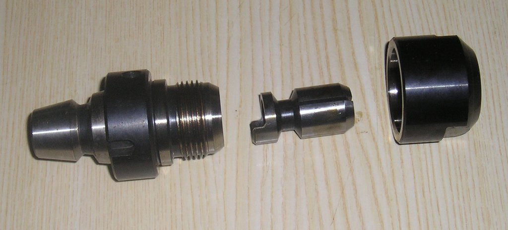

Coventry Engineering make or made a posilock chuck for the Easy Change system but I couldn't see it mentioned on their website. See comments here viewtopic.php?f=47&t=3911 and the attached picture is a shot of one of mine.
Thanks David, after reading you post I searched for some time last night but didnt find anything at all, I think maybe they have gone in favor of the ER collet system. Ive now got myself a couple of Da200 collets 6 and 3mm so i'll be giving the machine a test run tomorrow, excited I have to say!
