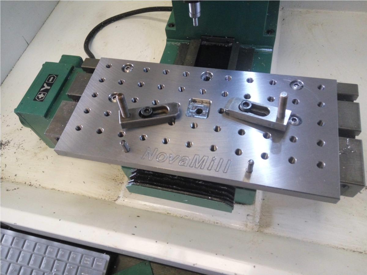

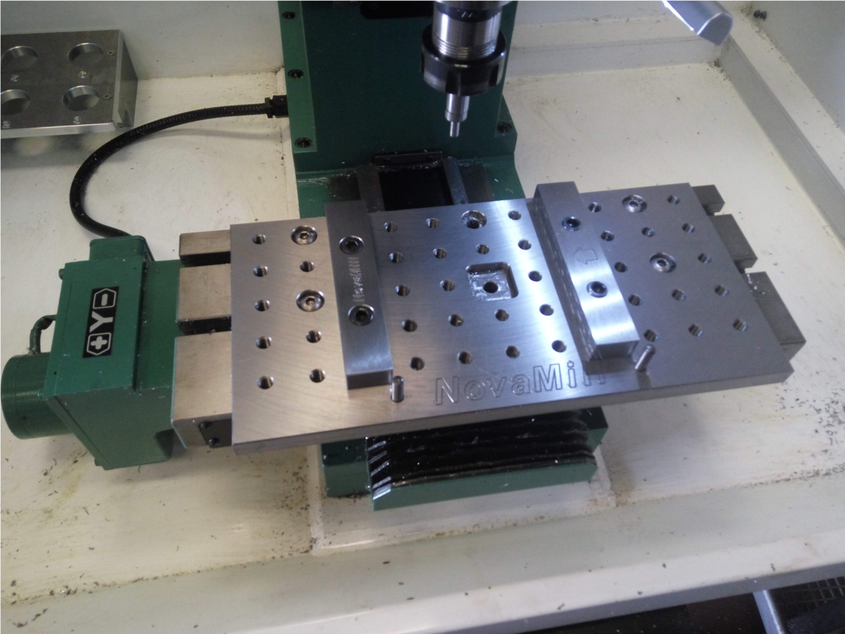

Hi all, just bought myself a Novamill (been looking for one for ages), first thing I noticed is the limited Z travel. I intend to raise the column at some point, in the mean time I was looking for a low profile vice but was unable to find one that matched my needs.
That led to me making my own, a steel bed with a grid of tapped M8 holes, able to take finger clamps from many angles and positions. Also made a pair of vice jaws - one you clamp down tight (and square), the other uses off-centre camhead bolts to close the jaw onto the part (I made these bolts myself). These can be placed at various widths on the bed, see photos attached.

Thanks, just had a look at them. I'd already made this one though and (for my purposes at least) it's much better (lower profile with a wider capacity). I actually have an old vice very similar to the one supplied with the 190, I was using it on the Novamill for a few days before I made the modular vice.

Hi Ben, sorry for the delay. Whereabouts are you? I won't have time to make a new one buty I actually have a spare base plate, with the holes all drilled and tapped. You can have that for nowt, if you want it and I'll give you the drawings/files to make your own jaws.

Hi Jon, yes I'll see if I can upload the files to here for anyone who it might be useful to. Apologies for the big delay, I've been incredibly busy. In the coming days/weeks though I'll be posting some information about several mods I've made to my machine which I believe some may find very useful, stay tuned :wink:
