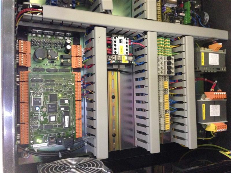

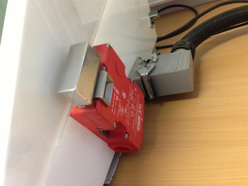

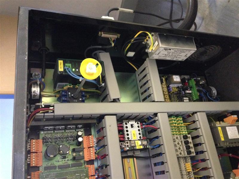

Martin, the 7-segment display is green
I have added some photos which may be of help

Re: Invalid Platform Code
Wow, sorry for the big pictures
Have you updated the Baldor Control card?
You can update it by running EasyUpgrader which is on the VRMilling 5 CD or download it from the Denford website.
