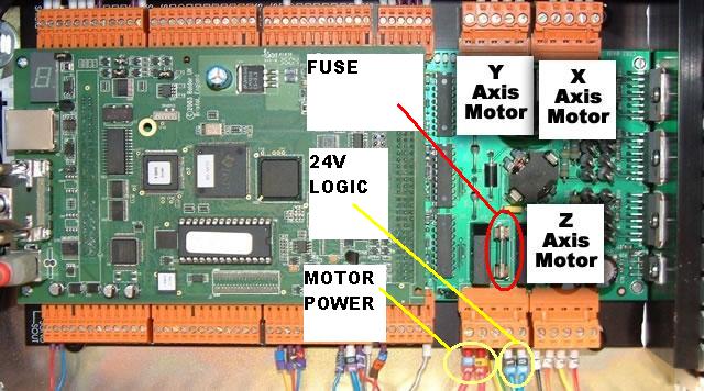

There is a fuse on the control card where the 24V goes into it.
Have you measured the control voltage and motor power into the nextmove.
It may be the motor power is not present. See the attached picture

If the seven segment display is showing an 8 then the 24V supply must be there.
Suggest you remeasure.
Also photos of the electronics would help se we can identify relays etc
I suspect you have the logic supply but the motor power may be missing. Could be E stop button or relay problem.

All three drives are integral on the Baldor base board so depending what fails it could show up on all 3 axis.

Before you go too far,
1. Is the drive voltage present on wire 24 & 26?
2. Is fuse F1 on the baldor card OK?
3. Do the motors energise?

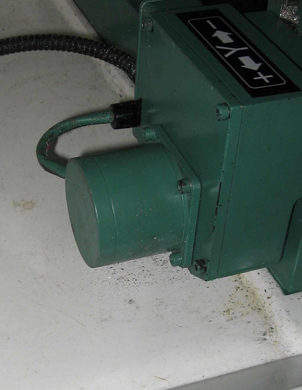

So that I don't do more damage. Just what am I supposed to remove to get at the end of the X-Axis motor shaft?

If you remove the four M4 cap head screws holding the motor plate to the crosslide the stepper motor will lift out. When the machine is powered up & drives enabled the stepper motor should be locked. If you then press the estop button the motor sholud de-energise & turn freely.

Motor is free to turn before and after pressing the e-stop.

Check Fuse F1 again but if it's still the same then it must be the base board.
