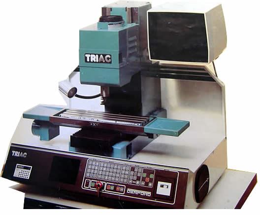

Thanks for all the replies. The machine is like the one listed on this site. It does not have the TV monitor. From what I was told and could inspect, it was hardly used. There were no sign of any rust etc.

Yep - I'd go for the Triac - the casting will be much more rigid... especially if you're fitting servos.
