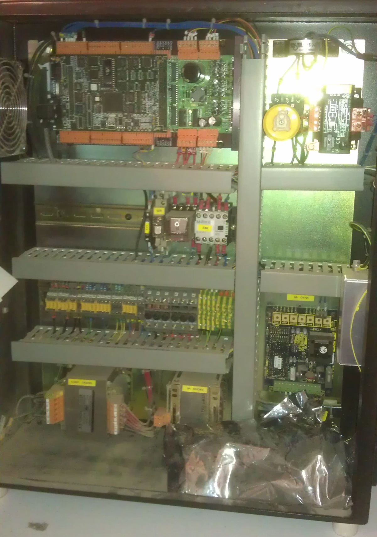

Im not sure which controller i have, is there a way to find out?
At this stage im open to any suggestions although it would be handy for me to get it up and running on mach 3. Ive hopefully attached some images if they are not clear ill take some more,I believe the serial number is 91124G1/2 from jan 2000.

- SERIAL.jpg (502.53 KiB) Viewed 56106 times
- electronics.jpg (420.93 KiB) Viewed 56106 times

Its a Denstep

I'm not sure if you can adapt the Denstep to accept step and direction signals from a breakout board driven from Mach3, but if you can I guess that is ideal. Mach3 I believe cannot directly drive the PC input on the Denstep as this is driven via RS232.
If you need to replace the stepper drivers then you can get the whole package, drivers plus BoB from HK via ebay for around £100. A 36v 11A PSU is around £35, again from ebay.
I have taken this approach (as the Novamill I bought came without electronics) and it worked fine. I did not replace the steppers, they work very well using modern microstep drivers at quite reasonable currents (I use 4.2A drivers set to ~1.5A for X and Y and I think ~2.5A for Z).
Overall I converted the mill for well under £200, and I am very pleased indeed with the result. (I already had the Mach3 licence for my lathe.) Happy to answer any questions, could supply the XML if it helps, photos etc.

Contact Denford - if that EPROM is v2.1 (which it appears to be) you can get a license of V5 milling which will run on XP,win7 and would run the machine fine without any conversion or hassle (famous last words
The only issue being that you'd have to still use a PC with an RS232 port

Seeing your picture of the electronic, it looks easy enough to convert...
All you need in there is the spindle control board (Bottom left corner) and possibly the PSU on the bottom and top left corner mains filter...
Ho... and the big relay to switch the spindle ON and OFF in the middle....
The rest of the electronic can sell on eBay.

I'd say, everything in the black box should still be used, apart from the Baldor control and steppers..
Re: NOVAMILL TO MACH 3 Conversion
You should be able to wire up the BOB to turn on/off the SGR relay...whether the BOB can drive the relay coil directly or not I don't know...you'd have to look at the current draw of the coil and the specs of the BOB outputs (if it has any spare?)ah ok well i was starting to think that id have to use all the bits myself, do you know much about the wiring from the bob im using to the spindle board? does the spindle have a minimum run speed then? i could turn it on and off by ground the sgr, but shouldnt mach 3 be controlling that not a switch i physically have to turn on? maybe im wrong? also does the nove mill have means to measure spindle speed do you know?
There are others on here who know about BOB's and gettting an isolated anlogue signal out of Mach3 - it's not something I've ever seen or used.
There won't be any way of measuring the spindle speed unless there is a tacho on the spindle motor - again no idea if you could interface that to Mach or not
