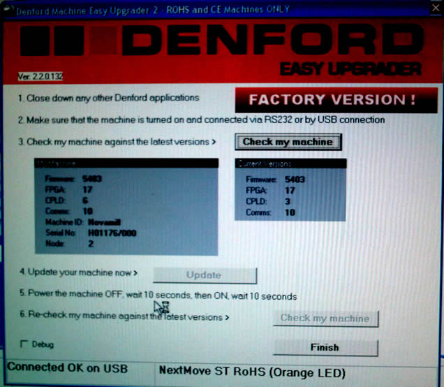

Post by oyoung » Wed 18 Apr , 2012 15:31 pm
Hi - tried easy upgrade, everything checks out (see image)
Also loaded the latest version of VR milling - downloaded today.
Still hangs. It worked for a few minutes, then it got to the point where it would only do 1 line of code at a time before hanging.
Any more thoughts most desperately needed! Thanks

Post by Denford Admin » Wed 18 Apr , 2012 16:04 pm
This sounds like a very old problem we had occasionally with older firmware and early versions of v5 milling. It occurred mostly when electrical noise was causing the PC to resend stuff down the USB because of corruption. The older version of firmware didn't handle it very well and failed to send a "move complete" message so that the PC could send more data.
Make sure V5 milling install is up to date.
Install easyupgrader again from the latest version and double check firmware.
If all this checks out then I'd be tempted to replace the USB cable and/or try another PC.
