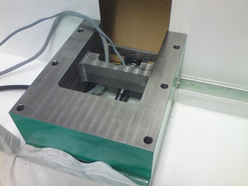

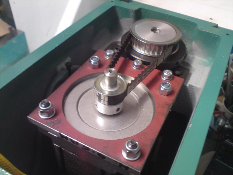

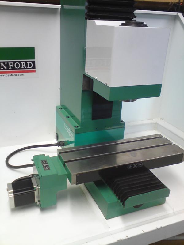

I have had the machine running well for a couple of months now and the results are excellent. I have attached some photos of how I did the conversion.
I took the opportunity of having the machine in bits to add a raising block to the column machined from cast iron (messy stuff!)
The stepper motors were replaced with double stacked nema23 motors on the X and Y and a single stack nema 34 on the Z axis.
I used a complete driver unit sold by Rhonmac CNC, this unit had some issues when it first arrived so enough said there...haha If I did another conversion I have learnt enough to put my only controller together.
- Mill4.JPG (54.83 KiB) Viewed 33544 times

Re: Novamill on Mach3

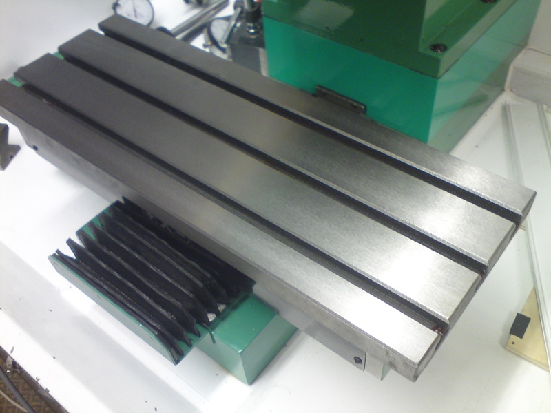

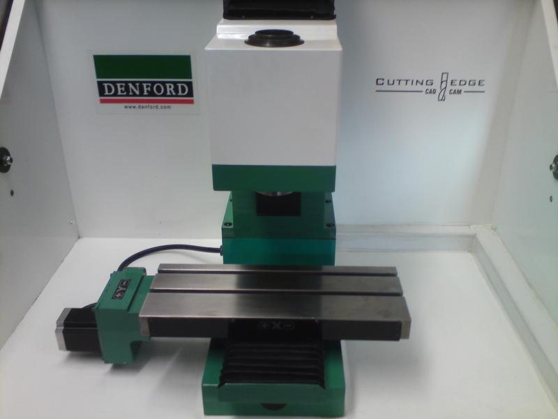

The assembled machine. I bolted a slighlty larger table to the original. This one is sold by Arc Euro Trade for the X2. Fits well and provides 3 T slots rather than the original 2.
- Mill5a.JPG (147.67 KiB) Viewed 33544 times
- Mill5.JPG (64.94 KiB) Viewed 33544 times
- Mill2.JPG (56.3 KiB) Viewed 33544 times
- Mill1.JPG (45.21 KiB) Viewed 33544 times

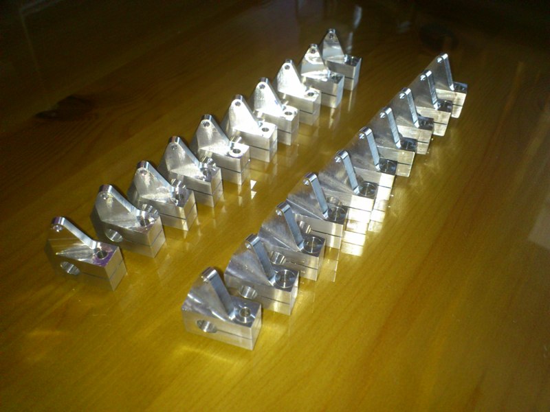

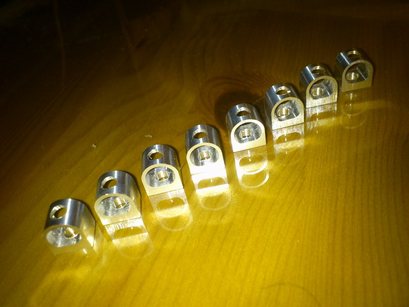

Some machined parts
- mill9.jpg (80.01 KiB) Viewed 33544 times
- Mill8.jpg (77.28 KiB) Viewed 33544 times
- Mill7.jpg (85.28 KiB) Viewed 33544 times
I raised the column up 70mm as this is the distance from the centre of the stepper motor to the mounting holes on the bracket. So by rotating the bracket 180 degrees it looks down (into my new raising block) rather than looking up into the column casting as standard. However, you could make your raising block as large or as little as you like just by making a new bracket to hole the stepper motor and just being carefull to get your belt tension correct. I did need to move the hinge holes on the cabinet as well.
My plan for raising the column was for two reasons, one was the use of the quick change tooling which can eat height quickly and the second was I plan to build a 4th axis for it. I have since found a very nice miniature clarkson tool holder which is very low profile. Similar low profile collet holders are on ebay at the moment.
- Mill3.JPG (66.46 KiB) Viewed 33523 times
