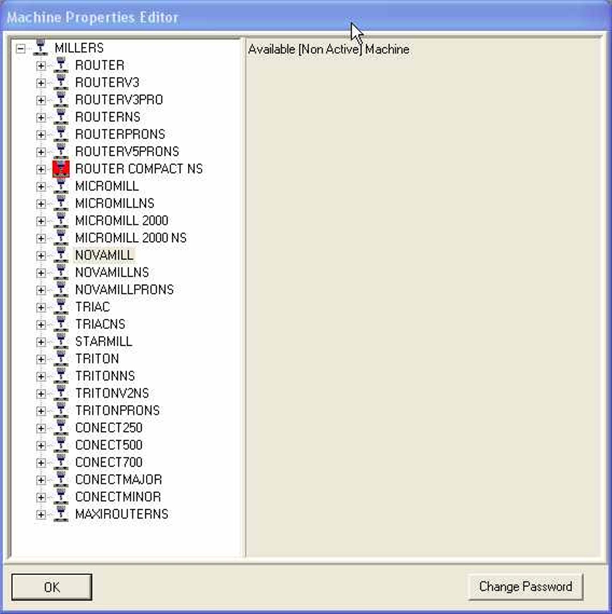

I have upgraded to 2.31 software recommended by denford now it gets to 66% on locating mint on com 1 any suggestions?
Also when I go to select the machine the Novamill is not an option.
Post by Steve » Fri 11 Jan , 2008 17:52 pm

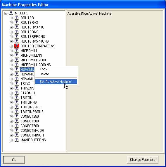

Go to setup machine paramiters.
Then type the password "denny"
See the attached screens that show the machine choices in VR Milling.
Select NovaMill (Not NS) :!:
The right click and make the machien active.

Post by Steve » Tue 15 Jan , 2008 18:16 pm
Having just spoken with you your machine is now up and running! :D
