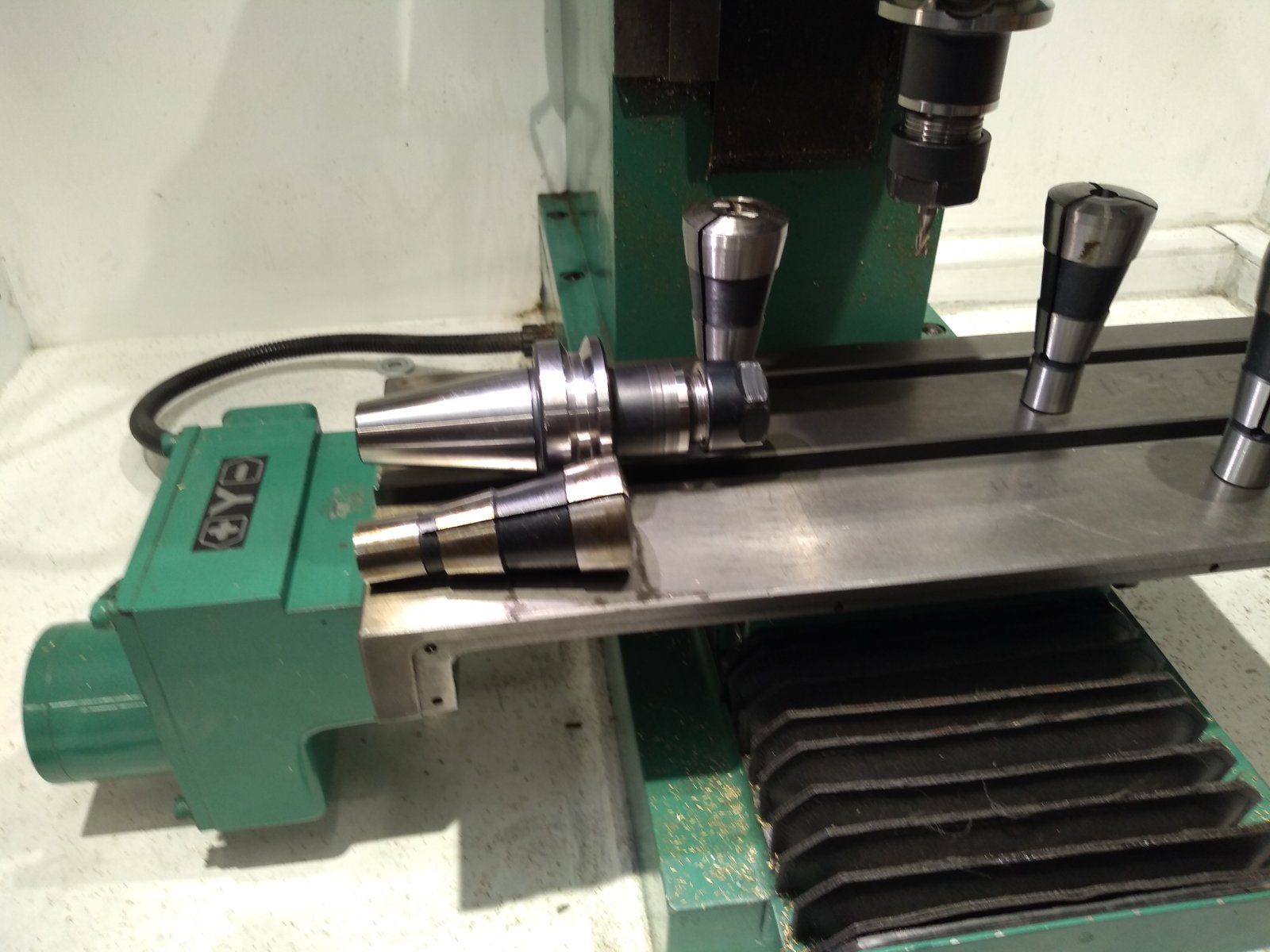

A possible alternative approach, though it gives less benefit, is to use finger collets direct in the spindle. I bought a set of these from China, they effectively give an extra 50mm daylight.
