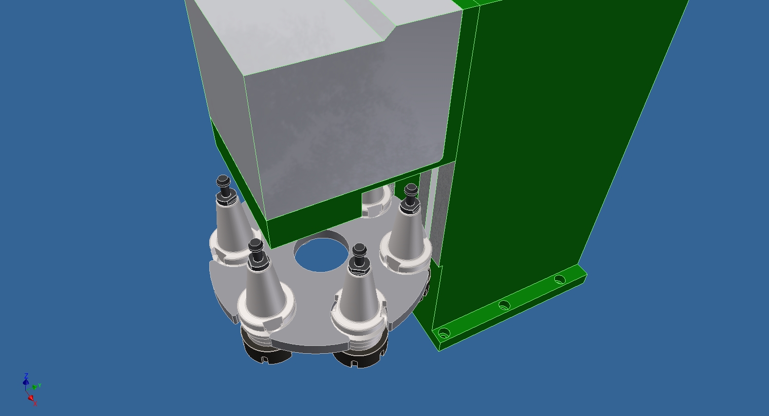

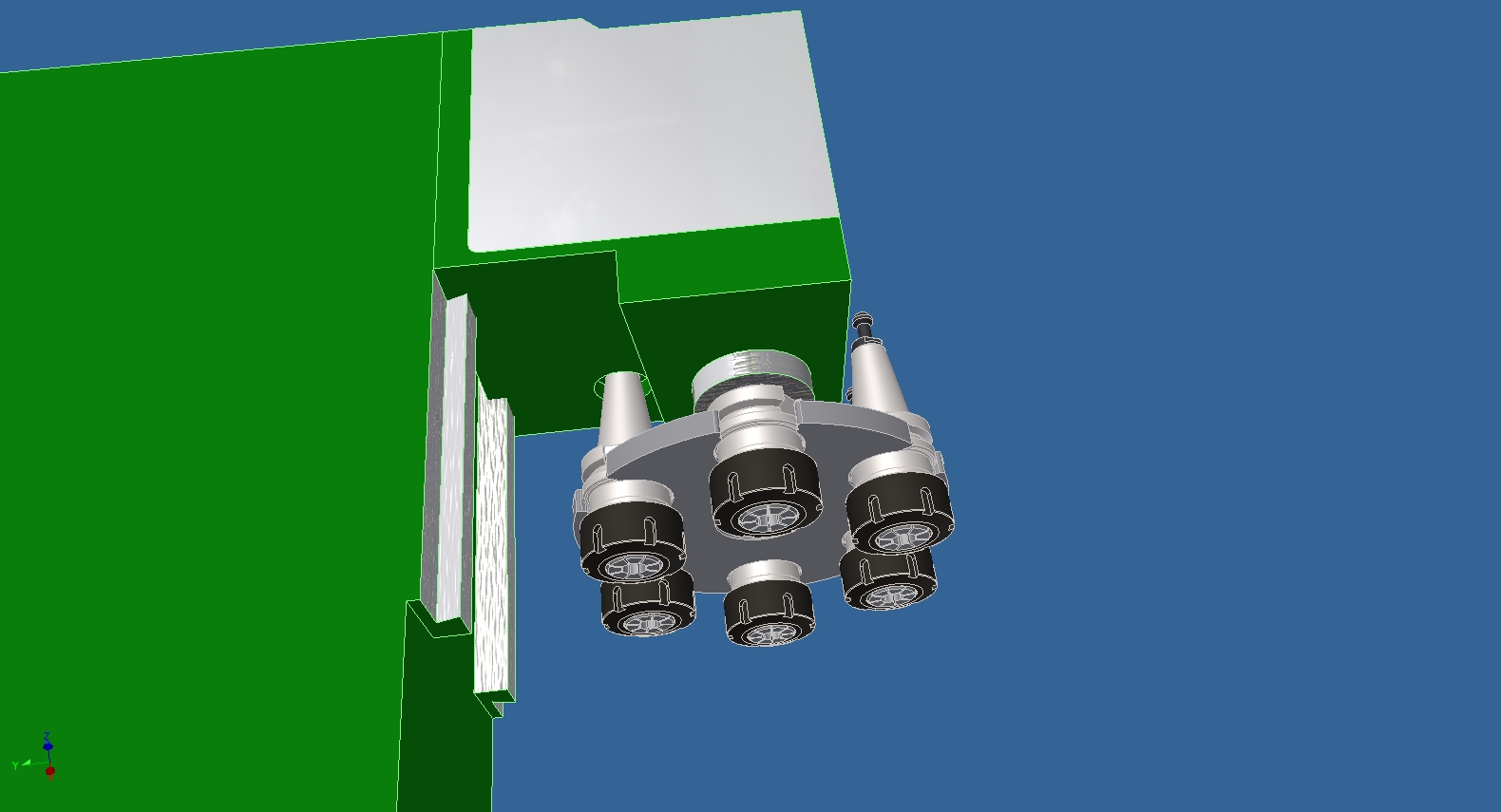

Post by MortenL » Thu 22 Oct , 2015 19:00 pm
I can't be triac atc style, as you can see in the pictures the tool carousel uses the hole underneath the milling head for the next Tool, so it's impossible for the carousel to go sideways until the head has moved up or the carousel down...
It can still be the carousel that moves up & Down instead of the head...
/Morten

jonnydeen
Posts: 47
Joined: Tue 09 Jul , 2013 20:45 pm
Hardware/Software: 1996 Novamill, linuxcnc
1986 Triac PNC, linuxcnc
1989 Senior 3c, Heidenhain TNC155
Re: novamill atc retrofit
Post by jonnydeen » Sat 28 Nov , 2015 19:02 pm
nice model mortenl, fancy sharing?
it could be done in the triac style, would need to be fairly humongous though. don't write it off just yet, it could still be a possibility.
