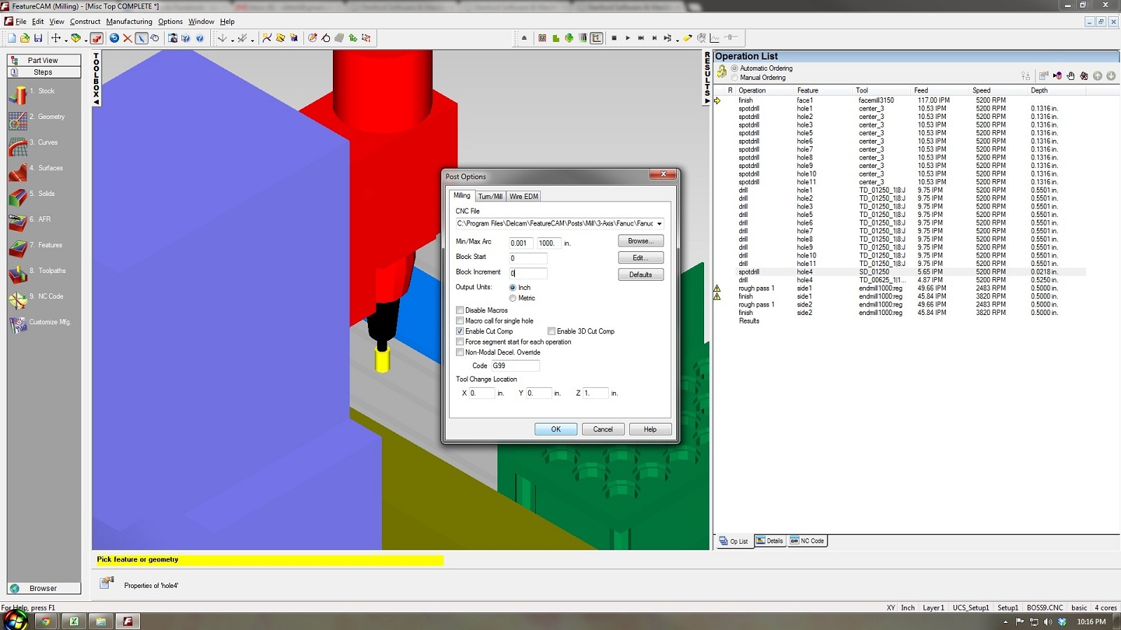

Hello my name is Zack. I am a student and our university has a denford novamill that no one has used in years. It has a denstep controller and the V2 milling software. I am wondering what post processor I can use to output gcode from featurecam to work in the VR milling software.
This should be possible am I correct? I see a lot of people doing conversions to mach3 as their control software what benefit does this have? Just the ability of a more attainable newer software?
I have tried the fanuc m0 post processor to no avail so I am wondering if anyone can help me out.
Example gcode using the Fanuc 0M post processor.
errors on 4 line because of too many codes on a single line
then every so often wants file 9099.fnc or 1011.fnc to be in the same folder and i have no clue what this file even is.
it also likes to complain about bad arc end points which i am just going to assume is because i have the settings in the screen shot wrong.

I would really love to use this machine but it needs to accept gcode created from my inventor parts.
Also can anyone recommend any readings on the basics of CNCing. Such as setting up tool offsets and how to set up the reference point and stuff.
Screenshot of Post processor

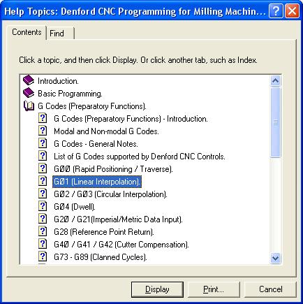

As for help, start with the Help menu in VR Milling v2...it will be worth downloading the latest version from here:
https://website.denford.ltd.uk/index.php ... -downloads
You could open the .zip file and just view the help files eg, Mill.hlp

Some things to try:
1. Make sure the output is metric with 3 decimal places (eg 25.400)
2. Disable macros - this should get rid of the errors where it's looking for program 9099.fnc
3. Definately turn off cutter comp - let the CAM output compensate for cutter diameter as VR Milling 2 will more than likely not do it the same as intended.
If you are then only left with errors about too many g-codes, then you may have to live with that, just edit the program and insert a new line between the list of codes...
G00 G17 G40 G49 G80 G94
becomes:
G00 G17 G40
G49 G80 G94
