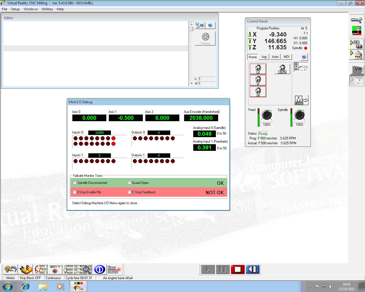

Pressing 'escape' doesn't work.
Up to 450 works, 550 and above doesn't.
Input 7 is lit up all the time (along with input 15) it doesn't change state at all.
See screenshot below.
