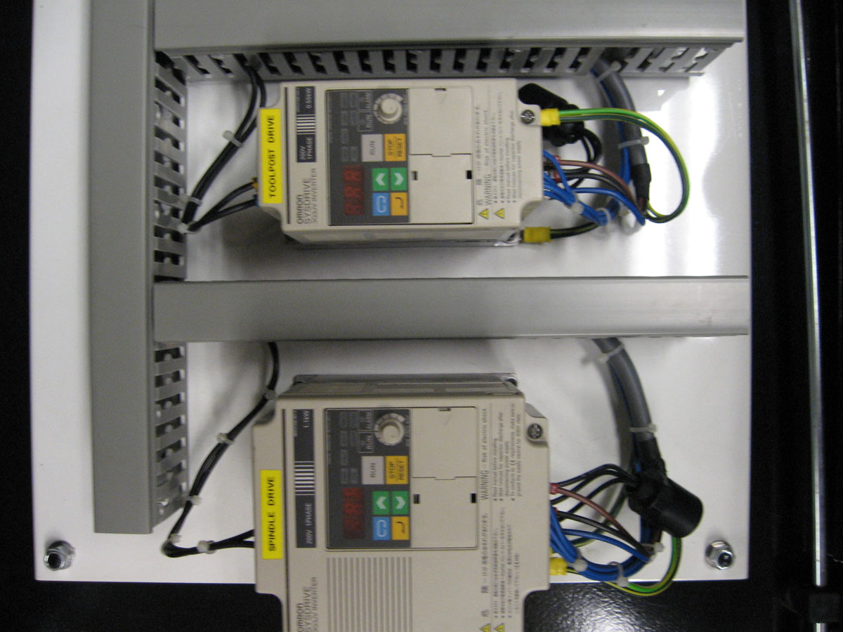

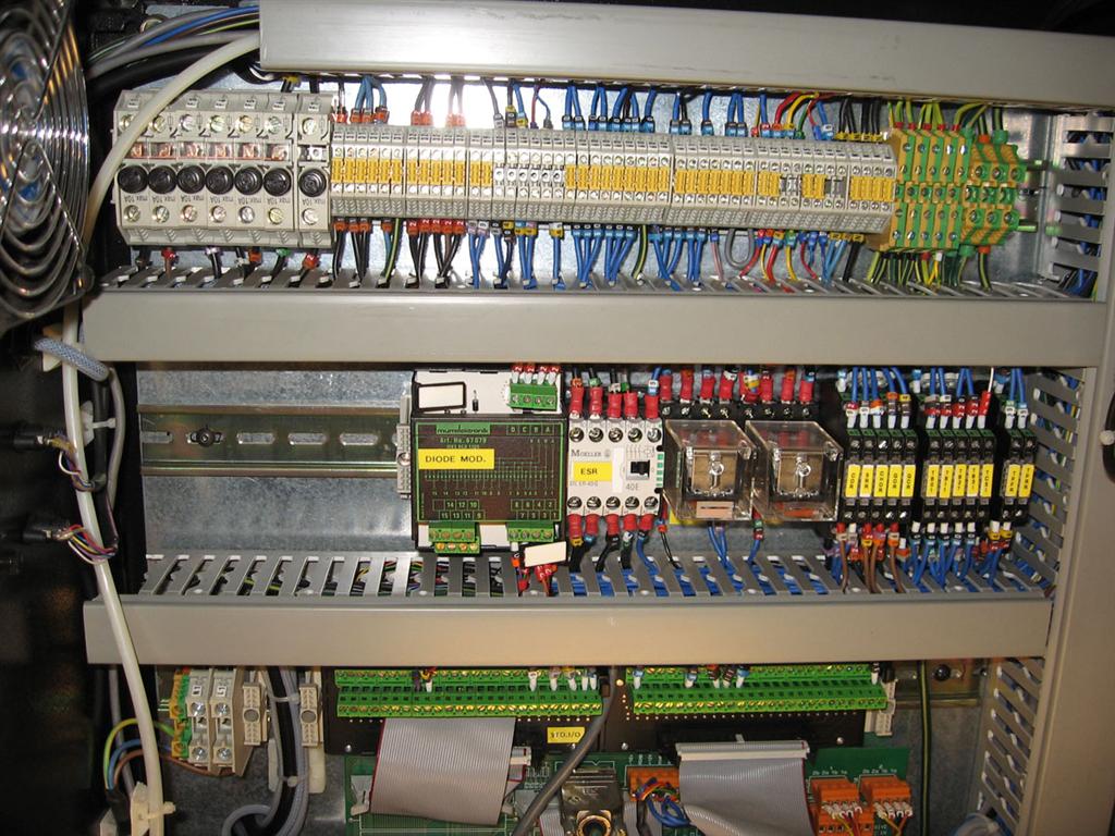

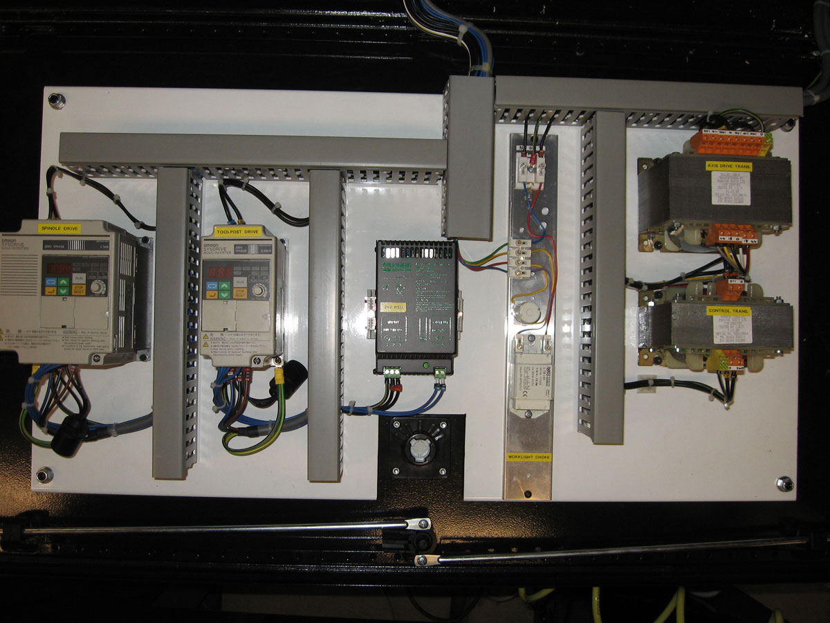

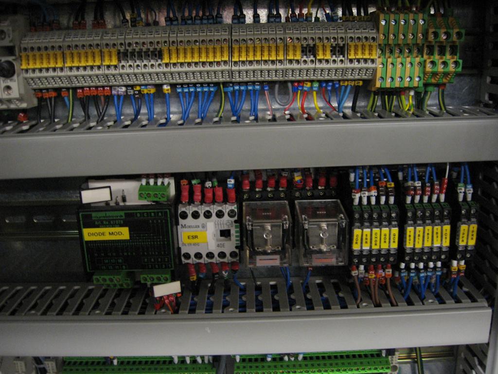

CalU MIRAC Photos.
I have some wiring diagrams here in Medina, not sure if there for this MIRAC, they could be faxed.
- controls1.jpg (154.86 KiB) Viewed 20230 times
- controls2.jpg (174.24 KiB) Viewed 20230 times
- controls3.jpg (161.66 KiB) Viewed 20230 times
- controls4.jpg (117.74 KiB) Viewed 20230 times

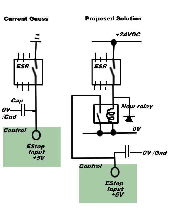

That is a very similar layout to the problem I saw on a old Triac before.
The Emergency stop signal looks like it is going through the white Moeller ESR contactor - probably the thin red wire at the top, blue at the bottom. Either the red or the blue will go down to the green terminal block.
I think the problem is down to the fact that its using a big old contacts to switch the 5V signal to the control, and that these wires are located right next to the other ESR contacts which are switching the suppply to the spindle.
If I remember correctly, I had to wire up another smaller relay (a quality one with low voltage contacts) to be driven from the ESR contactor, then use this new relay to switch the 5V ESR feedback into the control. (this new relay wants to have a higher coil operating voltage - choose either 24VDC or 110VAC)
See attached "sketch" of what I think will fix the problem...
Please double check I have got the input voltages and relay wiring the correct way round as I have done this blind
- estop-relay-noise-fix.gif (21.22 KiB) Viewed 20227 times
The E-stop relay shown has a 24v coil so the diagram shown is not the solution.
I think the diagnosis you have that the problem is related to the spindle is correct.
The E-stop relay feeds the controller input with a Normally open signal that closes as the E-Stop is released.
It is possible that the low current input signal to the microprocessor is intermittant as the E-Stop relar is a power device and is designed for higher current signals.
Taking the signal to the microprocessor direct from the E-Stop button would be one solution. You could try fitting a new E-stop relay which would have newer and cleaner contacts.
The other option could be electrical noise from the spindle drive causing a false trigger to the E-Stop input.
If the spindle motor has demagnetised the spindle will run overspeed and at higher currents than when initially supplied. This can cause arcing on the brushes and create electrical noise.
1 I would suggesst you run the spindle at top speed and check the drive output and actual speed.
2 If the Motor is running at a higher speed than it should or the output voltage is higher than the motor rating then the motor should be replaced.
3 Try to link out the E-Stop input to the processor and try running the spindle then check to see if you still get the E-stop message. If not this proves it is either the E-stop relay of electrical noise.
4 If it does not trip wire a link over the same input but on the E-stop relay and run the spindle again. I the E-stop trip message comes up then the problem is in the wire routing of the E-stop signal or the spindle motor is generating noise.
5 Replaceing the E-Stop contactor would rule this out and leave only the motor or wire routing.

Perhaps the drawing was a bit misleading - I'm trying to show a new relay being driven from the contact that currently goes to the estop input - nothing will change with the wiring to the original 24v coilThe E-stop relay shown has a 24v coil so the diagram shown is not the solution
ie, remove the thin ESTOP feedback wires on the old contactor, and use that contact (now spare) to energise / de-engergise a new relay with low voltage contacts
I'm sure this would be a better and longer lasting solution, than replacing the current ESR contactor with a new one, which may again develop the same problems
