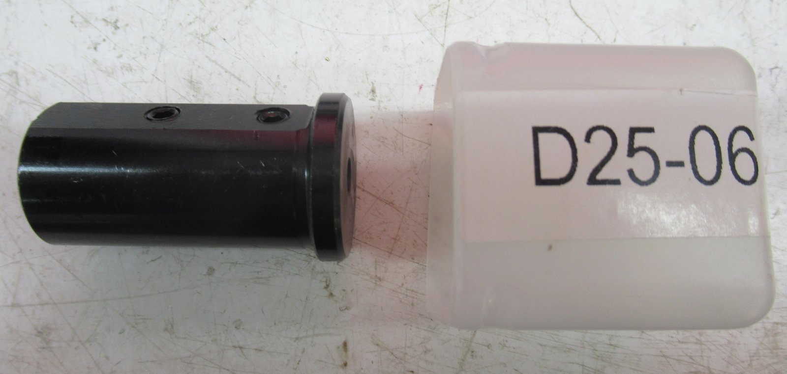

Odd that they should all be missing. Give me a few days and I'll produce some kind of drawing for you. Most of the details can probably be worked out from the holes in the turret though. They're used in conjunction with D25 round tool holders.
