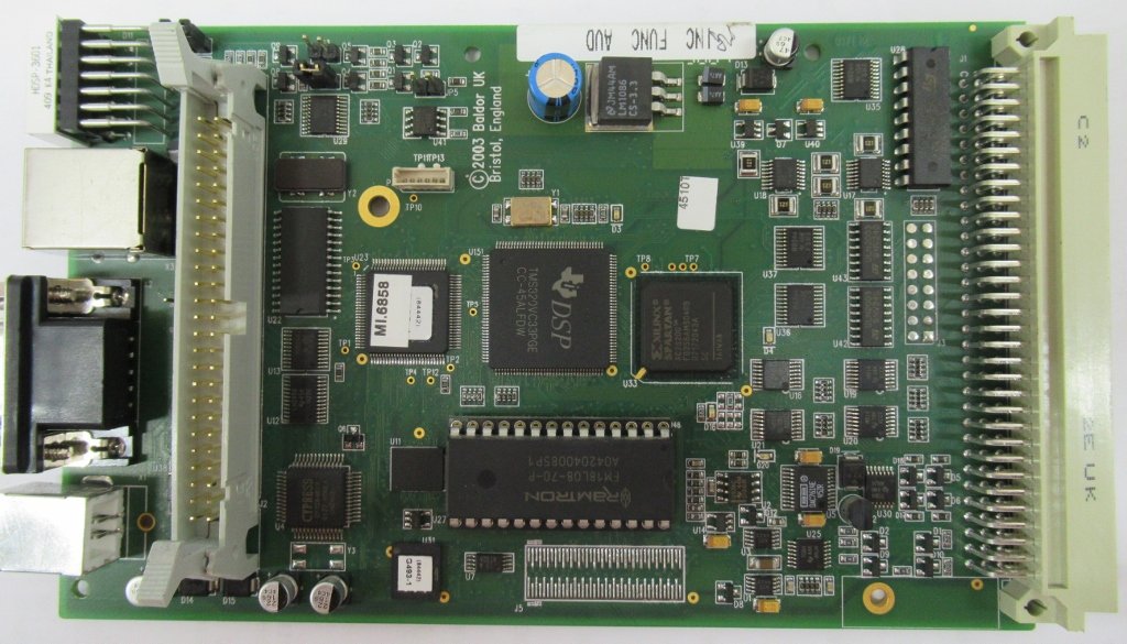

- Posts: 158
Re: Mirac homing problems after USB upgrade.
As the control card came from a Triac it occurred to me that it might be loaded with the wrong firmware etc. for a Mirac?
Easy Upgrader 2 is apparently for ROHS and CE machines only? Is there an earlier version of Upgrader I should be using?
If Easy Upgrader 2 is correct should I be selecting Next Move ST RS232 and USB, or Next Move ST USB Old Green LED with CE updates 2011?
I think my control card is around 20 years old. It has a green seven segment display, RS232, USB and CanBus ports. Baldor/ABB designation NES003-501.
As long as EasyUpgrader reports that it is up to date that all you need to check.
- Posts: 158
The controller isn't in the machine at present, but IIRC I can force either version of firmware on to it and Easy Upgrader 2 will report that it's up to date.
5331 Next Move ST RS232 and USB
5414 Next Move ST USB Old Green LED with CE updates.
I'd assumed that Easy Upgrader 2 read the controller ID number from the controller and loaded firmware etc. applicable to that type of controller?
To quote the notes file:
"Easyupgrader2 is a 2007 project
file name format and what it means:
eg, 5216.firmware.2
First number is version (5216)
Then a dot (.)
Next is the type of file (firmware,cpld,fpga,comms)
Then the Controller ID number (0-3)
0: NST001 with old bootloader (only works up to 5035 firmware but can be updated by Baldor
1: NST001 none USB card but will run all the latest firmware (hopefully)
2: NST002 USB nextmove ST
3: NSB - Nextmove ESB (servo machines)
4: NST002 USB Nextmove RoHS (Orange LED)
5: NST002 USB Nextmove RoHS and 2009CE Machine Updates
6: NextMove ST (Older Green LED) with CE updates 2011
The software looks at say the firmware version on the control, and if the file (eg,5216) number is higher, will update the control"
As the controller PCB is copyright 2003 I'm leaning towards its ID number being 2.
When forcing the firmware I'm asked to choose a machine type and only "Mirac" is available. That leads an error message when using Mirac NS files, but I can get rid of that by specifying the machine type as unknown.
Easy Upgrader 2 returns a machine ID of H60616/ ? Can that be tied to a particular machine type and date of manufacture?
Max.
The Mirac will need the non CE firmware installing.
VR Turning does not look at the machine type so it shoud be set to Unknown.
