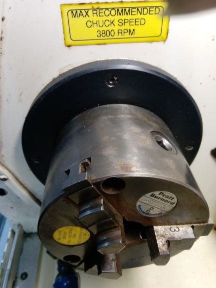

In the case of my machine the maximum speed parameter was set to 5000 RPM, but the VFD was set up so that 10VDC corresponded with 3870 RPM.
Given that the maximum speed for the chuck is 3800 RPM I set the maximum speed parameter to 3800 RPM, but I will change this to 3870 RPM to give a slight improvement to the scaling.
The fact that the VFD was set for 3800 RPM cannot be a coincidence. Most likely it was set at the factory, but the maximum speed parameter was left at 5000 in error. Or given that this machine came from a school, the staff there changed the VFD setting to foil any attempt by students to overspeed the chuck, but neglected to change the maximum speed parameter.

I think there must be different Chucks Fitted, I'm sure mine is a 'super Precision' and good for 5000rpm, My machine is also an older one with the 6 position tool, holder. The control card is the Syntel GSM? version.
I got the software from the Denford web site and the default was set to 5000 rpm. And had to replace the internal PC. But if the required max speed was lower, then the 0-10V scaling and max frequency would have to scale accordingly. The bigger problem I had was the ramp rate of the frequency for the tool changer and the slight variation in spindle speed for value less than about 2000 rpm.
