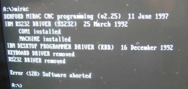

I have a Mirac, not the PC version, which has never worked whilst in my possession.

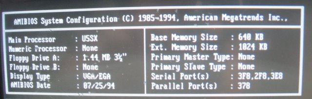

At switch on the built in PC's BIOS shows that there are three com ports, which is correct.
If I run the Mirac DOS software, as downloaded from this site, it aborts with error 128 after installing or perhaps attempting to install the keyboard drivers. Does anyone know what causes this? Error 128 seems to be all embracing and is also reported if the drivers are not present on the installation disc. If the PC couldn't talk to the Eurocard wouldn't I see error 50?

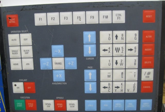

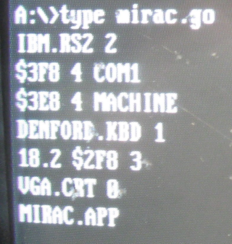

Does my mirac.go file specify the correct keyboard driver? The machine has a built in mirac 1451 keyboard, not a tutor keyboard. I get the same error message if I edit the mirac.go file to use the denford1.kbd driver.
Any help gratefully received.
Max.

Hi Ive just been hunting back through posts as I had this issue with a Starturn, it was a coms port error (in the end TX/RX lines in lead needed flipping over for me) BUT the 128 error and then it removing the drivers is just and indication it couldn't talk to the machine so it stops loading it all.
This is a GO file I have used for the starturn on 1 com port and the desktop tutor keyboard on the other
IBM.RS2 1 (calls for 1 com port)
$2F8 3 MACHINE (com port for machine)
DENFORD1.KBD 1 (calls for the type of keyboard)
18.2 $3F8 4 (sets the keyboad com port)
VGA.CRT 0 (calls the graphics type)
FANUCMD.APP (is the APP file to run the machine)
Looking at your GO file, Im not 100% why it is calling 2 RS233 ports as I run the machine and the 'desktop tutor keyboard' desktop version of the keyboard you have
This is a go file from a 1992 Mirac the full thread is here viewtopic.php?f=40&t=4843&p=19091&hilit=128#p19091
IBM.RS2 2 (this calls for 2 RS232 ports like your seems to be calling)
$3F8 4 COM1 (this com port and the machine com port are the same $3F8 on IRQ 4 where as yours seem to be set to $3F8 4 and $3E8 4)
$3F8 4 MACHINE (So not sure why your GO file is calling for 2 com ports. I wonder if this is the issue? I would check what is plugged where)
DENFORD.KBD 1
18.2 $3E8 5
HVGA.CRT 0
flstep.app
Martin has responded that it should be a MIRAC and not an FLStep .app (which the owner changed) but the call for the coms port seemed to work for the owner. As long as you have those set for the com port you have the machine plugged into you should be fine.
So from looking at the above I would go through and just check you have the com ports configured correctly in the GO file. I can only presume as the PC is built in to the machine that the cables will all be plugged in where they should be.

The reason two com ports are installed by my .go file is that one was used for a serial printer. This is no longer connected, so I suppose I could edit the .go file to only install the com port for the MACHINE.
The 1992 .go file specifies two com ports as using the same address range ie $3F8 which I'd say is clearly wrong. I believe this has been mentioned before. If the file actually works I'd say that the first com port designated COM1 is being overwritten and specified as MACHINE.

the only thing I can think of then is that as you said you dloaded the software from Denford recently could it be just a case of the GO file is calling the wrong port, with 3 being on board, my GO files calls $2F8 3, The one in the thread calls $3F8 4 and yours calls $3E8 4, so that shows little consistency in settings. I love to hate rs232. Do you have a test dongle? I was fortunate to not bin mine back in the 90's very useful. They used to be pennies, now hard to get hold of. I did loose the one I had with jumpers so you could quickly swap pins over.
https://www.ebay.com/itm/RS232-DB25-Mal ... 0611673913

These are the Flstep.opt & Flstep.go files that it went out with.
It was tested with the Flstep software.
MIRAC PENSNETT 60212G 26/03/96
AUTOERROR 0
DRAGMARKING 0
DISPLAYSIZE 3
NARROWSIMBOX 0
utils_menu_1 Dos Access
utils_go_1 dos
utils_menu_2 Turning Designer
utils_go_2 ldesign
mirac_sdevice machine
SRAMDRIVE 3
SHOWTOOL 0
safespindle 150
slave_encoder 2000
SLAVE_SPINDLEF 0.85
SLAVE_SPINDLELAG 35
lowspindle 100
highspindle 5000
mint_mfact 200
CHUCKCENTREX 10
moverangex 85
machineextentx 100
moverangez 146
machineextentz 210.0
SLAVE_ACCEL 120
HIGHFEED 3000
HIGHFEEDZ 3000
SLAVE_XDATUMFEED 1500
SLAVE_ZDATUMFEED 1500
SLAVE_ATC 2
mintool 1
MAXTOOL 8
SLAVE_PCHUCK 1
NOAIR 0
slave_thread 1
datumorder 1
SLAVE_IO 1
IBM.RS2 1
$3E8 4 MACHINE
DENFORD.KBD 1
18.2 $2F8 3
VGA.CRT 0
FLSTEP.APP

SUCCESS!! I M A HAPPY MAN!!
The problem was down to the way I was trying to run the software. What I had to do in the end was this:-
Create an MS-DOS Start up disc using a Windows XP PC. It's an option in the format menu.
Delete all the files from the disc with the exception of IO.SYS, MSDOS.SYS and COMMAND.COM. This is the minimum set of files needed to run DOS.
Unzip the file DRIVERS and copy the drivers to the disc. Don't just copy the folder
Unzip the file DRIVERS2 and copy the drivers to the disc. Don't just copy the folder. This overwrites some of the drivers from DRIVERS.
Unzip the FLSTEP files. Copy the files FLSTEP.APP, FLSTEP.EXE, FLSTEP.GRT AND FLSTEP.SHP to the disc.
Copy the files from the folders GENERIC and MIRAC to the disc. Don't just copy the folders.
Replace the text in the files FLSTEP.GO and FLSTEP.OPT with that posted by Martin.
Open a new .txt file on the disc and type into it "FLSTEP". Save the text file and rename it AUTOEXC.BAT.
This creates a single bootable disc.
By using this disc I was able to get the software running and talk to the machine via its keypad. I've managed to jog both axes, turn on the suds pump and start the spindle. The air operated tail stock will have to await an air supply. I've yet to work out how to rotate the 8 tool turret. Some reading of the manual is needed.
Thanks for everyone's help.
