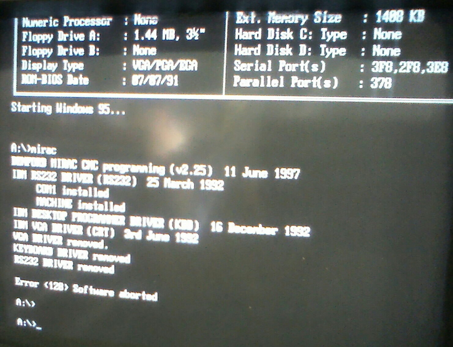

The problem is I don't have any original disks for it.
I have a boot disk for windows 95 which gets me into DOS
I can then run the MIRAC software from the Denford support for older machines, but Get as many others do <Error 128>
Ive tried swapping the com ports arround randomly but with no sucess.
Can anyone offer some advice please, as I don't want to start pulling the machine apart to fix something that is not broken.
Many thanks

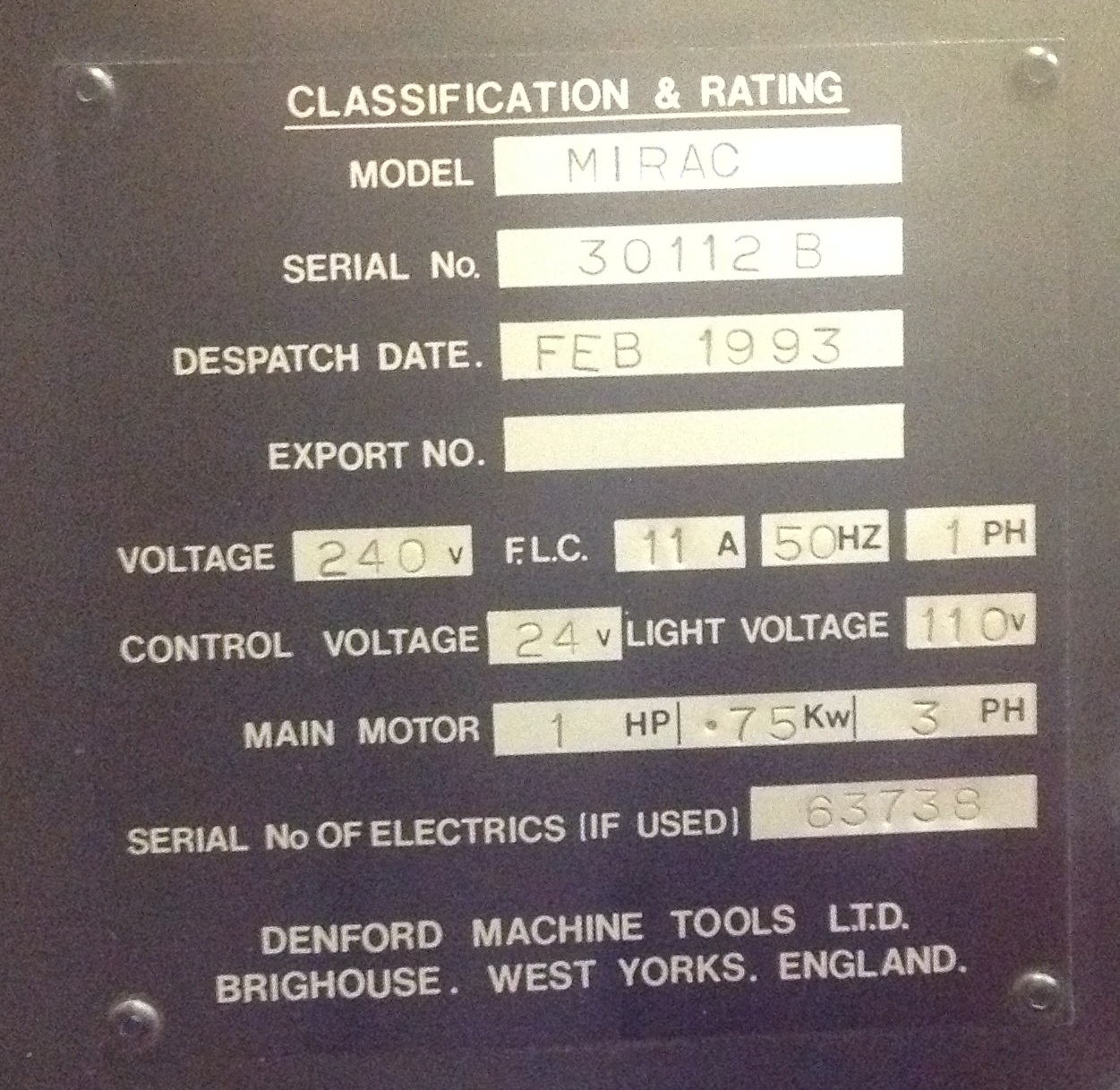

It has a board marked LCB3 (slave board?) which seems to be made by GSM-syntel. s/n 63738
KEB combivert for the three phase supply for the spindle and tool changer,
coolant pump and automatic oiling,

I've been working on the lathe again, I've search the forum and tried about every mirac.go file I can find.
Now I've got:
IBM.RS2 2
$3F8 4 COM1
$3E8 5 MACHINE
DENFORD.KBD 1
18.2 $2F8 3
VGA.CRT 0
MIRAC. APP
This seems to make sense as com1 goes the 25 way connecter on the cabinet
Com2 seems to be the keyboard on the front of the cabinet, and the Alert RS232 card provides com3 which is connected to the GSM board.
I've checked the cable against the wiring diagrams that came in the back of the manual, and it is correct to drawing, evrrthing I have tried so far I get the error 128
I even tried as someone else has to run flstep and get the same on off relay(s) in the cabinet until you press reset. I even tried a dongle as they did and ran the Drights.exe
Any ideas please.

Okay, here's what I THINK I have figured out.
IBM.RS2 2 -This line tells the computer to set up 2 COM ports
$3F8 4 COM1 - This is the address of COM 1 and is using interrupt 4
$3E8 5 MACHINE - This is the address of the COM port that is connected to the Machine and is using interrupt 5
DENFORD.KBD 1 - This is the Tutor keyboard app that runs to allow you to use the keyboard
18.2 $2F8 3 - This says the Tutor keyboard is at $2f8 using interrupt 3
VGA.CRT 0 - This is the driver for the monitor
MIRAC. APP - This runs the MIRAC control software
My lathe is the Mirac PC, so I have a separate PC connected to the control box with a serial cable and here's the .GO file that works for me.
IBM.RS2 1
$3F8 4 MACHINE
DENFORD.KBD 1
18.2 $3E8 5
VGA.CRT 0
MIRAC.APP
I think I read somewhere on the forum that if you have a built in monitor and keyboard that you need to use the DENFORD1.KBD program. Not sure,
but it might be worth trying. Since mine uses a separate PC, I have to be sure to turn the control box on before running the .GO file or I will get
the <128> error. It's looking for the control box and if it's not powered up yet it'll error out. You can install a separate COM board in the PC and run
the keyboard from it, as long as you know the correct address and interrupt it's using. I think I have my spindle problems narrowed down to the
KEB motor control board and I've found a place in North Carolina that will repair it and give me a one year warranty on it, so that's my next step. Hope
some of my ramblings make sense to you and help you a little at least. Good luck.
Wiley
Re: Mirac And no software
Many thanks, I'll have to try this out, your file that works, appears to have two comm ports com1 and com3 as you use $3F8 (com1) for the machine and $3E8 (com3) for a desktop tutor keyboard, is this correct?
I Had not worked out that IBM.RS2 was setting the number of com ports for the machine?
Been reading some more and it looks like the denford1.kbd is for machines later than mine, seems to be for machine that have a letter slave board after the gsm card.
