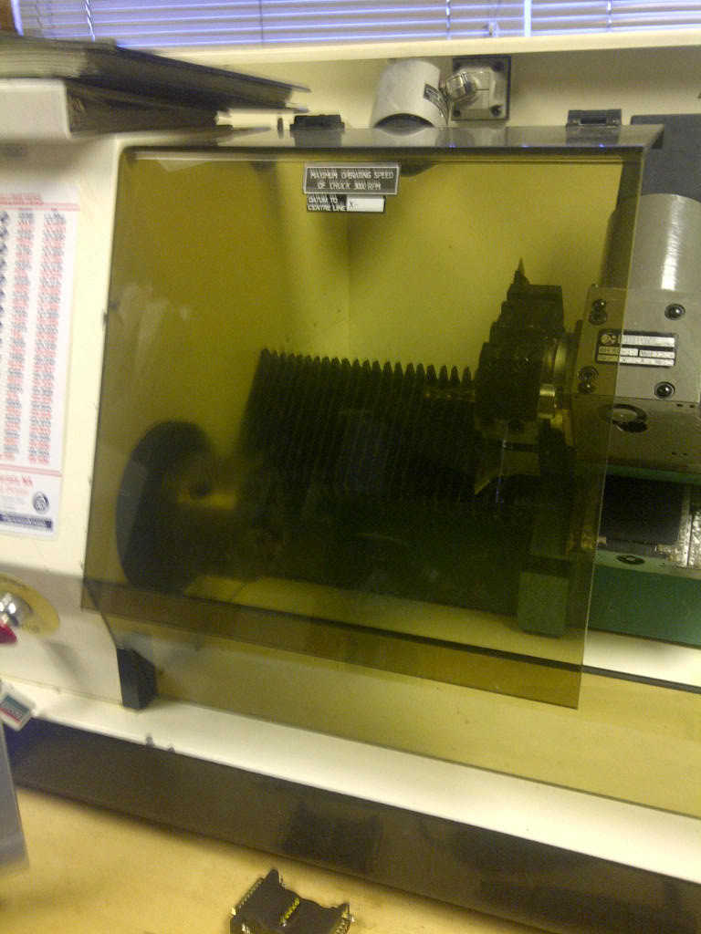

I've just acquired a Mirac PC but unfortunately only the lathe - the PC and the case with all the electrical circuitry had gone. I can't find any serial number on the machine or cabinet but the serial number of the Baruffaldi RH80-6 turret is 83833 and the spec appears to be the same as one I found on this forum which dated from June 1990. All electronics were separate and the only controls on the cabinet are the emergency stop and an Axis limit switch override. I had to dismantle it to get it home - it's a heavy devil - but I found a photo of one which appears to be very similar and have attached it (hopefully).
I plan to fit a modern inverter and drives and to run Mach 3 and it is likely to be a long process but there are a number of questions which would help me to get going.
