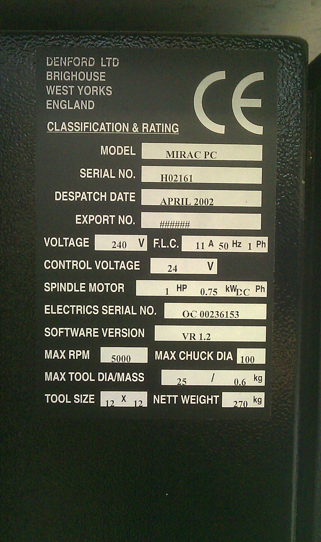

We are trying to get a mirac lathe running again, however the auto toolchanger flatly refuses to operate. Everything else on the machine works. The software used is VR Turning and the machine parameter in the software is set to 2. Inputting a tool change command changes the tool number in the software. I've attached an image of the machine info plate. Any help would be appreciated.

It should be fitted with a DM8 toolpost so needs to be set to 2.
If you are trying to perform manual toolchanges then you need to be in Auto.
