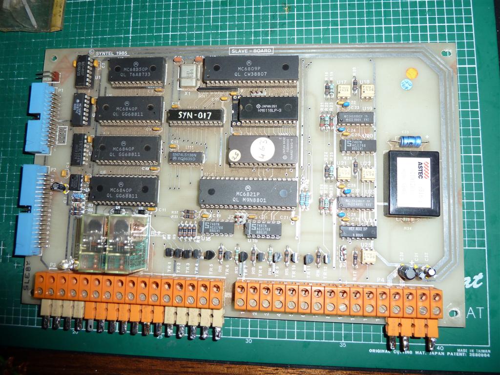

Apparently it won't be LCB3 if its from a Starturn 8, but I'll get a photo of it soon...
Re: Mirac or Starturn or other LCB3 Circut Board Print
This is the board from the Starturn.
The owner would rather keep it than just give it away so make a decent offer if you're interested...
- GSM Syntel slave board from a Starurn 8
- Syntel-Slave-Board.JPG (165.92 KiB) Viewed 12691 times
