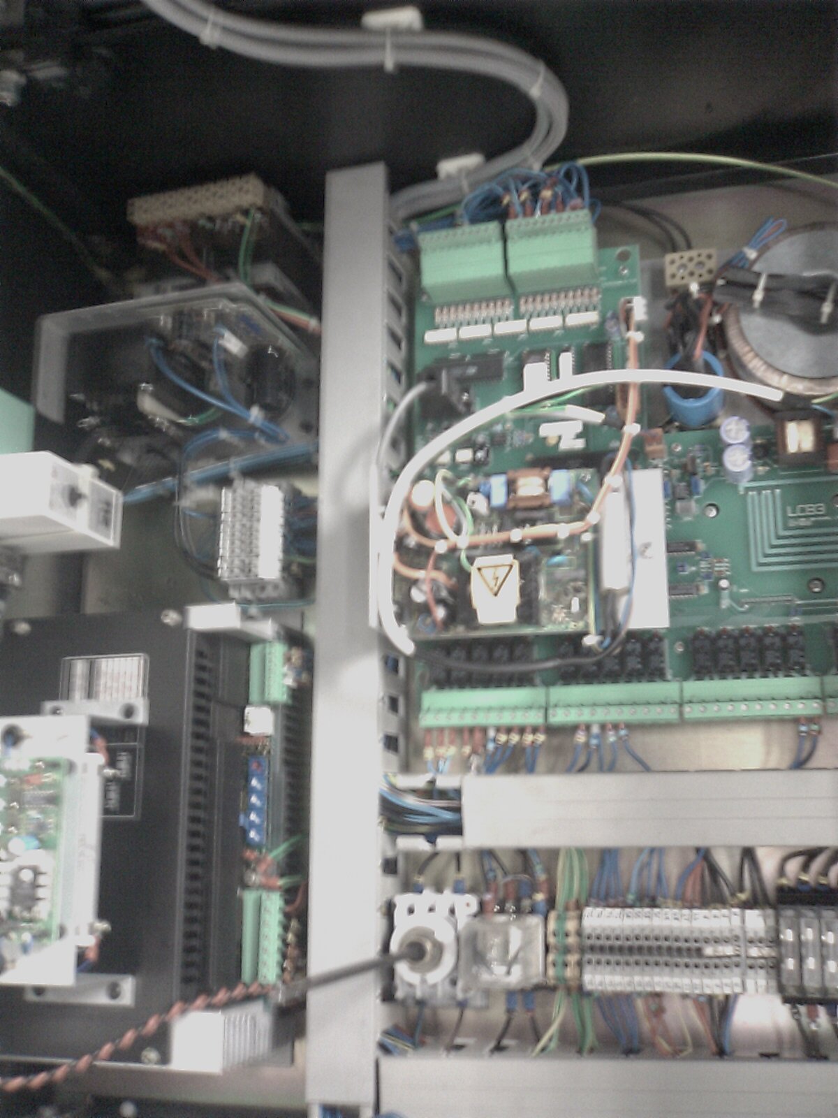

We have Mirac PC with controller s/n E03953, dispatch 7/1991 and want to upgrade from DOS to Windows VR Turning software.
The control card does not look close to any of the images you provided. It’s kind of an L-shaped board marked LCB3.
Any thoughts?

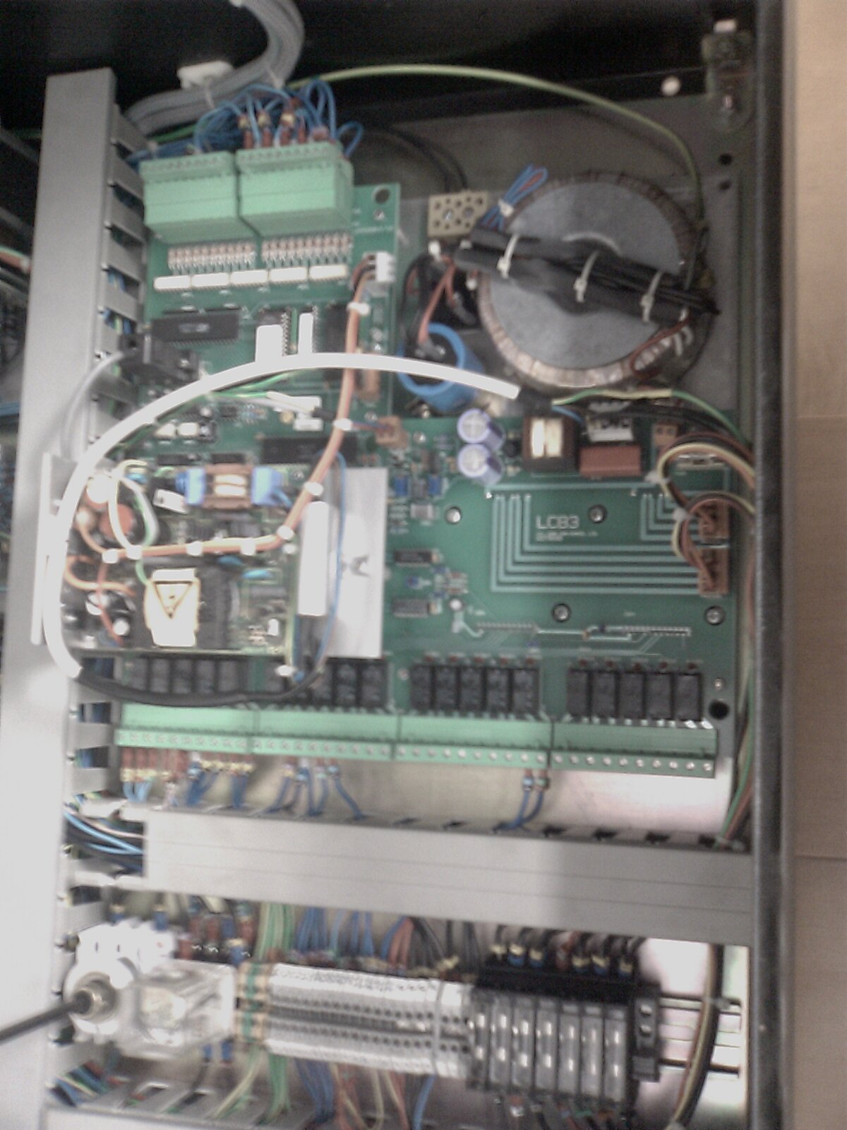

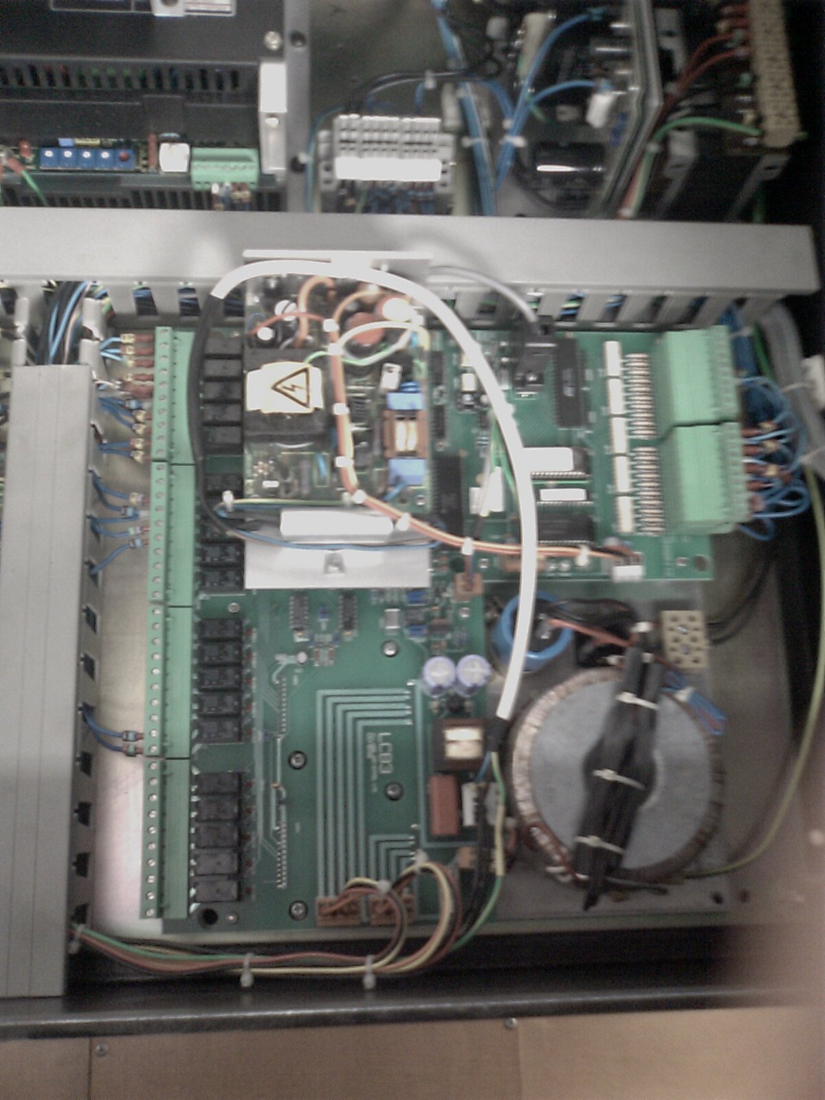

Here are some photos:

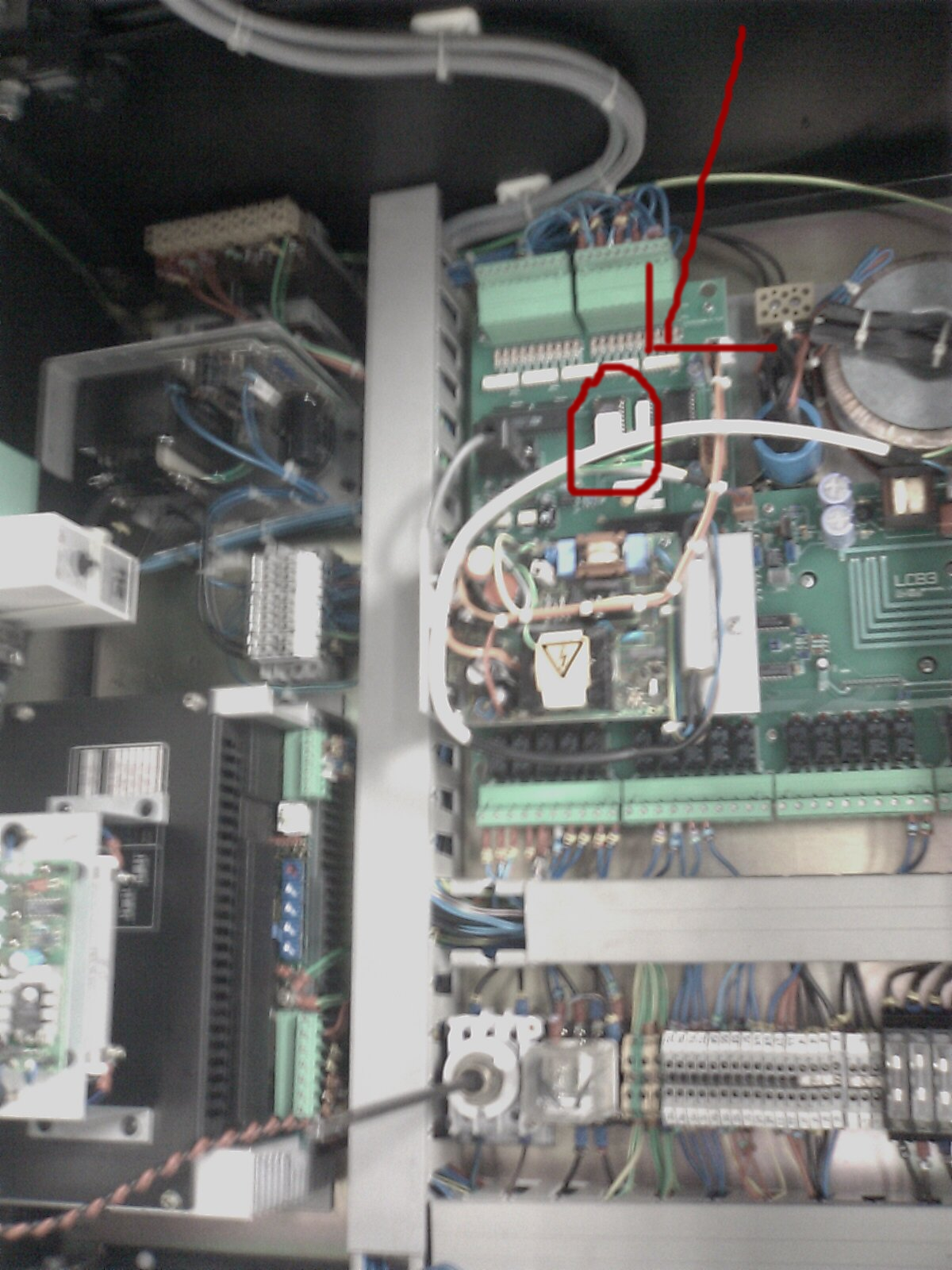

Post by boots » Wed 19 Nov , 2008 19:42 pm
Info on the IC that is circled:
Here's what's on the EPROM:
EPROM NO 929
PC03095 LCB3
SKT V5 R1.1
The V in V5 might be a U.
Post by bradders » Thu 20 Nov , 2008 8:49 am
Unfortunately the LCB3 controls were supplied by a comapany called GSM in Huddersfield West Yorkshire, they are now out of business so upgrades from Denford's cannot be offered.
People with these machines seem to go the Mach 3 route
