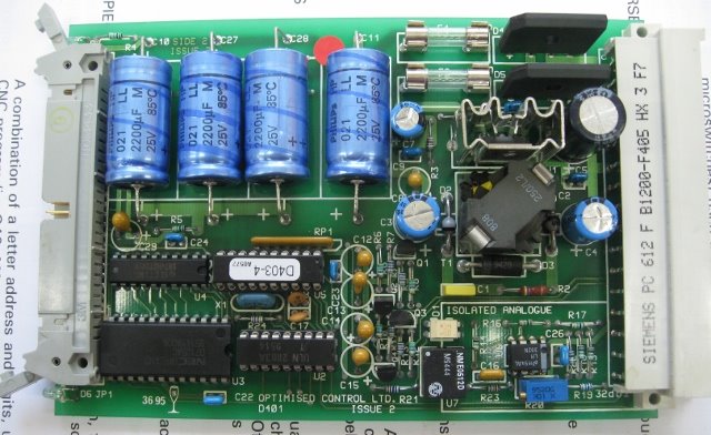

Hi Max
It may just need adjusting on the control card.
Depending on which control you have the pot is located in different places.
If you now which control you have or can post a picture it should be straight forward.

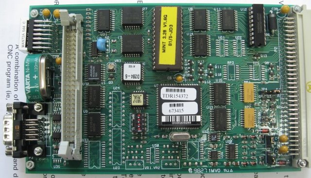

I found a manual for the Combivert VFD online. I can confirm that it's controlled by an analogue voltage which is presented to terminals 17 and 18. This voltage varies depending on the speed selected.
Martin.
Picture of control card attached. I believe it's a Baldor Eurostep? The only pot fitted is VR3. If this is the speed control pot, then I think I know the cause of the problem. The original control card fitted to the Mirac had suffered the usual problem of the battery leaking and corroding the tracks. I swopped it for one taken from a Triac which I've converted to USB control. The EPROMS were swopped between the old and new cards, but VR3 would have been set up to match the Triac.
If you can confirm that VR3 is the speed control pot I'll adjust it.
Thanks, Max.
Martin.
Thanks, Max.

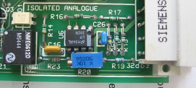

Thanks Martin.
I'll give it a try.
I'll give it a try.

I've used the pot on the custom card to set the min speed at 100 RPM, but if I call for the max speed of 3800 RPM only 3000 RPM is achieved.
Is there a pot for max speed or will I have to reprogram the VFD?
Thanks, Max.
Thanks, Max.
Re: Spindle speed incorrect.
It seems strange that both the top & bottom speeds are out.
Is the speed overide set at 100%?
If it is then you will need to set the top speed on the drive.

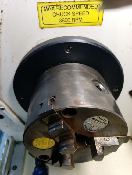

The maximum speed parameter sets the highest speed that can be selected in software be it DOS or VR turning. It is also the speed at which 10VDC is sent to the VFD.
In the case of my machine the maximum speed parameter was set to 5000 RPM, but the VFD was set up so that 10VDC corresponded with 3870 RPM.
Given that the maximum speed for the chuck is 3800 RPM I set the maximum speed parameter to 3800 RPM, but I will change this to 3870 RPM to give a slight improvement to the scaling.
The fact that the VFD was set for 3800 RPM cannot be a coincidence. Most likely it was set at the factory, but the maximum speed parameter was left at 5000 in error. Or given that this machine came from a school, the staff there changed the VFD setting to foil any attempt by students to overspeed the chuck, but neglected to change the maximum speed parameter.

I think there must be different Chucks Fitted, I'm sure mine is a 'super Precision' and good for 5000rpm, My machine is also an older one with the 6 position tool, holder. The control card is the Syntel GSM? version.
