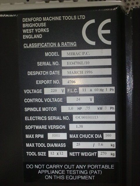

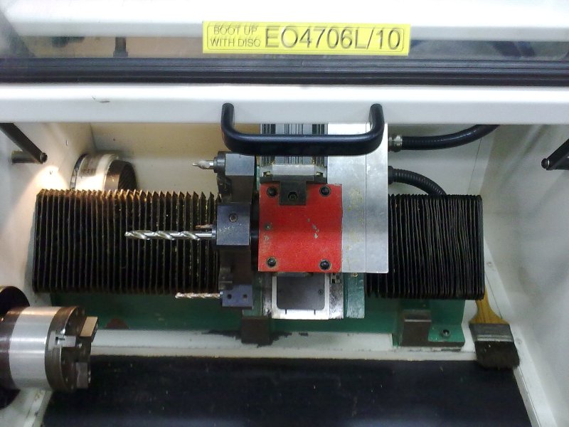

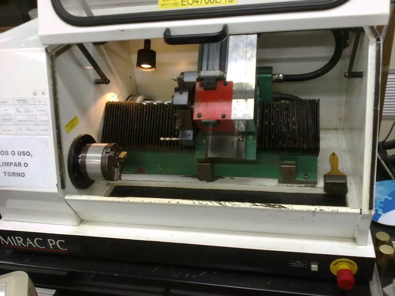

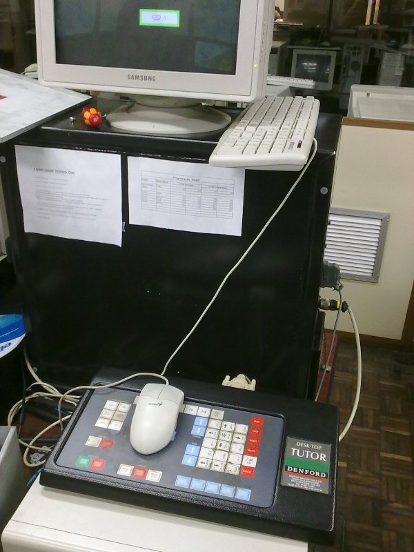

I'm posting some photos of my Mirac PC. Can this photos help?
- 18062010292_.jpg (87.89 KiB) Viewed 17405 times
- 18062010291_.jpg (89.22 KiB) Viewed 17405 times
- 18062010290_.jpg (92.31 KiB) Viewed 17405 times
- 18062010289_.jpg (69.8 KiB) Viewed 17407 times

Hi slackebr,
Here are my suggestions to help with connecting your machine to your CIM system.
1) You MUST use the PC running the Mirac DOS software to control them machine. You can not send CNC programs to the machine controller directly. You can not use the MDI (M29) or MINP mode with your machine.
2) You can 'talk' to the PC running the machine via RS232, using the command $$RESET, $$MACHINE etc but you must first configure the machine software to accept these commands. Can you please send your .GO and .OPT files (these files are part of the machine control software) and I can advise how these should be changed to accept the remote control commands.

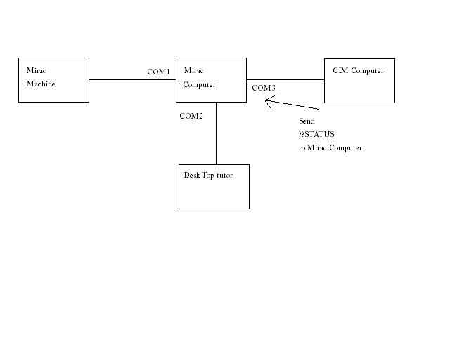

Your OPT and GO files indicate that your machine is already configured to use the $$MACHINE commands.
In order to use this, the computer that is controlling the machine MUST have 3 x serial ports fitted and be configured like this...
Mirac Machine connected to COM1
Desk Top Tutor connectoed to COM2
Your CIM remote computer connected to COM3
Note that COM3 MUST be configured to use Address $3E8 amd IRQ 5. If you are unsure about this then seek advice from your IT department. If you are using the computer originally supplied with your Mirac then I think this may already be configured like this.
Once you have setup your machine like this (see diagram) you should be able to send the command
??STATUS
followed by Carriage Return to the Mirac computer and see a response similar to
R0C0M0
NOTE the serial parameters are 4800Baud, no parity, 8 databits, 1 stop bit.
If the ??STATUS command works, then you can send
$$MACHINE FROM fred.fnc
to make the machine load and run the CNC program called "fred.fnc" which MUST exist on the mirac computerds disk Hope this helps
