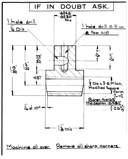

Hi I am new to this site and I am looking for information on a viceroy lathe in regards to the cross slide on a 1967 lathe there seems to be a bit missing
between the feed nut and the cross slide the counter bore in the cross slide is about 5/8" dia and about 4mm deep the boss on the nut is half inch diameter by 3/32" deep is there a drawing for this item or a picture so I can make one as I can not see them fitting a 1/2" boss with tolerance of 2 thou in a 5/8" hole and just using the screw to keep it in position Thanks in advance any help welcome

The nut should have a 5/8" spigot. Perhaps yours has a compound slide nut fitted or one off another lathe?

Hi thanks for the replay it from an earlier machine than the feed screw nut you have shown which from 1970 on machine see drawing ml100/512A
