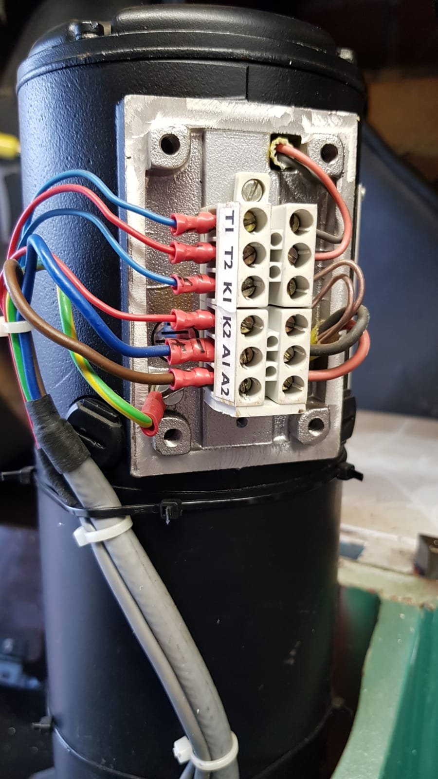

I have taken the cover off the spindle motor
not sure what wires do
they are marked from top t1 then t2 then k1 then k2 then a1 and the bottom one a2
t1= blue (thin) t2 red (thin) K1 Blue (thin) K2 (thin) a1 blue (thick) a2 Brown (thick)
measured a1 and a2 @250rpm 61-62vdc (varies) then @4000rpm 70-73vdc (varies) seems really high.
as I increase the speed to 4000rpm it doesnt seem like it is going at 4000 rpm seems much slower
and varies. If it was a petrol engine I would say "its hunting " so to speak.
not sure if I have got the correct wires to test but as the a1 and a2 are much thicker thought they may be +and - , just guessing as I dont have a diagram .
any help would be greatly recieved.
Alex

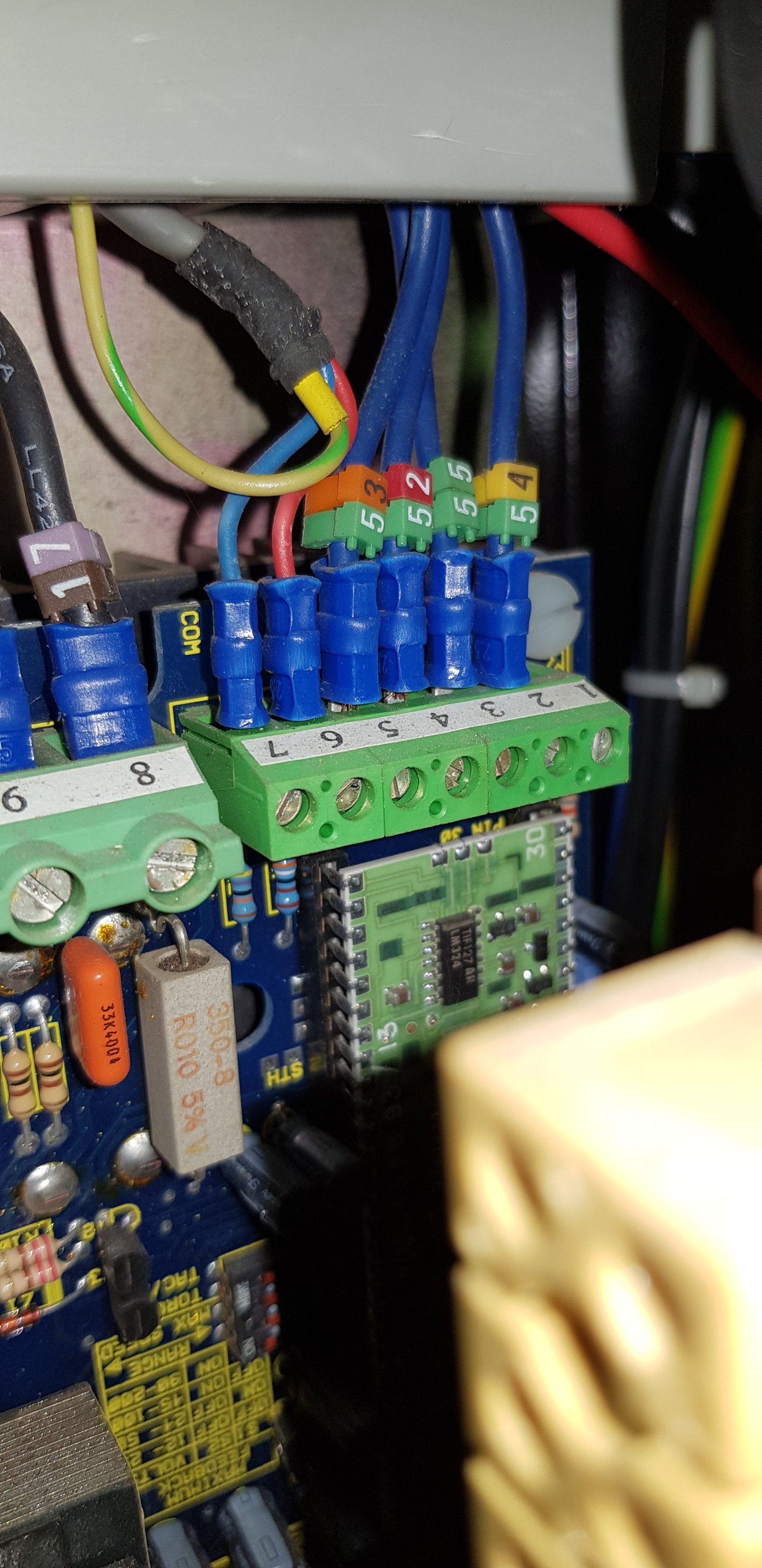

Not sure if this will help but I uploaded the drawings for a sprint controller, may not be the same though viewtopic.php?f=46&t=4778
Re: Triac PC spindle motor speed varies by its self
Post by Steve » Fri 21 May , 2021 13:34 pm
Please send a larger picture of the spindle drive.

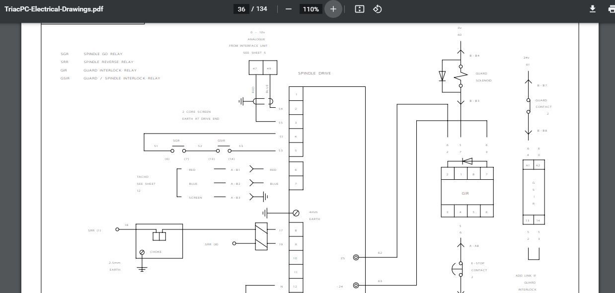

Download electrical diagrams
file:///C:/Users/soddy/Downloads/TriacPC-Electrical-Drawings.pdf
View page 36
Wires 54 and 55 are the analogue
spin drive.JPG (46.2 KiB) Viewed 148821 times
Wires 17 and 19 look like the motor DC

The voltage on those Pins 54 (-) and 55 (+) at 250 (slowest speed ) is 4.6 -4.78 DC , fluctuates
the voltage on the pins at 4000 (highest speed ) is 6.7 - 7.32 DC , fluctuates
It doesnt get near to 10vdc on full speed
wonder why that is ?
regards Alex

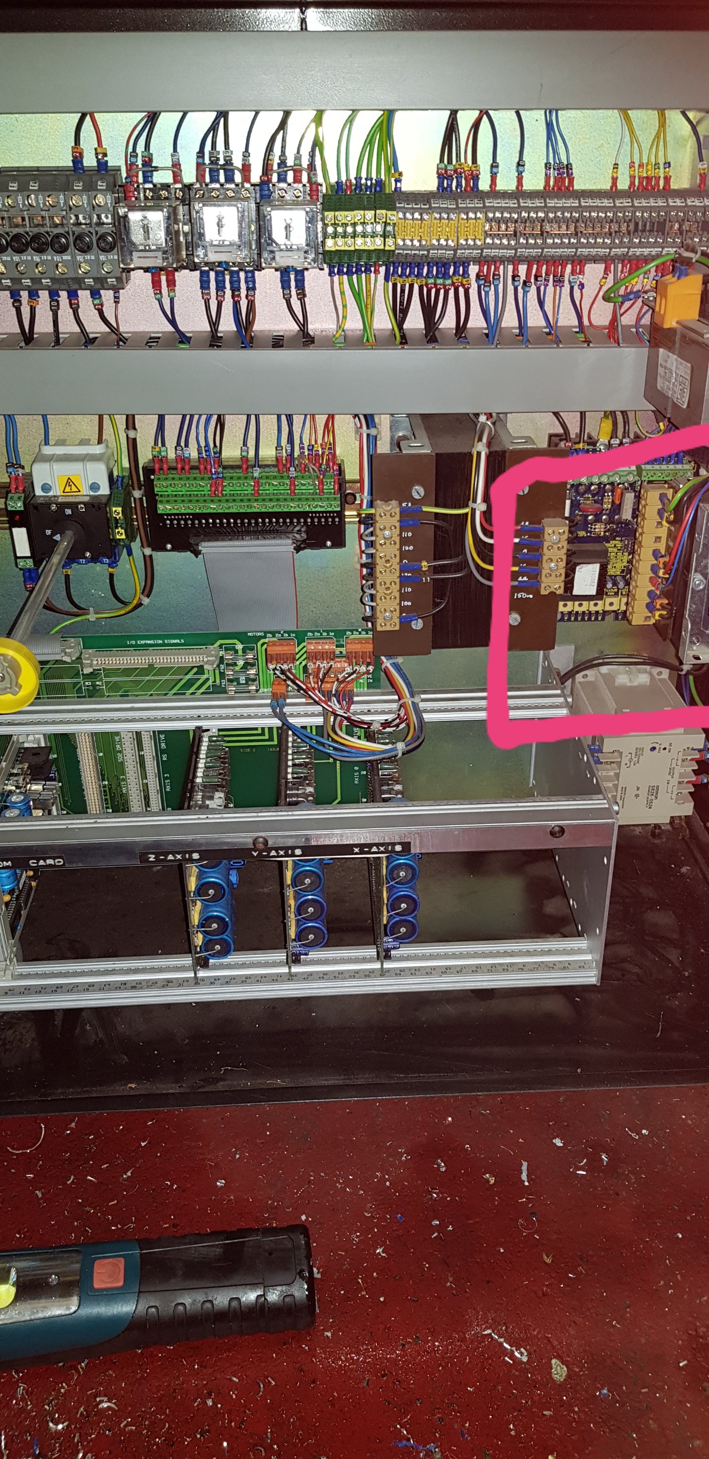

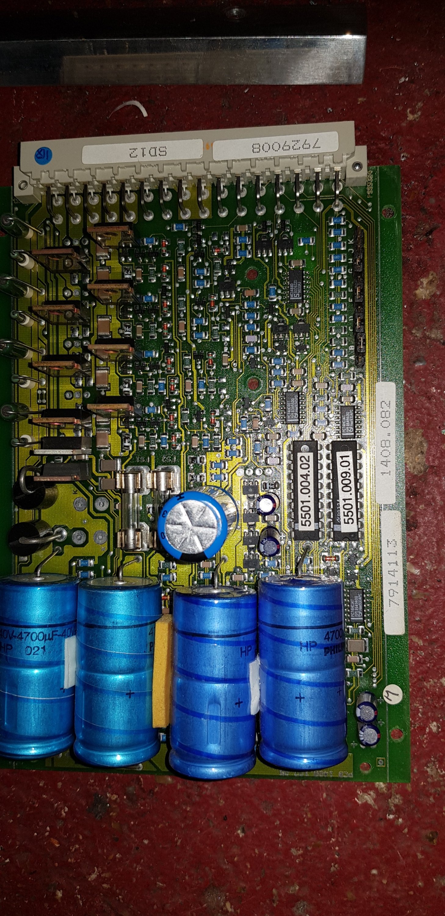

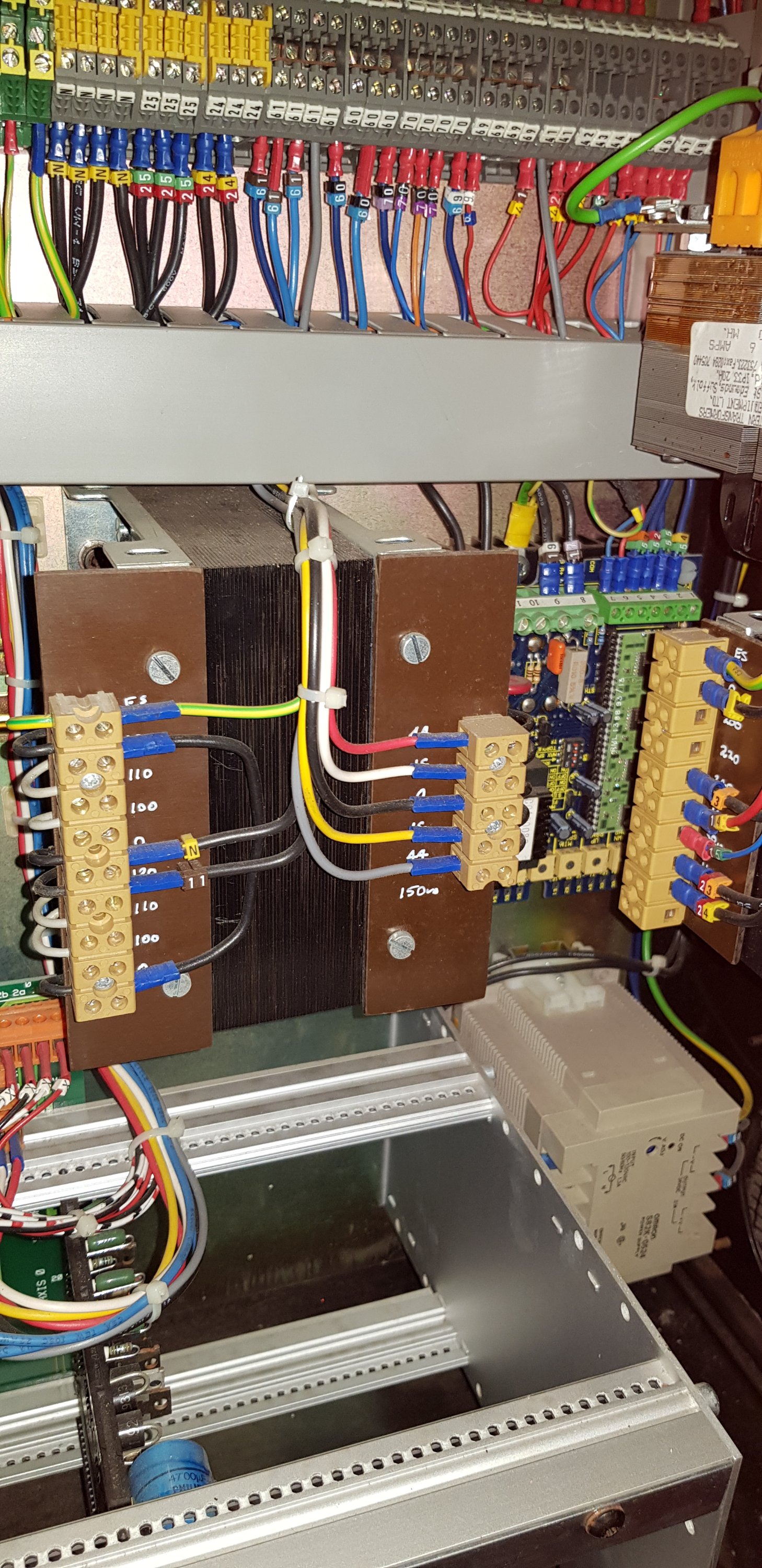

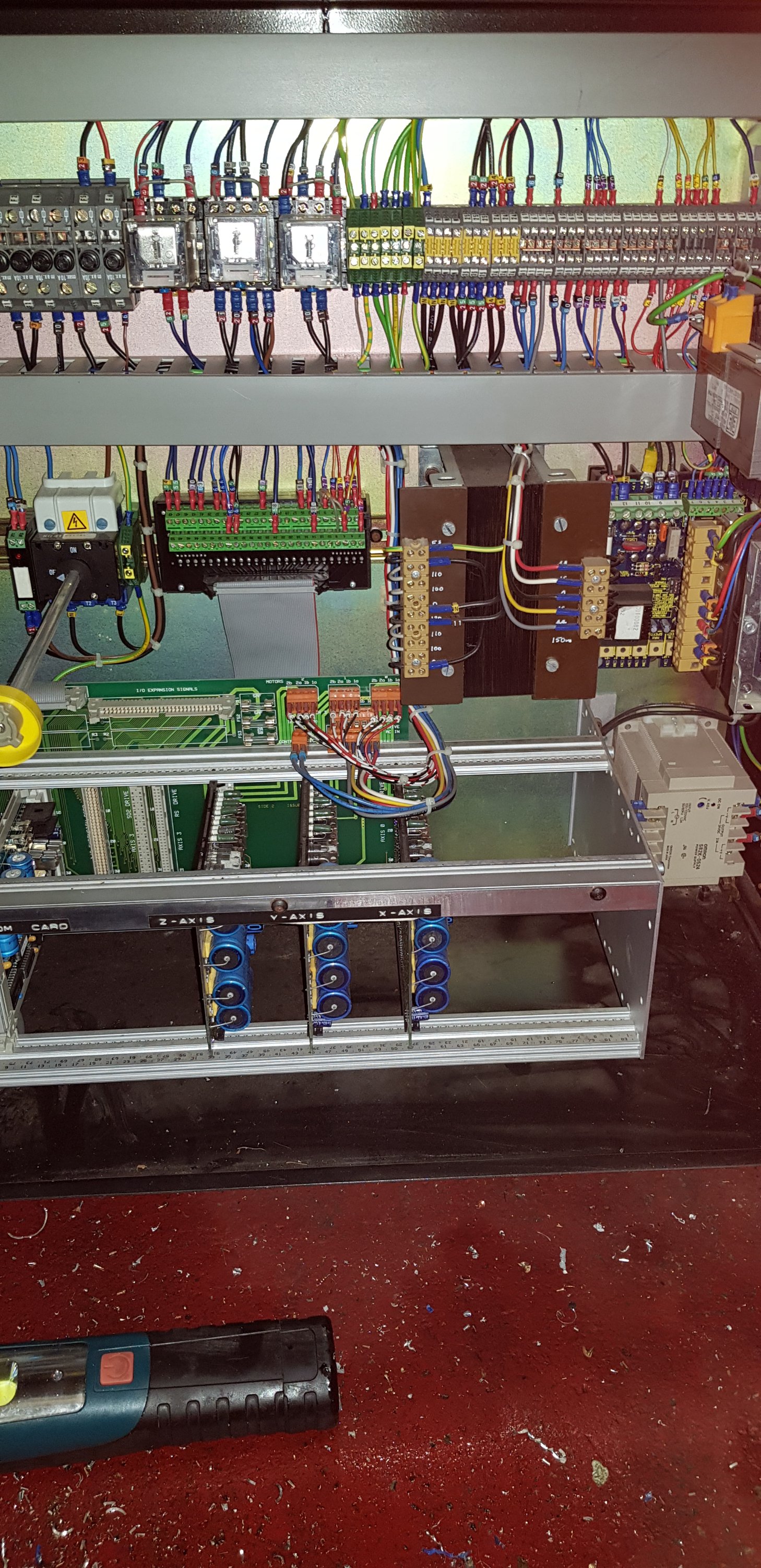

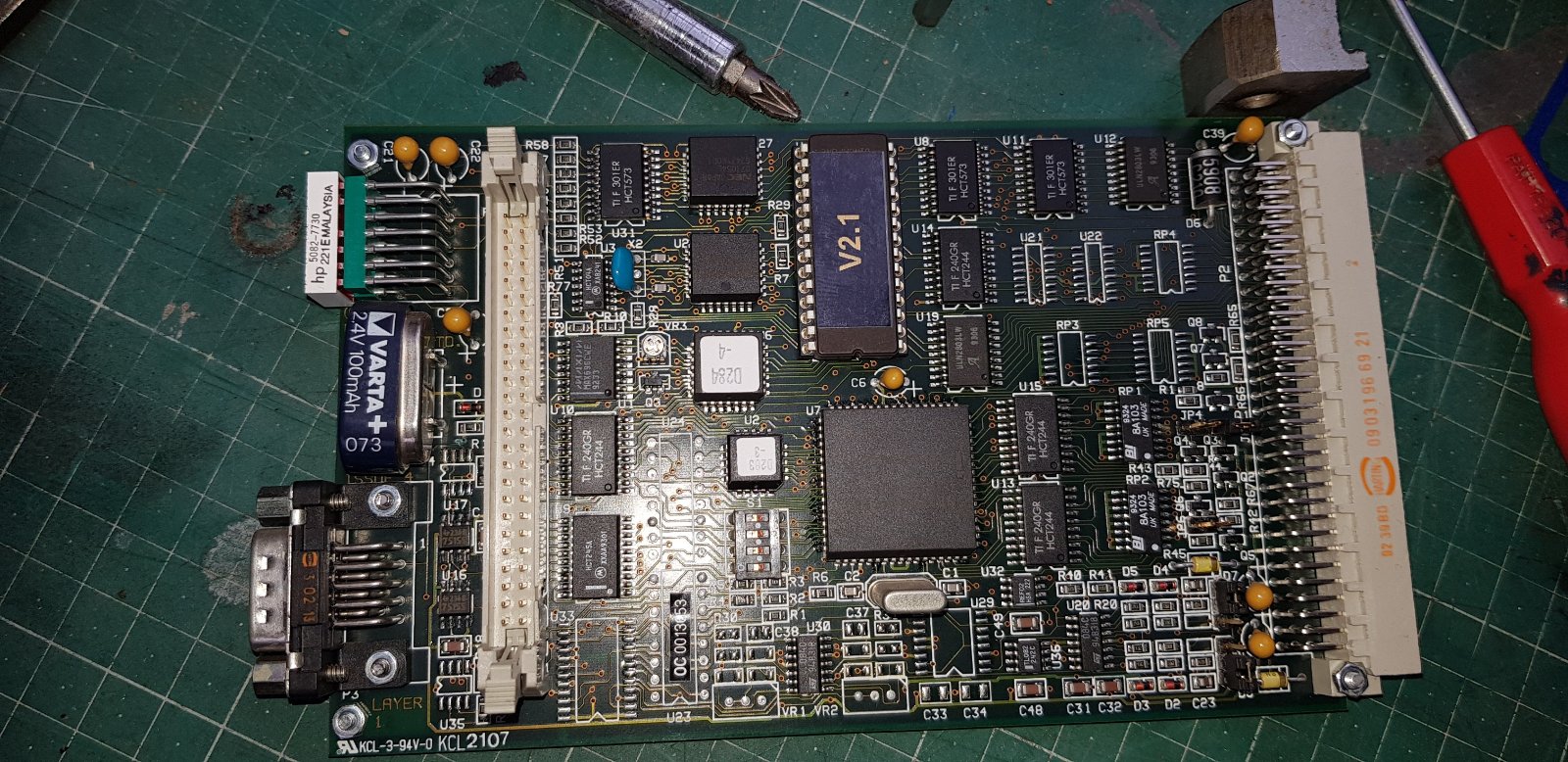

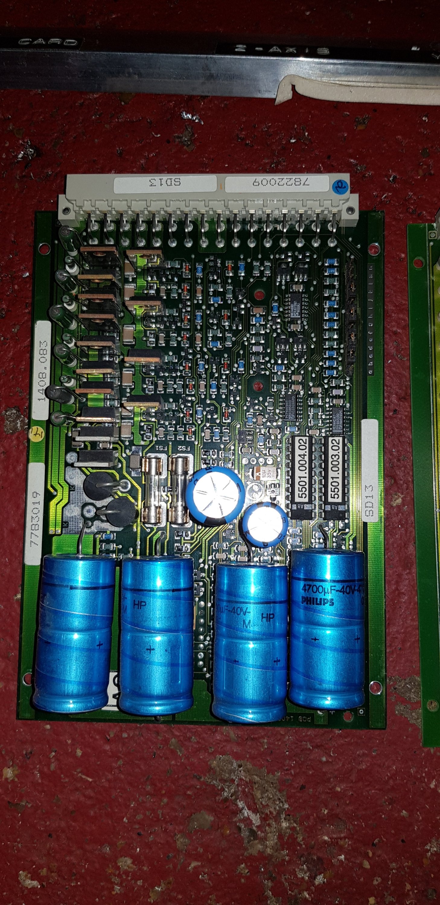

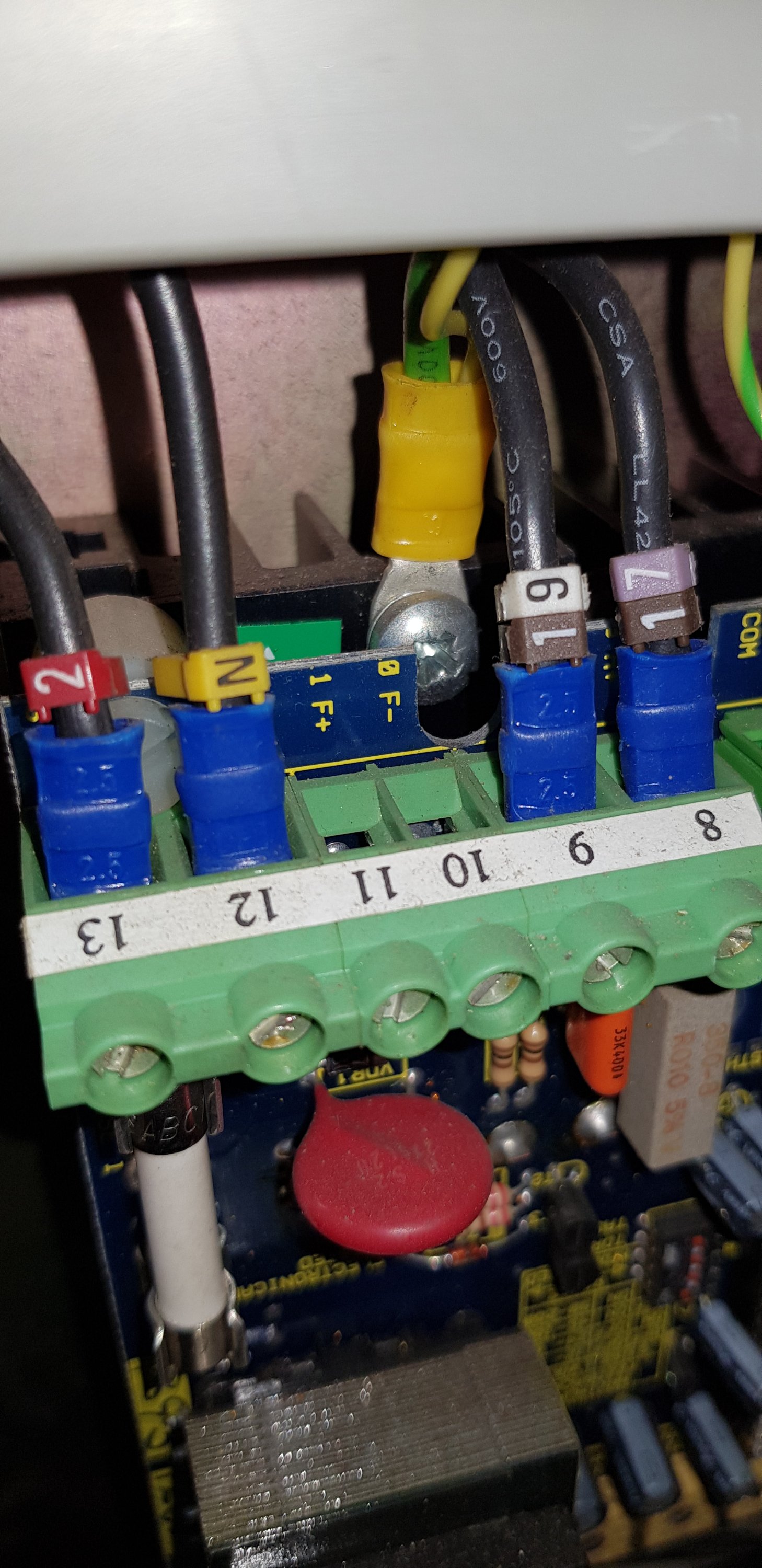

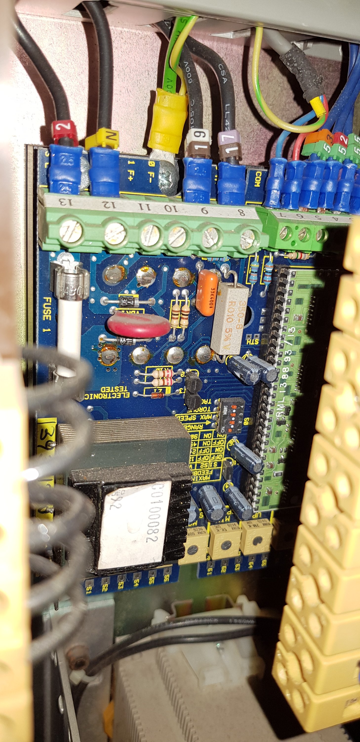

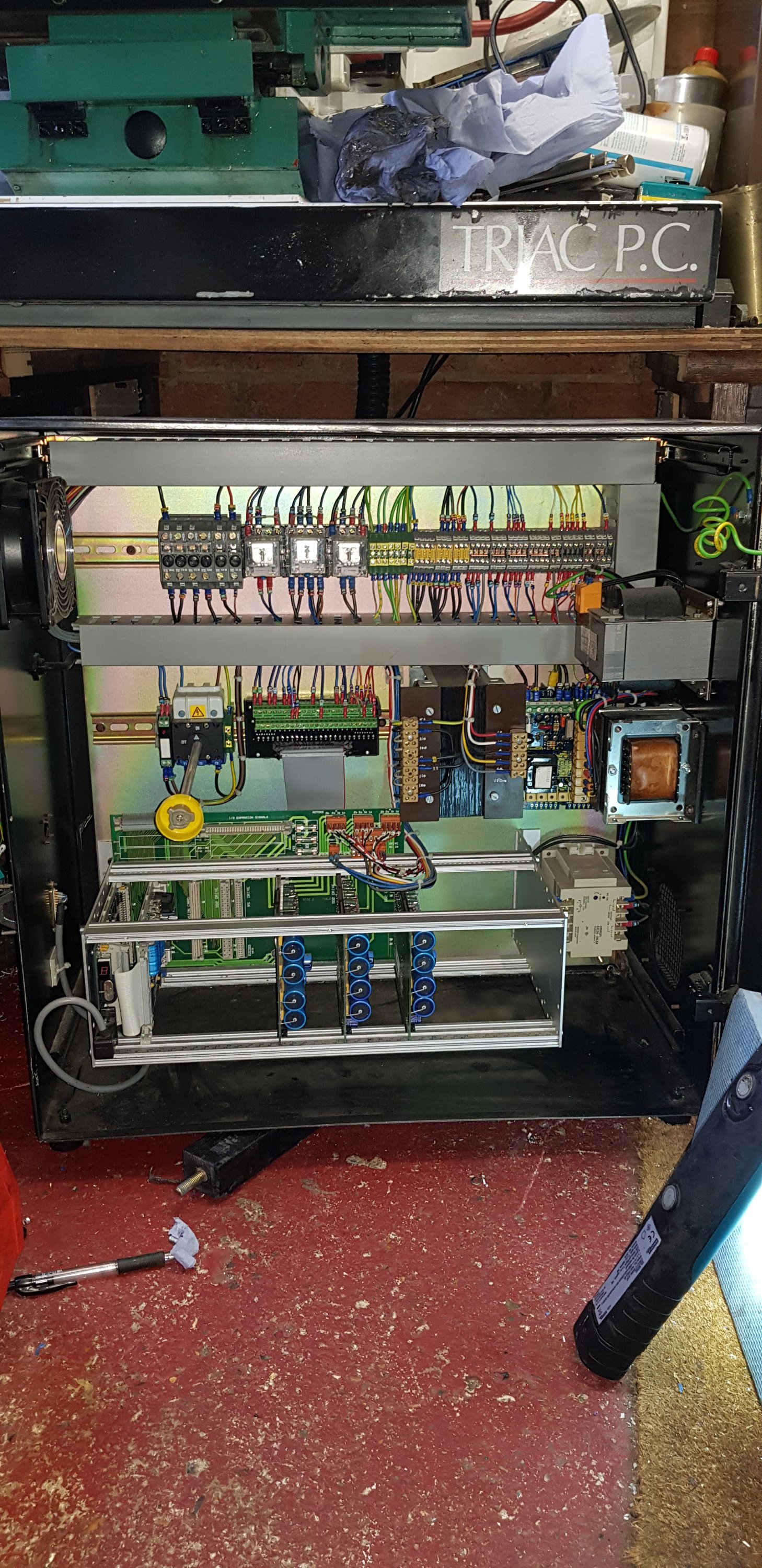

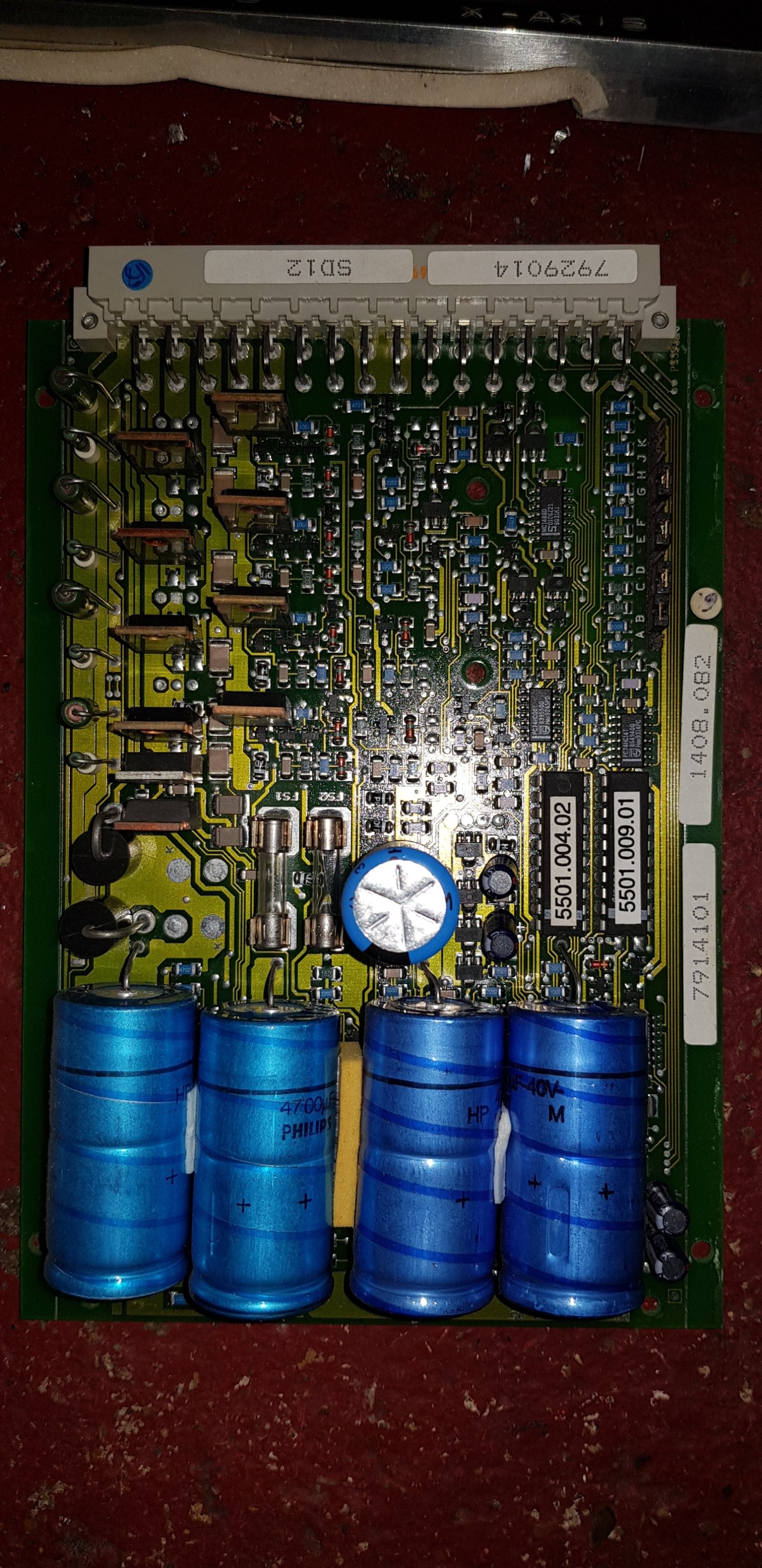

Can you supply photos of the inside of the electrical cabinet It sounds like the spindle analog card has failed.

Post by amaxlegend » Fri 21 May , 2021 20:02 pm
Steve wrote:
Fri 21 May , 2021 19:10 pm
inside case and board pics for triac
