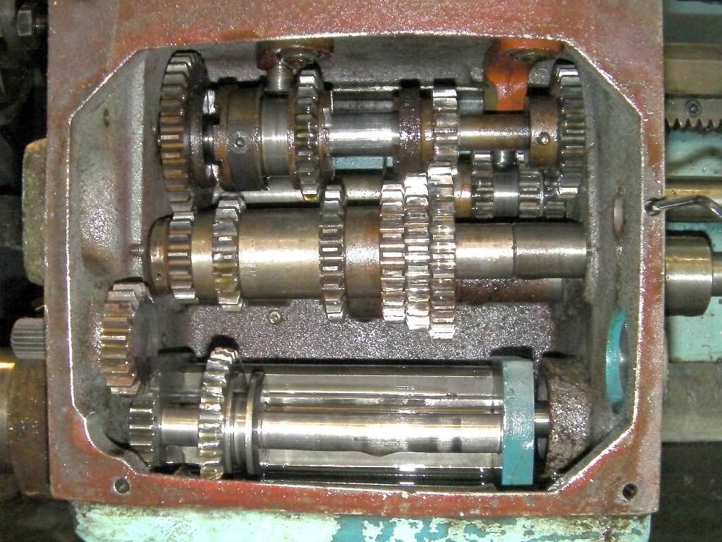

This is what your gearbox will look like inside.
That small gear on the far left is the tumbler quadrant gear. If you just remove the lever to pull the front off the quadrant will fall to the bottom and dis-engage with that gear. You need to avoid that at all costs or you'll have the devil of a time setting the tumbler engagement. I had to press the oil sight glass out of mine so I could see to put it back together and I still managed to mess it up one time.
This gearbox has got to be one of the stupidest things ever designed.

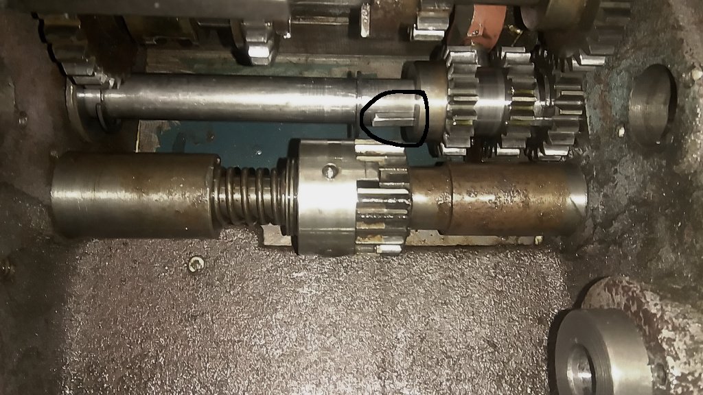

Shamus I think that your problem is that you have sheared off this key circled in the pic. It will be pretty obvious when you get the box apart, just slide the lever to the left to the 'screwcutting' position and you can turn the shaft to see if the key is sheared.
