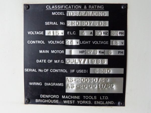

Back while living in the U.K. I bought a Denford Easimill, with history.
It came from a government sale of equipment used for training inmates at H.M. prison at Long Lartin, Worcestershire where it had given excellent service making keys, knives and other items useful to those who find themselves incarcerated.
In April 1990 there was a mass breakout attempted, which explains the appearance of my machine.
After this event the government decided to upgrade this prison to maximum security, cease all training and dispose of the machine tools. And that dear friend is how I got my Easimill.
Sorry for the above, but I do think it nice to know something about our machines.
Now living in South Africa with my Easimill.
Mr. Google can offer very little information about the Easimill, perhaps someone out there can help.
A manual (copy) would be great, an electrical diagram would also be a big help.

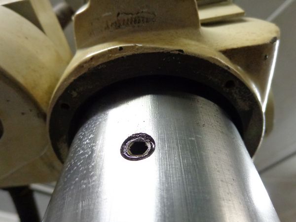

There seems to be a ring missing from the bottom of the quill. It appears that some kind of seal should be enclosed between the quill housing and the ring, perhaps an O’Ring.
If anyone is able to tell me more about this ring (size) purpose and if there needs to be a seal, I will add them to my Christmas list immediately.
