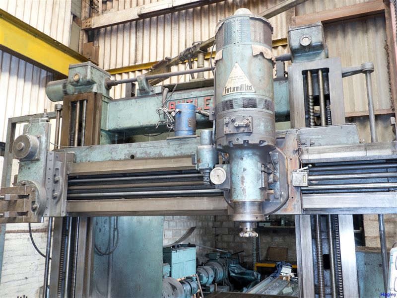

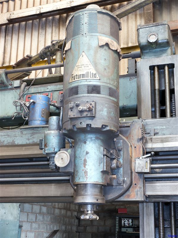

"Futurmill" converted the whole shooting match, fitting DC drives to the cross axis and table long travel (clutched so you could still use the planing side if need be ), power clamping to the saddles, new pendants, and of course fitting their patented "Futurmill" variable speed milling head. This was about 20 to 30 horse power infinitely variable through a " Vickers" planetary two speed gear box, 2 hp won't take you very far unless your putting the holes in dolls eye's.

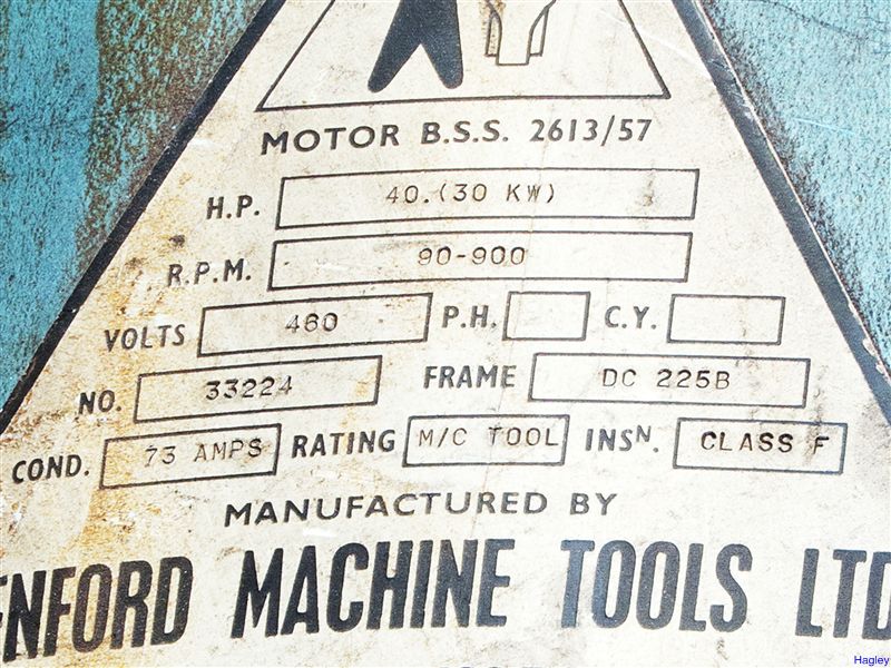

The quality of the all the "Futurmill" milling heads was first class, especially the later ones. I worked on one that was a DC infinitely variable over two speed ranges, it'd go from say 4 or5 revs right up to over a 1000 if my memory serves me well, plenty of umph even at low revs. Power RPT and feed rise and fall on the quill of about 8". Only real draw back was the lack of a power draw bar for the tooling.

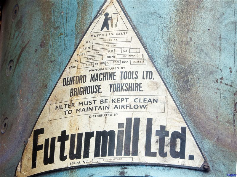

I believe they were produced from mid 1960's ending around 1976 (there are no more drawing mod notes after that date!).
A few pictures I found on a machinery sales site - here fitted to a Butler planer..
