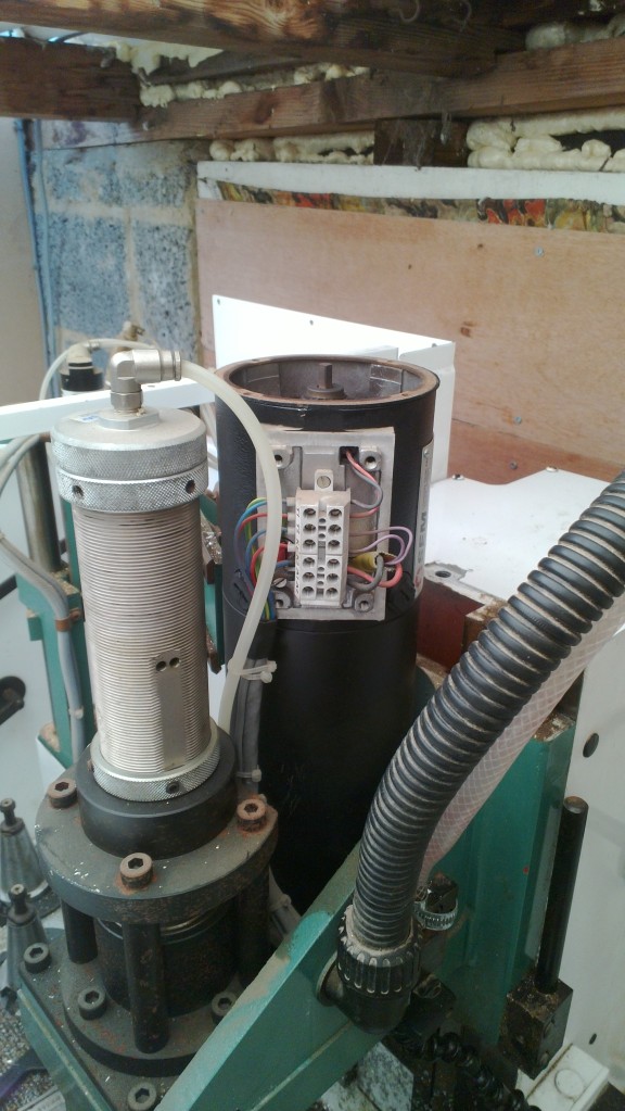

I have just seen a photo on the forum which shows the Brauer air intensifier unit used on the auto toolchanger fitted to the Triac and Triton.
This cylinder is filled with Hydraulic oil and magnifies the air pressure to allow it to compress the spring stack that releases the tool holder.
The locking ring at the base of the unit can be adjusted to position the stroke of the spindle over the tool release drawbar.
I believe the oil in the cylinder can be refilled.
