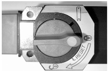

Please check the guard switch is in the locked position. If not, the spindle motor will not come on even if the guard is closed. If it has been moved to the unlocked position, you must use the release tool to push the pin back in order to turn the switch back to the locked position. For further information see p11 of the Vertical Router Operator Manual wich is located in the 'Manuals' folder on the 'VR CNC Milling V5' CD-ROM.
Image of Vertical Router Guardswitch
