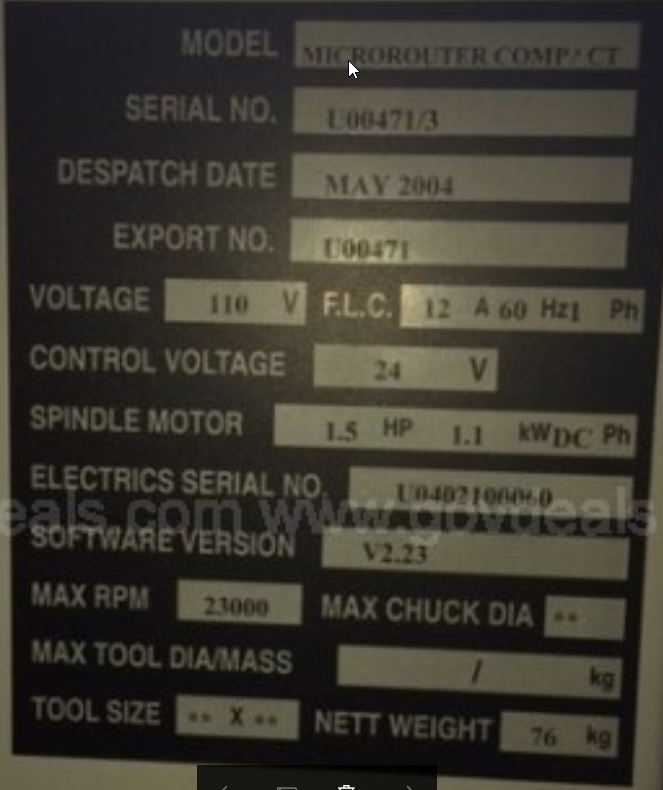

Hi, best thing is to post up either the data or a pic of the machine plate (label on the side with info on) next remove the rear cover, grab a pic of the control boards, specifically look for a 32 pin chip about 35mm (1" 1/2) x 12mm (1/2") which should have a label on it with something like v2.2 on it (poss other info), also when powered up what colour is the 7 segment display (LED display in a fig
. that tells us what control boards it has and software version on board.
Once you know what is on board you can find out what software you need to control it.

Here is the plate.
I will get the cover off and get the rest tonight or tomorrow and post it here.

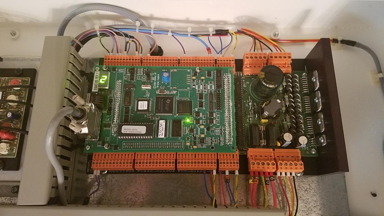

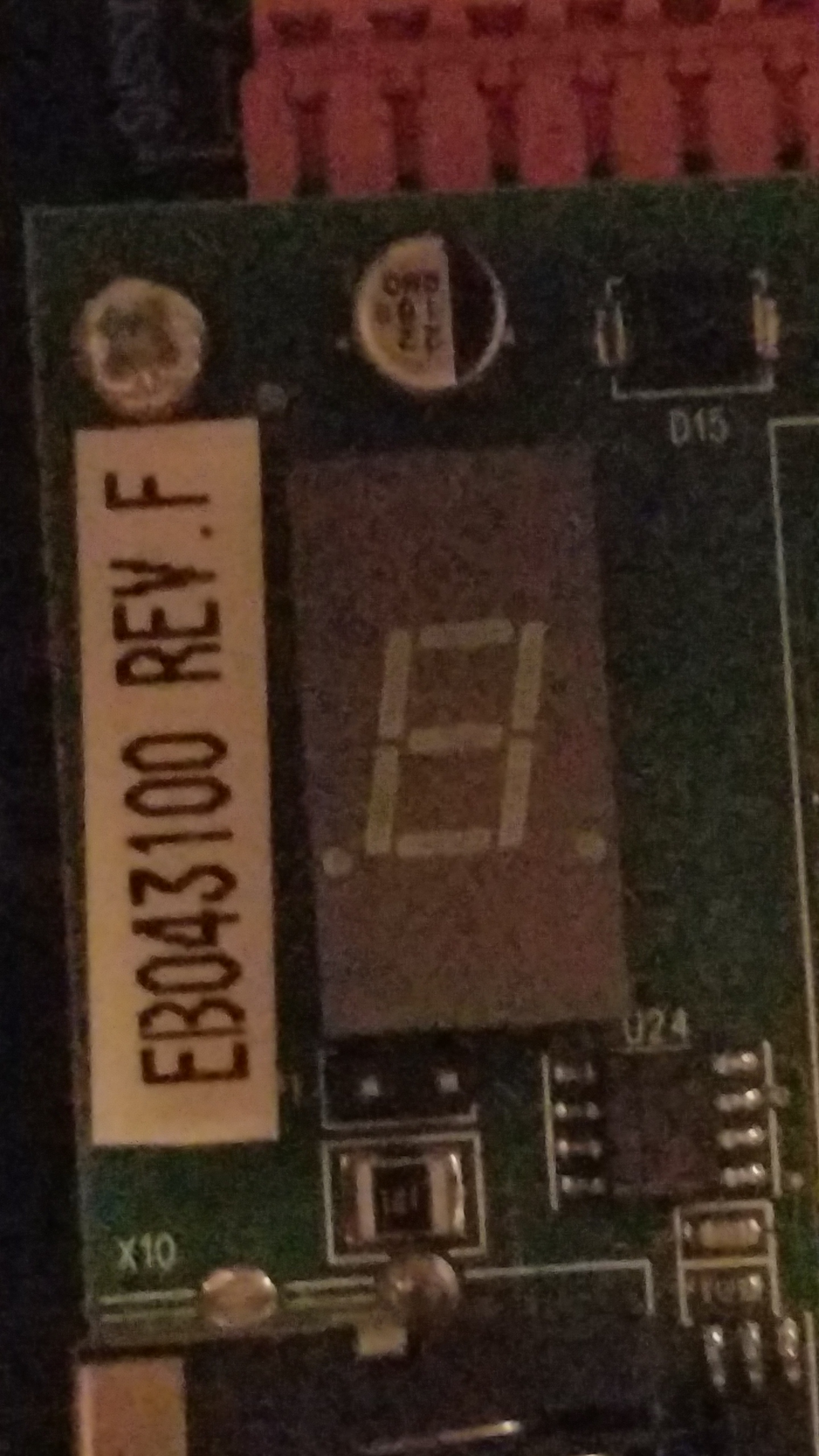

I got the cover off and powered it up.
The front door interlock seems to be engaged also. Having read the manual, I will pop off the bottom cover and release it manually for now.
There is a label beside the Segment LED.
EB043100 Rev. F
The seven segment display is GREEN.
When I power it up this is what happens on the display.
1. It shows a Solid 8
2. Then the Middle Horizontal segment lights solid with the Dot Flashing
3. Finally it It displays a SOLID 2 (Not Flashing). The dot at the lower right of the segment display is NOT ILLUMINATED
This is everything I know at the moment.

- Posts: 613
Re: New Owner / Introduction
From your info, you need to get VR5 to control the machine.
You will need some form of CAD software that you can export in DXF if you are doing 2.5D machining, several paths at different depths or 2D different paths and same depth. If you want to do full 3D profiles you need a program you can export STL files from or a program (like Fusion 360) that will allow you to post process within it. If you use a program that can export STL files you can get Denfords Quick Cam which is a very good post processor (takes the STL file, lets you set tooling info, select machining plans then create the G code) Another post processor I have worked with is Deskproto, they do include denford in the machine lists but I have never used it with a denford machine.

Reading the manual left me unclear about the expected starting state of the LED. Should I understand that it all looks normal so far?
As you might imagine, I would hate to buy software for a 13 yr old unit and find a hardware problem (when I could have bought new electronics for about the same money.)

Not aware of a trial version. As for the sequence on the LED display. Ill flip the panel off ours in work tomorrow and fire it up. Ours is the Microrouter Pro but I think the board is the same.
I found this if it helps. Someone was having issues with a machine
"Does your board have a USB communication port?
You may need to try and connect the card to the computer to get the display to read correctly.
Where did the new card come from? What machine was it previously fitted in as it may need to have firmware updated
What colour is the 7 segment display? If its Red then its a Denstep control Card. If Green or yellow a nextstep.
stuff/NextStepLEDSWEB.htm
viewtopic.php?f=54&t=3167&p=16305&hilit ... ent#p16305"
Do you have the 23 way RS232 connector on the side of the cabinet or the USB? If the RS232 you may find it has a USB on the board just below the LED display.
You really need someone like Martin to come along and comment on that side.

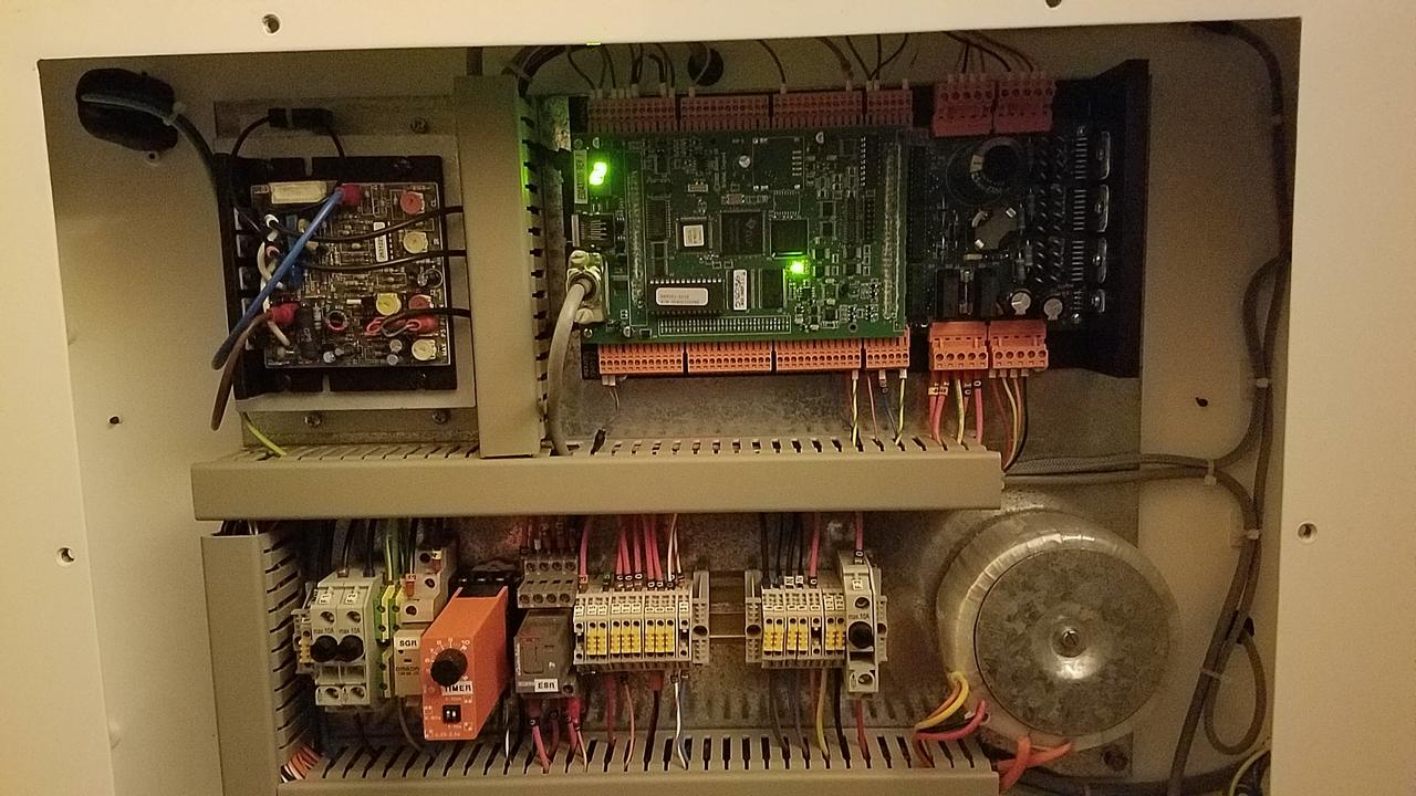

Here are a few pictures of the Cabinet, just so you can be clear about what I have.

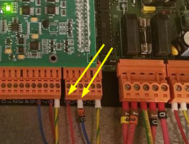

I have been studying the cabinet and comparing it to the wiring diagrams.
Where I can I am checking for voltages to get a sense of everything being as it should.

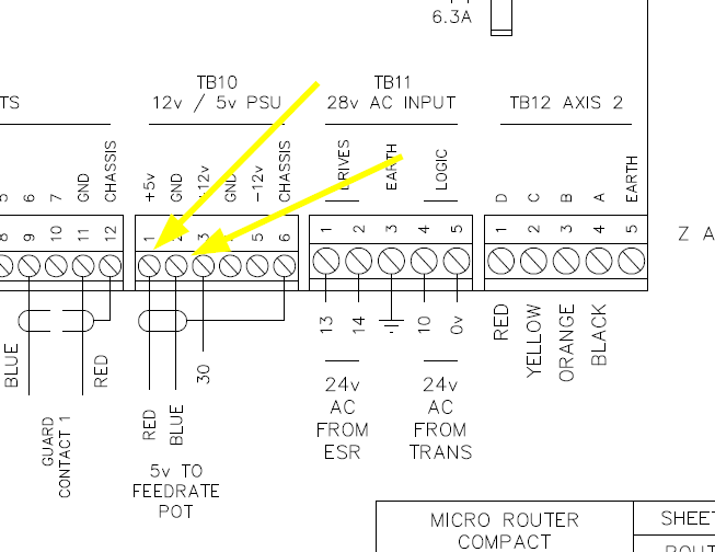

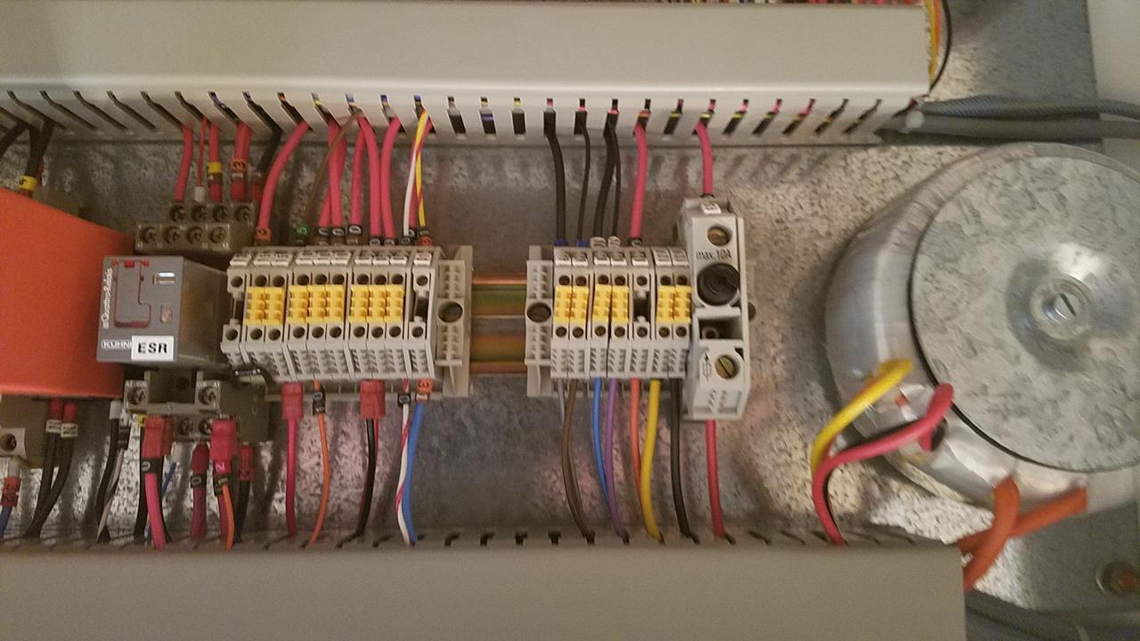

I noticed this.
On the TB10 block, The wires for the 5V Speed Pot are not where the drawing says they should be.
Please see the two pictures below. The snippet from the wiring diagram came from the diagrams linked here on the forum.
viewtopic.php?f=38&t=3024
On the TB11 block, the 24V AC wires for the ESR Relay are reversed on the board from the wiring diagram too. I am not sure if this matters or not.
Does yours match the drawing of the Cabinet?
I am not changing anything at the moment, just looking it over to understand the layout and where everything is while I figure out the software situation.
I really just need to borrow VR milling for an evening to be sure the machine works. If it does, I can just buy it.

looking at the section on the wiring. its not that the wire is in the wrong place, the blue wire has 30 tagged on it as per the diagram. it looks more like the gnd wire to the speed pot has not been fitted back to the board. it may well be that the gnd has been picked up off another point. it would be worth looking at the pot itself to confirm this.
you have the rs232 version so you will need with an rs232 port, for the wiring of the lead

You know, I was thinking the same thing after the fact. Out of curiosity I checked the voltage at the pot itself and I have the 5V. I will call that good then.TDIPower wrote:looking at the section on the wiring. its not that the wire is in the wrong place, the blue wire has 30 tagged on it as per the diagram. it looks more like the gnd wire to the speed pot has not been fitted back to the board. it may well be that the gnd has been picked up off another point. it would be worth looking at the pot itself to confirm this.

I would have "expected" the door to be unlocked upon powering up, but it was locked. So I have a little study to do there.
I still do not know what the number 2 means on the LED display.
Other than those two things, I think I am ready to connect it to a PC. There must be a seat of VR Milling V2.XX out there in need of a home after a machine was scrapped or converted to Mach or something else. (Reading on the forums suggests that it would be a major performance boost to convert to mach with a more modern board but I would really like to know for the peace of mind if the hardware will run the way it is.)
Thanks again for the help so far.
Kevin
I followed the PDF from this thread
viewtopic.php?f=54&t=2351&hilit=machine+Link
The PDF: download/file.php?id=1263
I even went back and double checked the pinouts for continuity afterward. (That surely is the kiss of death)
I have a laptop with a serial port. (I will start with that before going to USB to serial adapters)
Next, I will go back and study the circuits for the E-Stop relay and door interlock and spindle. Even though I did the bypass for the door interlock so I could get inside, I am not sure why I needed to.
Kevin

- Posts: 613
Re the no 2 on the display, did you not take a look at this link? stuff/NextStepLEDSWEB.htm
depending on when No2 is on the display it can mean 1 of 3 things. Given yours is on the display whilst powered up it looks to me that it is normal.
It all looks good to me.
As Pete says we quite often pick commons up from different point.
You can connect to the NextStep card using Denford EasyUpgrader which will allow you to check the firmware & update it if required. https://www.denfordata.com/downloads/eas ... 1-9-cd.zip
As long as the LED is lit it should be fine.
