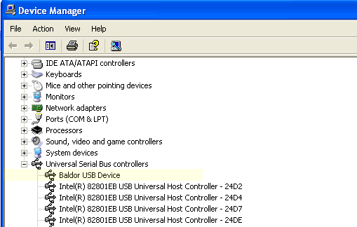

The Baldor USB driver has not been loaded correctly - check in windows Device Manager under USB devices (see atached picture) - if there is a problem, the USB drivers can be found on the original VR Milling CD under the \USB folder

- The Baldor controller listed under USB devices (XP/2000 only)
- baldor-usb-device.gif (9.71 KiB) Viewed 6781 times
