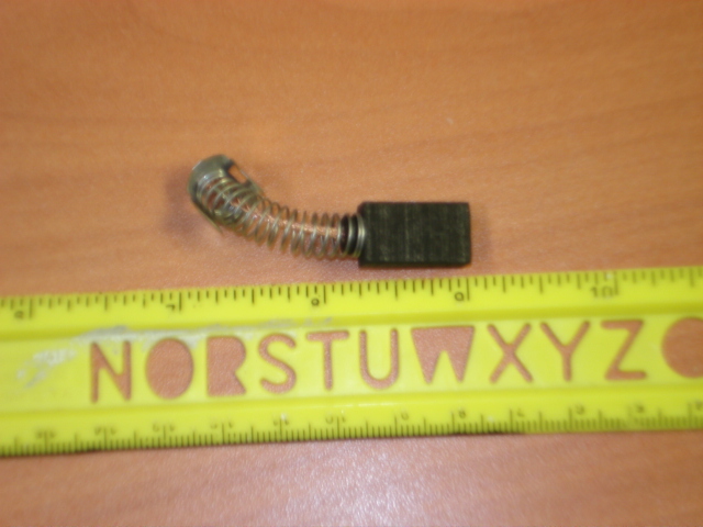

Post by boots » Thu 23 Apr , 2009 20:21 pm
Here is a photo of a new motor brush
