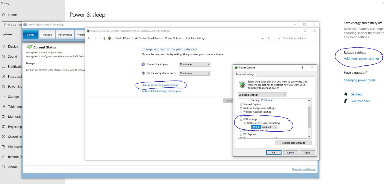

Re: Earth Clamp Mod
Have you checked the power saving settings on your PC? Make sure the USB port does not shut down in power saving mode

Re: Earth Clamp Mod
Hi Steve,
Thanks for the reply. On your advice, I changed the settings and ran another program and the same thing happened.
One obervation is that, after the machine stops, the PC no longer recognises it at all. I can't reconnect without rebooting. This surely measn it's not a "move buffer full" comms issue but, more likely a Timeout issue. Some parameter is cutting the connection between CNC & PC altogether. This is why your suggestion was so promising but, alas, no dice.

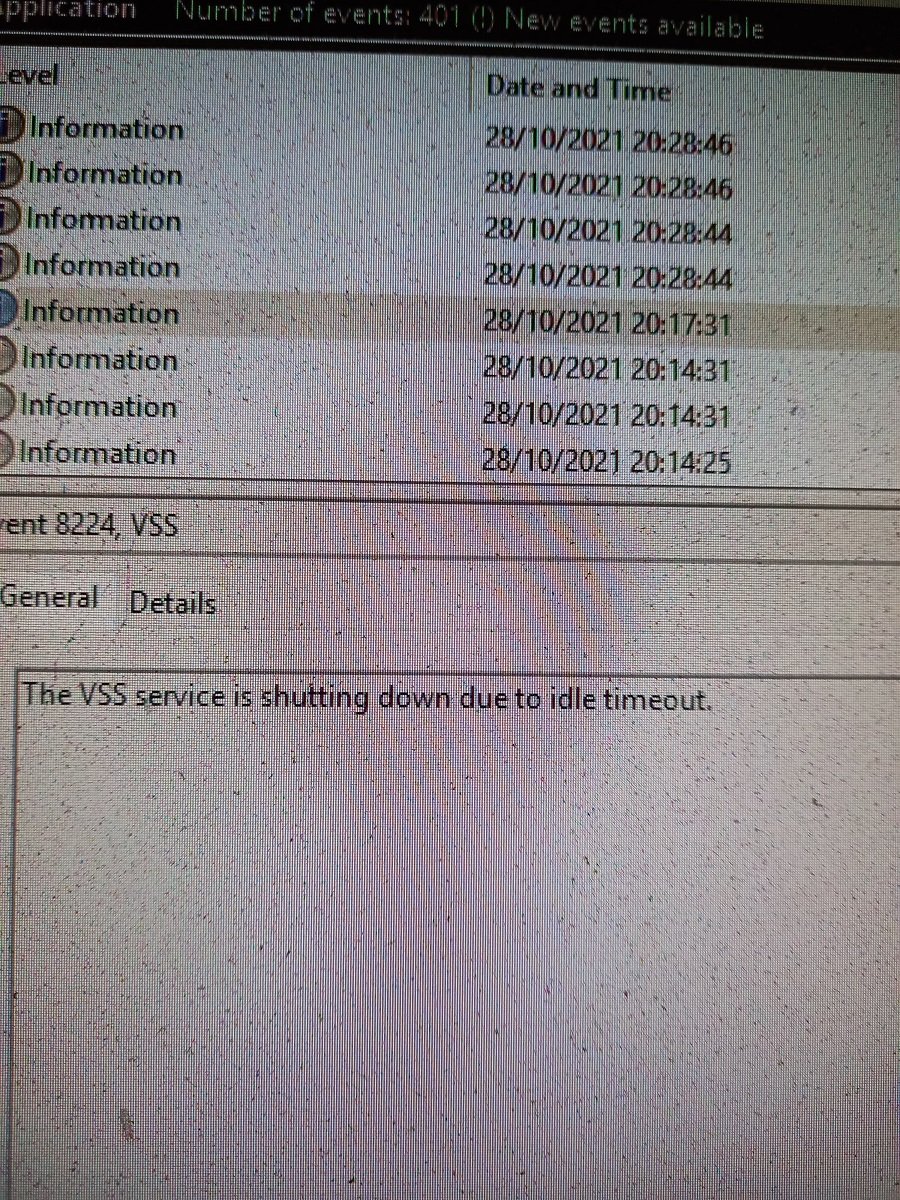

Re: Earth Clamp Mod
Have you looked in the Windows event logs to see if anything has been logged by the system?
- Posts: 25
- Joined: Fri 29 Aug , 2014 10:57 am
- Hardware/Software: MicroRouter Compact (SN:H04459/1)
USB (VRMilling V5)
Fujitsu PC (Win 10, 64bit)
AND...
2600 Router
USB (VRMilling V5)
Zoostorm PC (Win 10, 64bit)
Re: Earth Clamp Mod

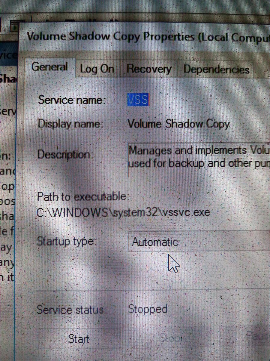

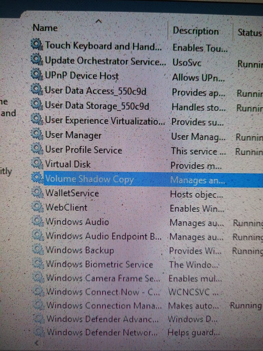

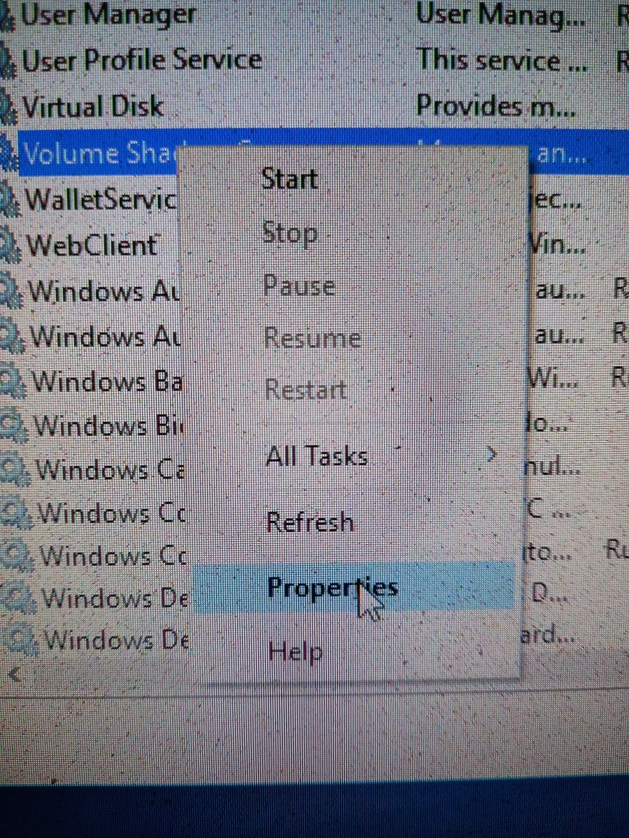

David, I did as you suggested and found "VSS Service is shuttting down due to idle timeout".
After Googling VSS Service, I found that the "Volumn Shadow Copy" settings were coming up on a lot of CNC boards.
I went to the Services window and found "Volumn Show Copy", hit Properties and set Start-up Type to Automatic from Manual and...
IT WORKED!!! It ran whole whole 140k g-code without missing a beat. I will try it again to make sure it wasn't a fluke but, as of now, problem solved.
Thanks again, David. Brilliant.
